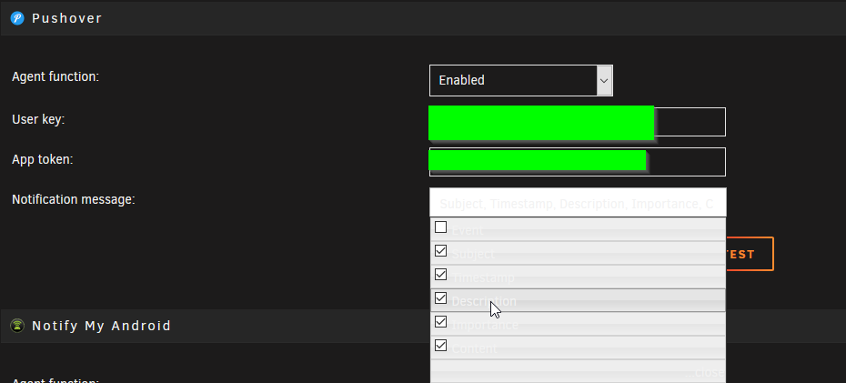

6.5.3 to 6.6.0 went smoothly. The new theme will take a bit to get used to. I do agree with a comment earlier that it seems to take up quite a bit of vertical space.
Only one real issue I noticed:
1218957493_2018-09-2019_20_53-NAS_Notifications.png.262c5d90f10c970177bb58524cf10328.png
That white on white is a bit tough to read. Maybe just go with the same dark grey as is behind the User Key entry box. I didn't check any of the other notification agent setups, but I'd imagine they're all using the same configuration info.
