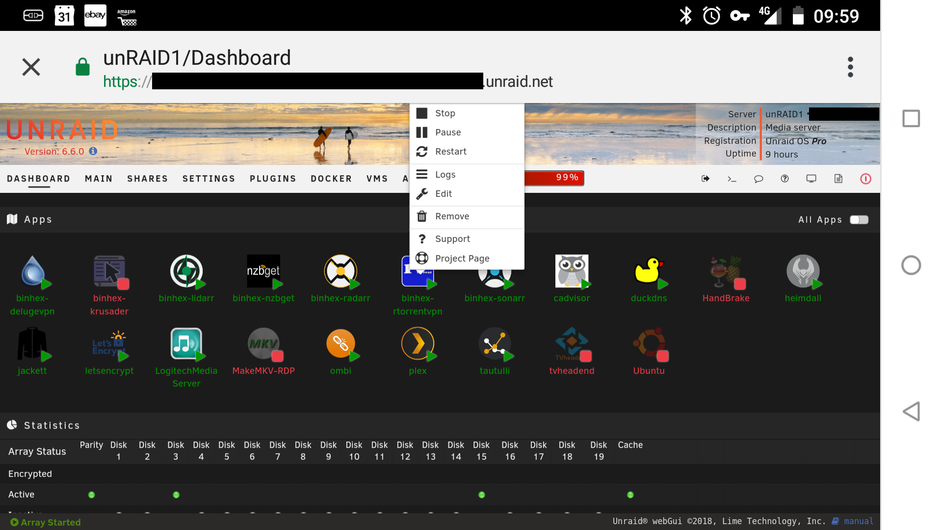

The GUI is great - seems much snappier.  Well done guys. I've two questions...
1. Is there a way to revert to the default banner?  I'd customised mine, and want it back.  Guessing clicking the defaults button would do it once I've jotted down the current settings.
2. Is there a way to turn off the sticky/fixed header (and footer)?  Or at least only have the menu bar stick?  I sometimes need to access my system from mobiles or small screen laptops and things like dashboard menus on docker/VMs are displaying under the header (and off the top of the view).  Vertical space gets a bit restricted with things permanently on display.
I'll provide some screen grabs later if needed.
Cheers

2. Cheers.  Just VPN'd on to get the attached screenshot - i'd made a mistake in that the menu is over the top of the header, but I'd previously been able to scroll up higher to force the menu to drop below.  Can't do that anymore.  I tend to work in landscape and have a Nexus 5X.  Not ideal, but sometimes it's the only option.  If the menu could go beside the icon if it crashes the viewport, it would solve it (I know I've done similar in jQuery, but not sure what you're working with).
As a side note, is it possible to make the title text below each docker/VM also bring up the menu?
Glad to hear you're working on mobile - that would be a huge  benefit (and undertaking - I'm currently porting my webapp sites to a Bootstrap structure for this reason).
We use the third party jquery script "context" to generate the menu. This script calculates the position of the menu. AFAIK there is no newer version which performs a different positional calculation.
