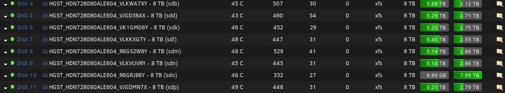

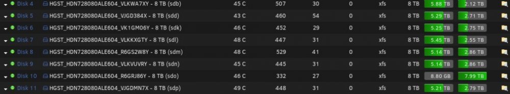

Replaced a drive and the "Unused" column isn't displaying correctly in Main.  See attached image, specifically Disk 10
What do you think it should be showing?    It seems to be showing a drive that is basically empty.   If you replaced the drive did you at any point select the ‘Format’ option - if so that would explain the disk being empty.
The drive is empty, freshly formatted.  The "Used" should say "0 GB" and not "8.80 GB".  Sorry for the typo, in OP I said "Unused".

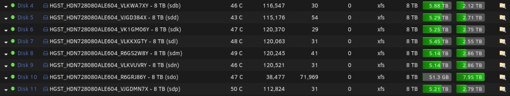

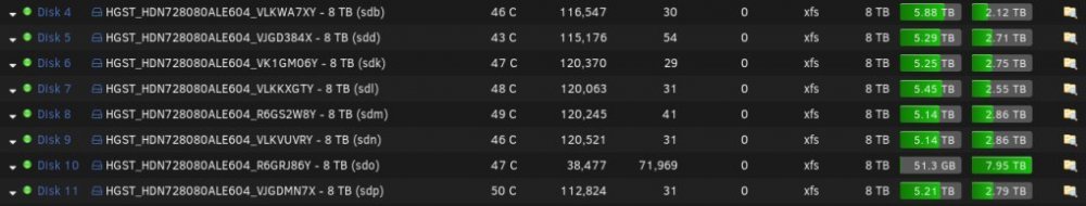

Moving files back onto this new drive and the "Used" calc is definitely wrong.

The "used" space includes space taken by the file system (XFS). An "empty" 8 TB disk uses already 8 ~ 9 GB of file system space, which is what you see.
And the 51.3 GB used on the 8 GB drive pictured above?
Files are copied to the disk.
51.3GB copied to an 8GB?
Your disk is not 8 GB but 8 TB (1000 times bigger)
Incorrect. Filesystem has overhead.
Yep. Sorry absolute brain fart. Next time I'll sleep before doing any system updates and upgrades.
