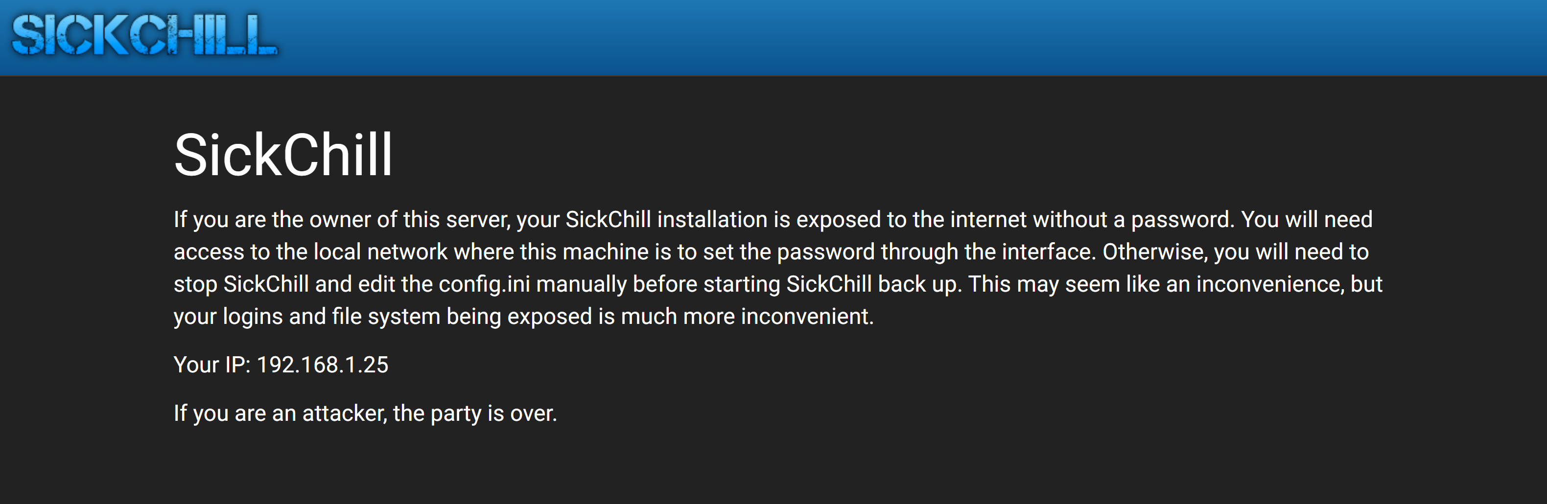

Seems this one has lost both TVDB and IMDB connection...Anybody know what has happened?
Suddenly this morning Sickchill is blocked!
Hers is the message appearing on screen.
What should I do? I tried the ini file in cache but I don't know how to proceed.
you either need to set a password for the web ui or stop port forwarding for this container on your router.
Hello. I wish I could set a password. I just don't have access to the GUI yet.
And the port used by Sickchill is 8081 and is not forwarded in my router.
What other option do I have?
Forget it! An update solved the problem apparently.
Edited by xtrips
