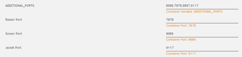

I'm trying to route my (binhex) Jacket, Sonarr, Radarr containers through the binhex-qbitorrentvpn docker after encountering problems connecting Sonarr and Radarr to Jacket after the latest update.
I'm still having problems connecting to the webUIs. They just don't load. Followed the FAQ. 25 and 26, although I'm still having questions about that. Watched Spaceinvader One's video guide, although that one doesn't seem complete atm.
I included screenshots of my settings from the Jackett and qBittorrent dockers.
Jackett:
qBittorrent:
It all seems to run fine?
To get back to the FAQ, Under A25 step 4 it says: "Remove any 'Host Ports' defined." But that does not seem right?
I had to create the ADDITIONAL_PORTS variable in the binhex-qBittorrentvpn docker also. As you can see above I think I got that right.
Not sure what I'm doing wrong here. Must be a silly thing I hope.

In your jackett screenshot there is a port for 9117, delete it, then try accessing the web UI again, using ≤host IP≥:9117
Sent from my iPlay_40 using Tapatalk
Thanks for the fast response! Okay, removed the port in the Jacket settings and I'm trying to connect to http://192.168.0.202:9117/, but it still doesn't load. :( "This site can’t be reached"
what is the value for env var LAN_NETWORK for qbittorrentvpn?
The value is currently set at: 192.168.0.0/24. This used to be fine. I tried to change it to: 192.168.0.202/24, but this didn't work either.
that looks fine, what about the browser, have you by accident set it to use a proxy?
No, I don't use a proxy with Chrome. Tried Brave, Edge. All do not connect.
ok can you attach your jackett config file, its located at /config/Jackett/ServerConfig.json
I removed the values in ProxyUsername and ProxyPassword, but the rest of the file I left alone.
ServerConfig.json
ServerConfig.json 613 B · 0 downloads
ok you shouldn't be using a socks/http proxy as it can cause issues when using a vpn tunnel, set the option in the file as follows:-
  "ProxyType": -1,
save the change and restart jackett container.
another question too, do you have vlan's in place?, also check firewall for lan blocking.
  "ProxyType": -1,
Made the change in the .json. Still not able to connect.
I don't use a vlan and checked both the firewall in windows and the router, both look fine.
sorry then im currently out of suggestions, all i can say is this does work, i currently have jackett routed through privoxyvpn and i can access the web ui of jackett and sonarr can communicate with jackett, there must be something else blocking, but i dont know what.
edit - one last stab in the dark, go to the 'console' of qbittorrentvpn and issue the command 'ip route' and paste it here.
Okay, thanks for your time anyway. Appreciate it. But it is a problem I want to fix. If anyone else has suggestions ... please share.
0.0.0.0/1 via 10.8.3.1 dev tun0
default via 172.17.0.1 dev eth0
10.8.3.0/24 dev tun0 proto kernel scope link src 10.8.3.16
128.0.0.0/1 via 10.8.3.1 dev tun0
172.17.0.0/16 dev eth0 proto kernel scope link src 172.17.0.2
192.168.1.0/24 via 172.17.0.1 dev eth0
213.232.87.81 via 172.17.0.1 dev eth0
Hopefully this will help.
In the mean time I tried with binhex-PrivoxyVPN and trying to route it through there. Same result as with binhex-qBittorrentVPN
Hello
I cant make this container work, when it´s bridged?? it works when im not using vpn.. but when it´s enabled it wont??
It´s running but im not able to access it??
regards
sadly it doesnt, that all looks correct so the issue is not routing, im out of ideas for now.
Got the WebUI loading working. Supposedly I needed to:
  • add the extra parameter "--net=container:binhex-qbittorrentvpn" (did that)
  • delete my ports on the routed containers (I did, on your suggestion)
  • add them to the qbittorrent container "additional ports" line (I created that and so I did)
  • AND re-create the port in the qbittorent container (and here I failed, idiot like I am)
Seems I looked over that part. I swear I did create them, but I must have deleted those ports at one point after I didn't get it to work at first.
I now have the issue of not being able to connect to my indexers from Jackett and connecting to qBittorrent in Radarr and Sonarr, but at least I'm one step closer of solving the problems.
Many thanks for your support and sorry for wasting your precious time.
