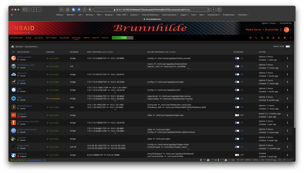

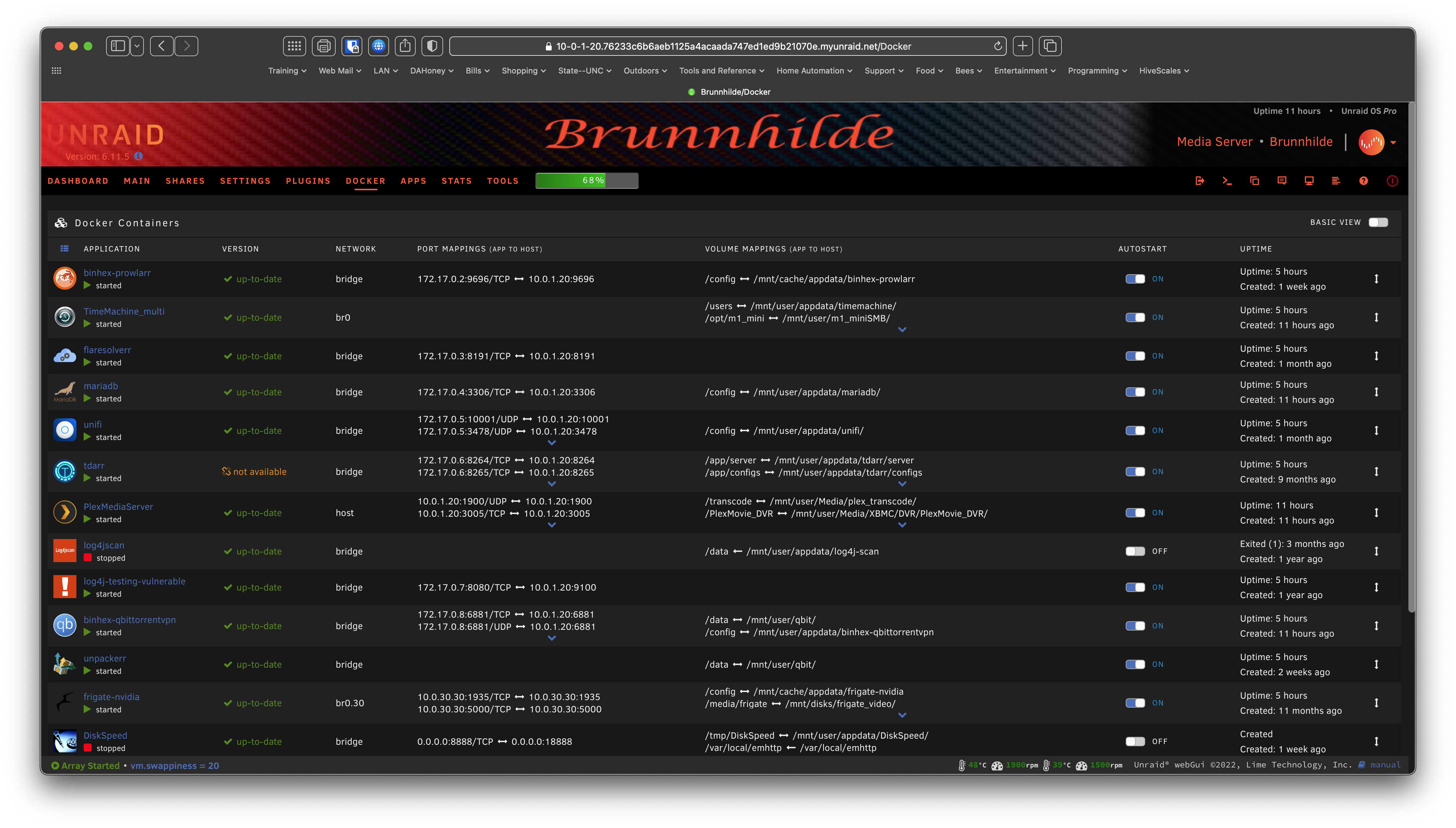

For some reason my TDARR docker is showing version “Not Available”.
627646298_Screenshot2023-02-15at8_11_24AM.thumb.png.d923e13115e1a6dd6f9a83df7141c4d9.png
From what I'm googling this is a build problem but I notice that no one else is posting about this.
Found the docker patch plugin and installed it from CA. Problem solved.
6 hours ago, Civic1201 said:
For the "issue" docker not available try this:
Here's a one-liner from the above thread that fixes the docker update issue. It does the same thing as manually editing the file. Just ssh to your box / use the Web terminal and paste the command.
sed -i "s#distribution.manifest.v2+json'#distribution.manifest.v2+json,application/vnd.oci.image.index.v1+json'#" /usr/local/emhttp/plugins/dynamix.docker.manager/include/DockerClient.php
This will not persist when you reboot Unraid. The real fix will be in the in the next Unraid release.
Or install the docker patch plugin from the apps tab.

Tdarr dockers (server) is pulling about 30% from the CPU when having a GPU doing the transcoding. Giving the docker only 4 cores, they are constant 100%. I double checked my setting again @SpaceInvaderOne tutorial several times.
Is this as expected?
Happy for any comments.
