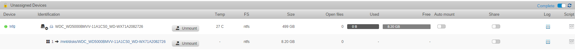

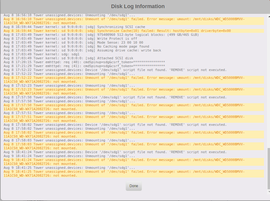

Hi all, i am having an issue with unassigned devices.
system:
-Unraid v 6.5.3
-Unassigned devices v 2018.06.01a
i have a WD 500gb usb external hard drive that i have plugged into my server to copy files into my array.  when i plug the usb into windows i can see the files through file explorer no problem, however when i plug the usb into the server, unassigned devices (and dolphin) show nothing on the disk.  i have formated the usb twice and tried test files, still nothing shows.  I forgot to mention that when i plug the usb into the server it auto mounts, and i cannot unmount the device.  i hope you folks can help, i am a newb so bare with me a little bit!
system:
-Unraid v 6.5.3
Turn off the USB auto mount: Set "Settings->Unassigned Devices->Auto Mount USB Devices?" to "No".
Reboot your server and try again.  If it persists, post your diagnostics.
