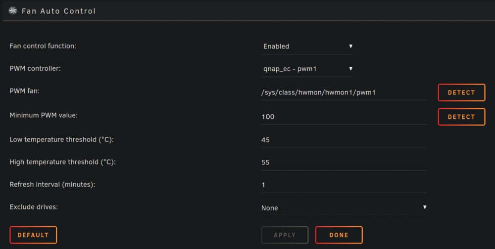

Hello. I have Qnap TS-253be with installed Unraid 6.10.3 and with plugins: Nerd Pack, QNAP-EC, Dynamix system temp and autofan. When I try to detect a fan in Dynamix system fan, I get the message like this:
<br /><b>Warning</b>:  file_get_contents(/sys/devices/platform/qnap-ec/hwmon/hwmon2/pwm1_enable): failed to open stream: No such file or directory in <b>/usr/local/emhttp/plugins/dynamix.system.autofan/include/SystemFan.php</b> on line <b>40</b><br /><br /><b>Warning</b>:  file_put_contents(/sys/devices/platform/qnap-ec/hwmon/hwmon2/pwm1_enable): failed to open stream: Permission denied in <b>/usr/local/emhttp/plugins/dynamix.system.autofan/include/SystemFan.php</b> on line <b>42</b><br /><br /><b>Warning</b>:  file_put_contents(/sys/devices/platform/qnap-ec/hwmon/hwmon2/pwm1_enable): failed to open stream: Permission denied in <b>/usr/local/emhttp/plugins/dynamix.system.autofan/include/SystemFan.php</b> on line <b>50</b><br />/sys/devices/platform/qnap-ec/hwmon/hwmon2/fan1_input
If I change the parameters in autofan, the fan starts to work at full speed and don't change it. Please help me, how can I adjust the fan speed? Thanks.
Edited by Spring
@Trunkton can you help here a bit?
@Spring I think you have to do something like this:
echo 0 > /sys/class/hwmon/hwmon2/pwm1
echo 120 > /sys/class/hwmon/hwmon2/pwm1
echo 255 > /sys/class/hwmon/hwmon2/pwm1
If you issue one from the 3 commands from a terminal the fans should change speeds (0 is the lowest speed and 255 is max speed).
Of course you can vary the values to your likings and from what I know Autofan doesn‘t support the QNAP fans.
Don‘t know exactly if the device paths like specified above match yours.

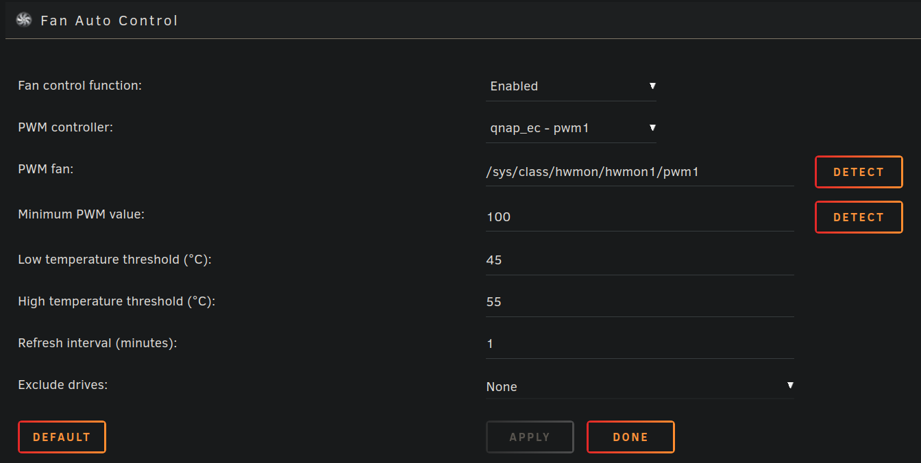

Thanks. I changed the settings as in the screenshot and it seems to have helped. Now when the temperature changes, the fan speed changes. I want to test it yet.

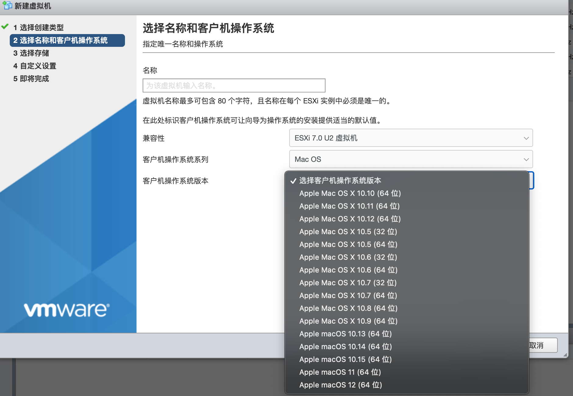

But does "esxi" support MacOS? Their virtual machine module has the apple system. I think "unraid" can also do it. It does not rely on docker to install MacOS anymore!
Edited by song
4 minutes ago, song said:
But does "esxi" support MacOS? Their virtual machine module has the apple system. I think that unread can also do it. It does not rely on docker to install MacOS anymore!
For Unraid It's not a technical issue, it's a legal issue. Until apple says they allow it, it won't happen.
It appears esxi is the same way. Please read this webpage, and then tell me esxi supports macos.
https://tcude.net/creating-a-macos-vm-in-esxi/
As you may or may not know, by default, ESXi will not let you run macOS virtual machines. This has to do with Apple's TOS requiring that macOS VMs only be run on Mac hardware. Fortunately, some very talented people over at InsanelyMac have created an "unlocker" to allow you to run macOS VMs on your ESXi host, regardless of whether it's Apple hardware or not.
You are running ESXi on Mac hardware or am I wrong?
If you run ESXi on Mac hardware you can deploy VMs because the Apple EULA only says that you are not allowed  to run OSX on non Apple hardware but if you run ESXi on non Apple hardware you can‘t run OSX and they also don‘t give you the option to do so from what I know.
