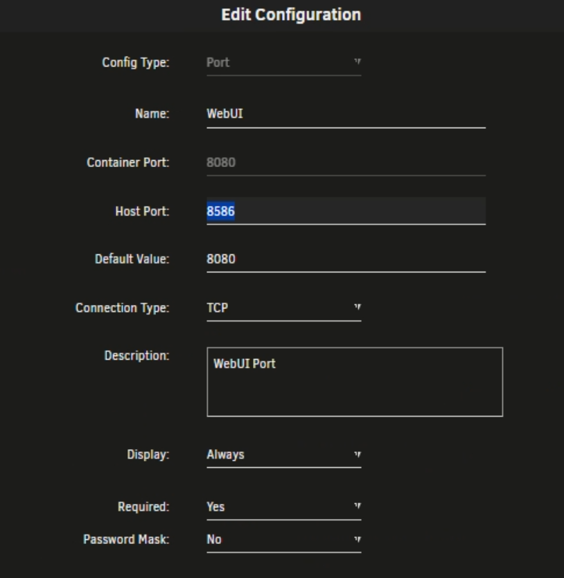

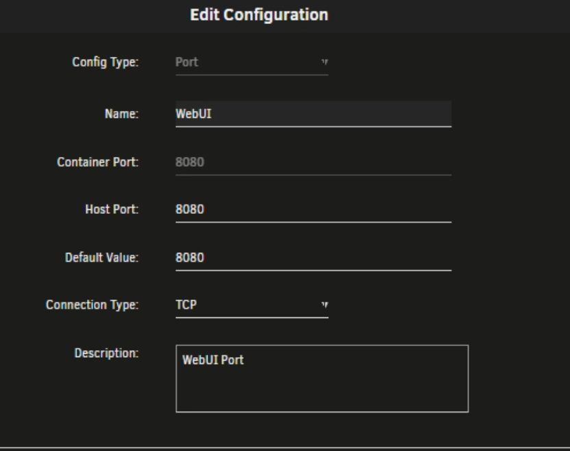

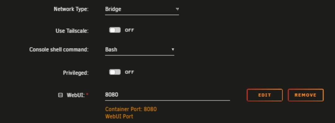

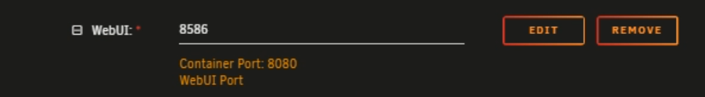

??? ... You should be deleting temaptel variables... Please review Some Docker networking Info when to use what docker network As the ports are ignored if using br0 and setting the interface ports to different ports is only usable and available for docker nat to change ports. You have to change the even for immich in side the docker container (My understating is that is not possible with image genious docker image. a env / premade server config is made for us. Immage genious server config / env set immich web UI to port 8080 If you use a docker network that is not docker bridge the unraid teampte of docker port map and nat contorel are ignored and not used. Note that these are the ENV docker varables that composes could use to change and edit poprts... While untested. In theory once could try passing immich ENV https://immich.app/docs/install/environment-variables/ Unraid CA immage genious users default port 8080 I will not test this(PAssing compose docker env) and can only recommend you look more into docker networks. IMMICH_PORT Listening port 2283 (server), 3003 (machine learning)
