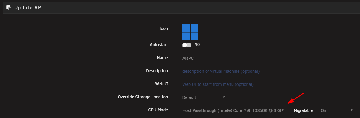

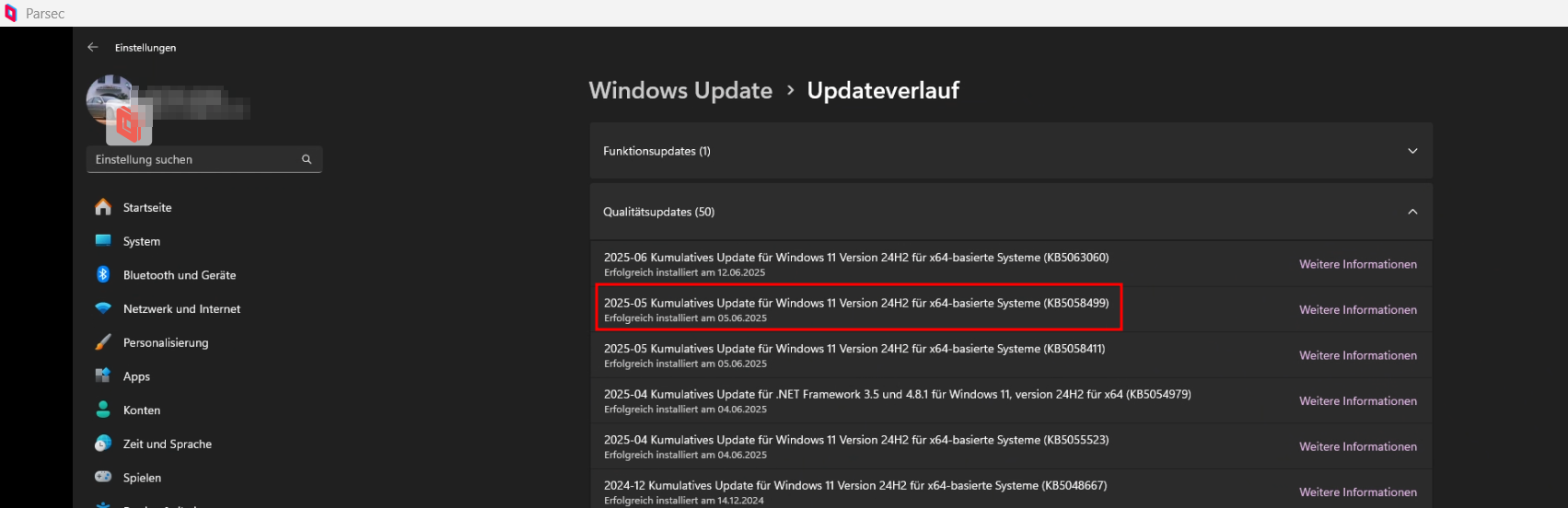

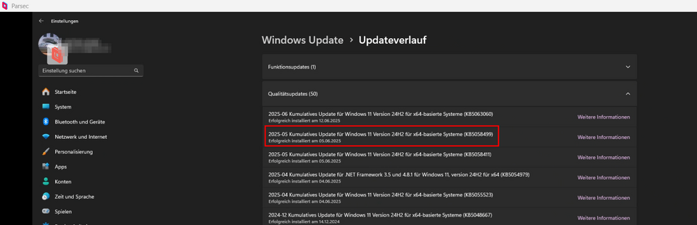

Windows 11: Recent Update (KB5058499) Disabled VM! Processor Unsupported
thought so, but i cant confirm here its fine without this ... actually cant imagine what impact this should have. before with an 3080to, now with a 5080 ... im almost on bare metal level ... and no stuttering or so ...
no issues here but hyper-v is custom here <hyperv mode='custom'> <relaxed state='on'/> <vapic state='on'/> <spinlocks state='on' retries='8191'/> <vpindex state='on'/> <synic state='on'/> <stimer state='on'/> <vendor_id state='on' value='none'/> </hyperv>
