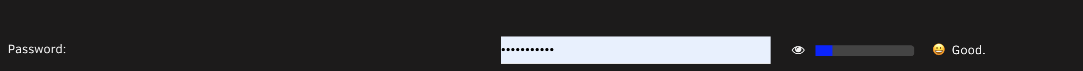

Late to the party on this one. Just installed but don't see any way to access. According to the plugin code I would expect it to be on the Tools page but not there. And it doesn't seem to be mentioned in its "Support thread".
Does it only show up on the Users page when you set a password or what?
Yes. This is where the little strength bar shows up.
