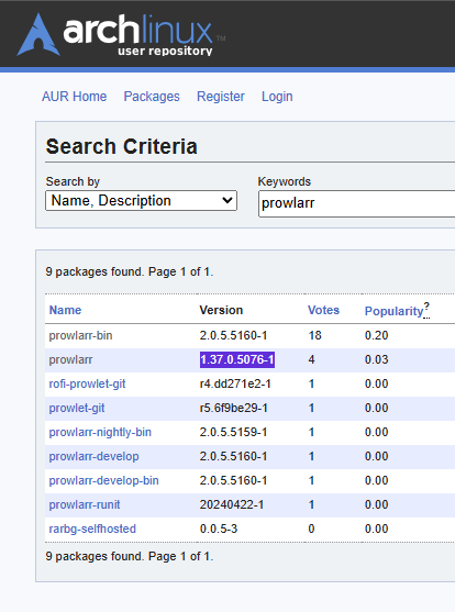

  • Not really. Pretty sure it’s all automated though. Once the arch build is released the docker image will grab it.
