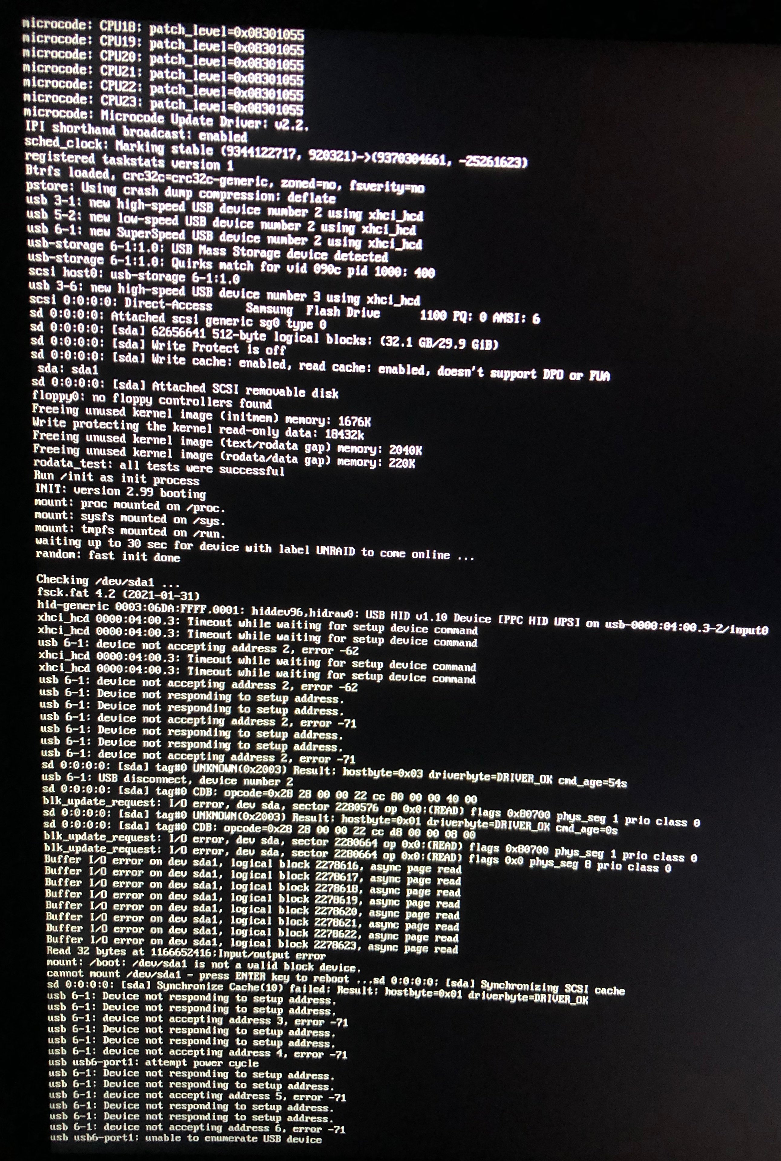

i got this error when its try to reboot after download the new update (dell r710 gen 1)

got this after updat - picture attaced
Lenovo thinkstation P620

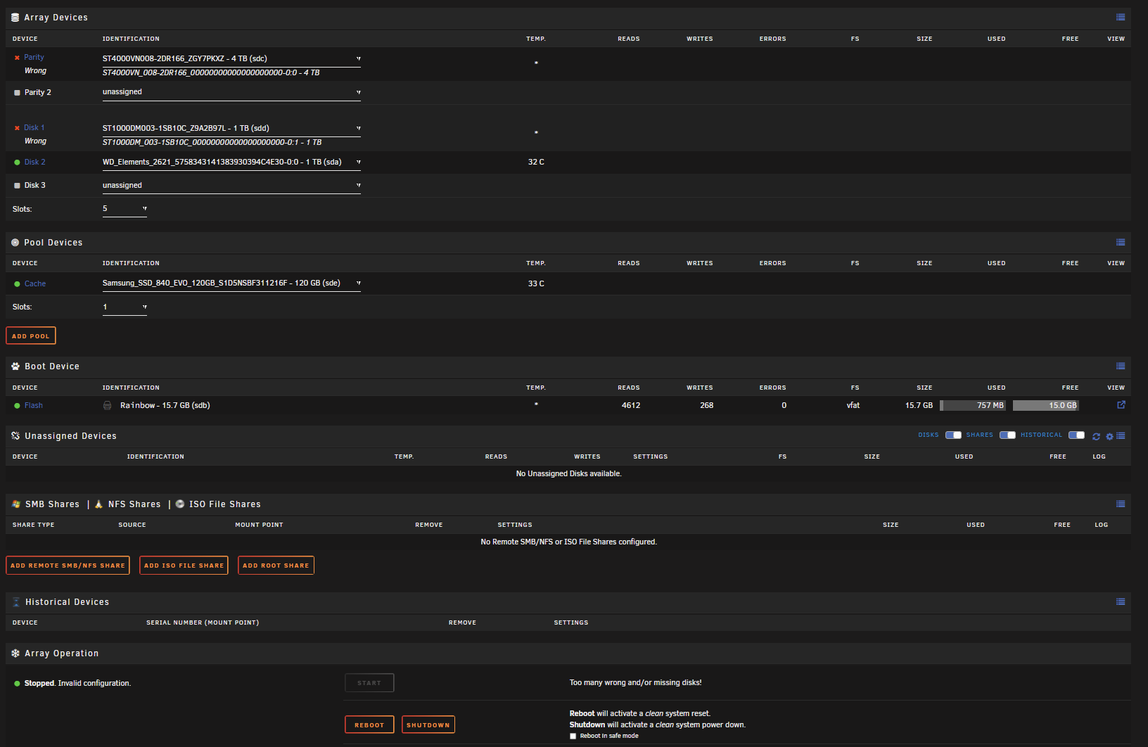

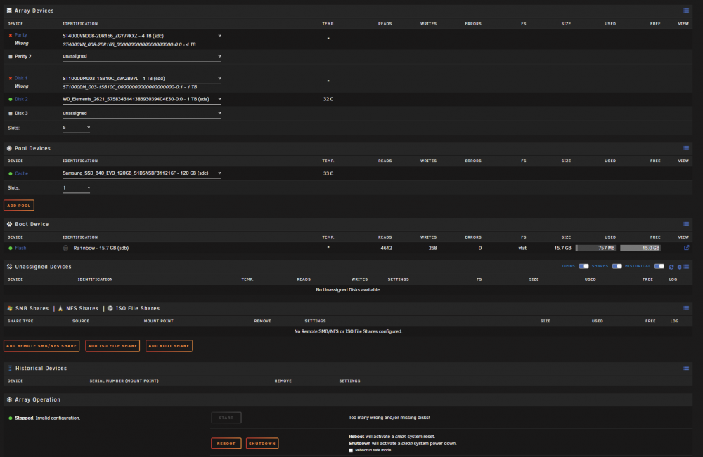

I use an USB enclosure for two of my disks. Both devices now got new IDs. If I remove them from the assignment the old device IDs don't appear under "historical devices" and I can't delete the old IDs. Any idea how I can replace the old IDs with the new ones and startup the array without rebuilding the cluster config?
See here:
Those disks are not unassigned disks.  You are using them as array disks.  It is not recommended to use usb disks for array disks.    I do not know how to fix your situation.  Hopefully someone can chime in here and help you.
You can do a new config (-Tools -> New Config -> Retain current configuration: All -> Apply), check all assignments are correct, check "parity is already valid" next to array start button and start the array, assuming only the devices name changed, and with USB there's always some risks of other issues, it will be bring the array back.
i get the same error upgrading a dell r710
