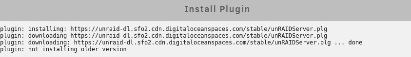

I am running 6.92.2 on 2 servers and neither have advised that an update is available. If I try and update manually I keep getting this message
Try going to   Tools   >>>   About   >>>  Update OS   and try from there.
Moved both servers from 6.10.0 to 6.10.1 this morning, no issues previously, and no issues with latest upgrade.
I have tried that but the new version of Unraid is not listed?
