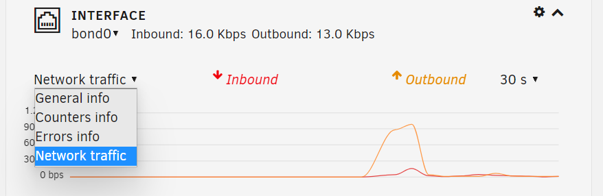

4 hours ago, dlandon said:
Thats really cool.
FR - an API so I can display that on my start page and the same cool looking graph for my GPU use.
