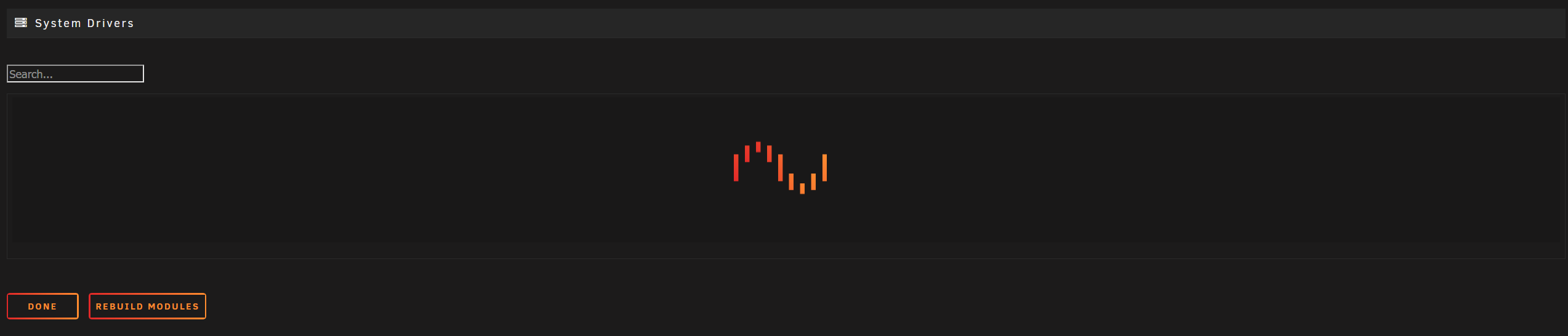

Nothing huge but on both servers if I try to access "System Drivers" under tools it won't open, I reverted to 6.12.8 & it opens without an issue. Now back again to 6.12.9 on both of my servers & it gets stuck on loading.
I clicked on it by mistake while trying to open system devices & I do not care if it works or not, just a note to fix for next update if is the same issue exists for other users.
Just read this and thought, huh, let me try. So i did.
I have the same result.
Thanks, we're looking into it
When i click on it, it sits on the Unraid wave and appears to be hung.
