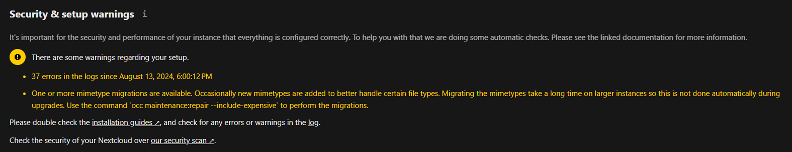

On 8/21/2024 at 1:11 PM, blaine07 said:
Did you try to perform this repair manually or are you just waiting? I was going to make the one little change but I don't even see the file/can't figure out where the "lib" folder is. -
in folder nextcloud
/lib/private/Repair/RepairMimeTypes.php
Did you fix this yourself per chance?
Sorry for the late reply- I was at work for two days and am bock home just now.
I tried to run 'occ maintenance:repair --include-expensive' as stated in:
One or more mimetype migrations are available. Occasionally new mimetypes are added to better handle certain file types. Migrating the mimetypes take a long time on larger instances so this is not done automatically during upgrades. Use the command `occ maintenance:repair --include-expensive` to perform the migrations.
I did not resolve the message though. After that, I stumbled upon the above link and (because I was away) did intentionally not mess with any files directly.
My resulting question is:
will the php file be adjusted in the next change and I can simply re-run the repair including expensive, or to I have to adjust the php file anyway?
Link to comment
