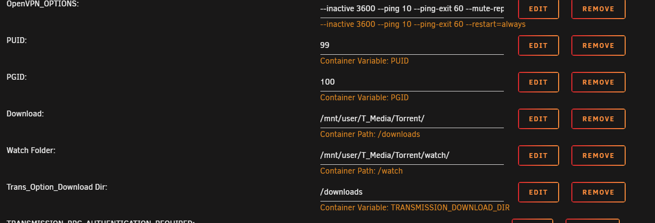

Hi all
Finally decided it was time for VPN and set up this wonderful docker. Everything is working flawlessly using PIA, except for some permissions weirdness. I'm not used to transmission taking control of all files and folders so forcefully.
As in, I can't even use my watch directory because of it.
Can anything be done to facilitate this? Medusa hasn't run yet, but I'm betting that stuff like unpacking will become problematic as well.
Edit:
I've fiddled about some more with UMASK mentioned on the previous page with no luck.
Here's what it's setting in the log for the docker:
Enforcing ownership on transmission config directories
Applying permissions to transmission config directories
Setting owner for transmission paths to 99:100
Setting permission for files (644) and directories (755)
Basically I want to be able to use my watch folder via SMB share and for stuff like Medusa to be able to move stuff around. Nothing too fancy.
I have it set up very neatly with a regular transmission container. Is there any reason that this particular instance has to play naughty with the permissions? Is it to do with privileged access mode? If I disable that, it won't run at all.

Hi man, thanks for responding.
Looking at the directory structures, I just realized that the data folder specified is the actual transmission application data. I'll move that now and check around for further settings. I was unaware that changes to settings.json would be persistent..
But it seems like the docker is setting the file permissions even before transmission is started, effectively making me unable to use the share from another workstation over SMB. If you look at the log while starting it up, you'll see the same behaviour I'm sure. Is it a byproduct of privileged access and thus not something that can be avoided?
I mean, it'll be a bit more to manage, but I figure I can work around it.. but it's been very insistent about not even loading anything I manually put in to the watch directory even after setting permissions manually too. It's a bit odd. Anyway, I'll test out some more on my end and see if I can learn something. Thanks again.
Okay, I did some cleanup and appdata folder is now moved to a cache drive instead. I've set the TRANSMISSION_UMASK setting at 000 and that does get replicated in the settings.json file. (Anything entered manually gets removed on restart..)
It still sets permissions to this when looking at the log during bootup;

CHanges to setting.json are not persistant, if you want them to be persistant you have to add them to your Docker template. using "TRANSMISSION_SETTING_TO_BE_PERSISTANT". theres some good information HERE on how / what to change.
Yes I figured as much, it doesn't change how the docker behaves when starting up though. It still sets restrictive permissions on the entire transmission directory. I haven't been able to figure out what is responsible for that.
you could try changing this:
#GLOBAL_APPLY_PERMISSIONS=true
looking through the usersetup.sh on git, this is where the permsissions are set:
    echo "Enforcing ownership on transmission config directories"
    chown -R ${RUN_AS}:${RUN_AS} \
        /config \
        ${TRANSMISSION_HOME}
    echo "Applying permissions to transmission config directories"
    chmod -R go=rX,u=rwX \
        /config \
    if [ "$GLOBAL_APPLY_PERMISSIONS" = true ] ; then
	echo "Setting owner for transmission paths to ${PUID}:${PGID}"
            ${TRANSMISSION_DOWNLOAD_DIR} \
            ${TRANSMISSION_INCOMPLETE_DIR} \
            ${TRANSMISSION_WATCH_DIR}
	echo "Setting permission for files (644) and directories (755)"
    fi
That did it.
Documentation for those that want it:
Permissions are now persistent. That's awesome.
Kind of want to suggest this become a part of the main image, but hey, at least there's an option to get it workin'.
Now to see if the watch directory will function. ;-)
Thanks man, made my life a whole lot easier.

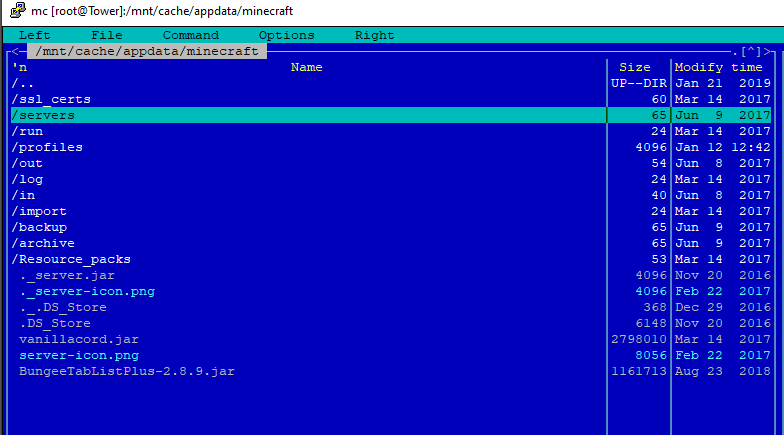

where do i find the profile.js file?
which docker?
20 hours ago, clowrym said:
which docker?
unraid docker. i cant find it for the life of me. i cant find the games folder is supposed to be in

Are you asking about Minecraft, or minecraftPE? neither of these are stock with unraid, they are all Docker containers you add
the normal java edition minecraft
Locations of the server files would be dependent on the folder mapping you have added to your docker, For me personally, My Server files are lcoations in /mnt/cache/appdata/minecraft/servers
If you have mapped your docker different then myself, they would be located based on your mapping

ok i got there but i cant seem to find the profile.js file to change the file so i can get to ftb profiles
for that you will have to go into the actual container (click on the mincraft docker and click console) from there you will find profiles.js at:
\usr\games\mincraft\
I could be wrong, but I dont believe changes here will survive a restart of the container though...
