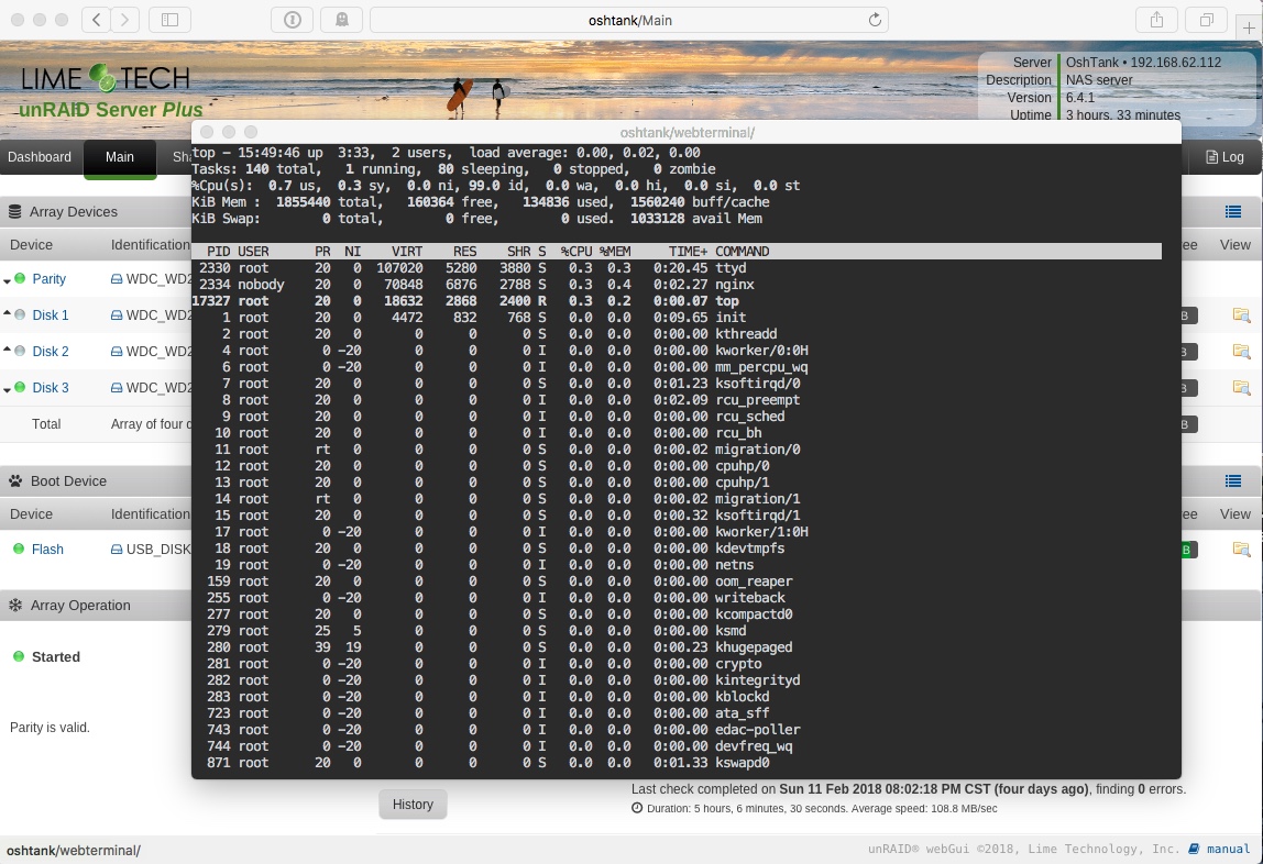

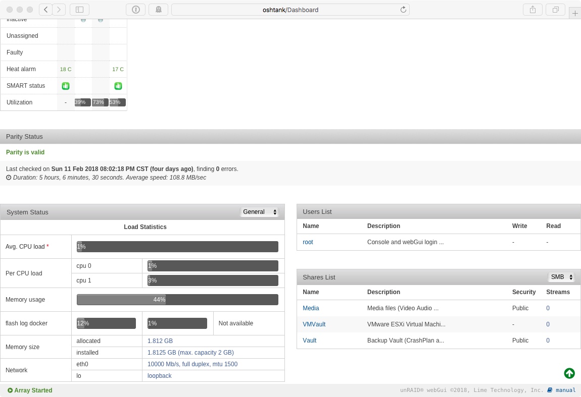

1 hour ago, wgstarks said:
Really. I’ll have to test mine again. All I got was a blank screen the last time I tested the terminal window.
Do your cpu loads also display correctly in the dashboard tab?
Yes -- both looked fine.  See attached.
  • Replies 158
  • Views 56.7k
I'm guessing you haven't set a root password?  Safari has issues with authenticated websockets, which means if you have a root password set you probably won't see the CPU load
Yeah. I just checked mine. Same version of Safari but no Terminal or cpu load (as expected).

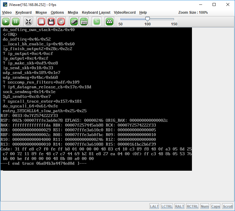

Call trace and completely locked up server (tried physically attaching too)
No ability to run commands, etc.
Latest version, HW in signature.
~6 days of uptime.
I thought this was a stable release ;) Hahaha
2 minutes ago, nexusmaniac said:
~6 days of uptime.
So are you saying that it ran that long before it locked up? If so, then you might give us your diagnostics after a reboot. Also, of course, you might try a memtest and SAFE mode.
Yes, 6 days of uptime. I went to work this morning trying to VPN back home for a moment but I've dropped in on lunch and found my server to be locked up with a call trace on screen :/
Memtest runs perfectly for 48hrs, I did a run after a 'spring clean' of my server a couple of weeks ago.
Safe mode has made no diff. in the past, I'm confident it's not a Container or Plugin causing the issue.
Diagnostic attached (after the reboot)
raptor-diagnostics-20180222-1330.zip
Server died at 06:18am today (22nd Feb)
If that's of any use.
This is based on the last pingtime recorded by SmokePing :)
