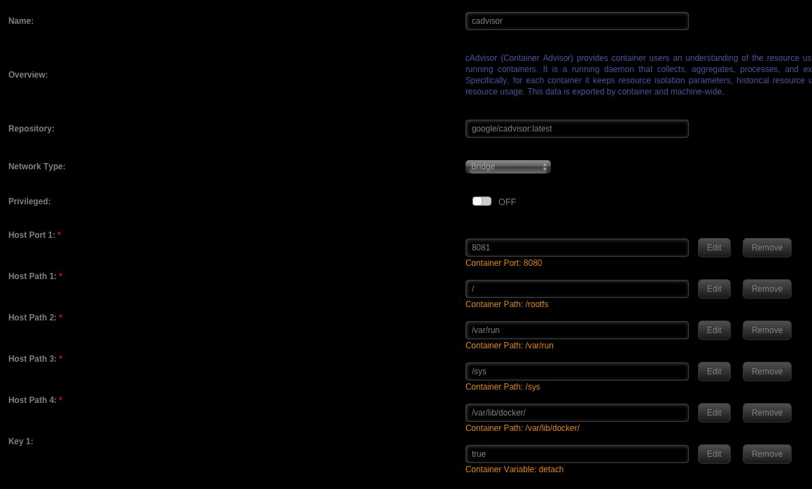

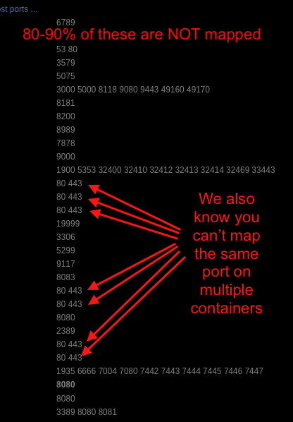

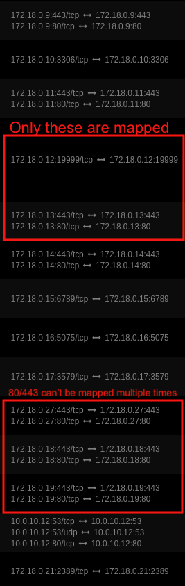

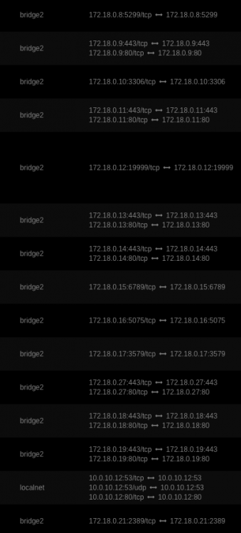

Not sure if I should post this here or post as an issue somewhere else? I've found what may be a bug in the display of the docker details. It seems the port mappings are for the most part incorrectly mapped. As in, the ports are actually NOT mapped to the host, but they are showing as mapped. I've tried re-building the container, but it still shows this way. I'm sharing screenshots here to show a list from the port maps screen, a sample from the main docker screen, and a view from the command line using `docker ps -a` to show the actual mapped ports. While it doesn't appear to be doing any real harm that I've found yet ... it is very difficult to understand what I'm viewing and see ports used for different containers.
Docker tab main view:
5aac35014e14d_ScreenShot2018-03-16at5_11_47PM.thumb.png.4098cac5817674eac9489f8041e7c694.png
Docker container Edit screen showing mapped host ports:
5aac350246035_ScreenShot2018-03-16at5_12_51PM.png.1586e1740f8f7d8668676677ca576f1e.png

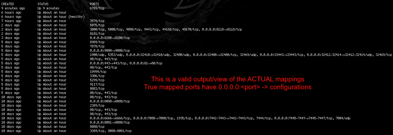

Command line view from terminal of docker ps -a output:
5aac350320325_ScreenShot2018-03-16at5_18_13PM.thumb.png.13026251106586cc6f701e24d6beb580.png
Of course you can map the ports multiple times if you use different IPs for all containers.
If all containers where using bridged network your statement would be true. But from the little we can see from the pictures you posted it looks like you have specified an IP per container.
Sorry I did not mention that, but these are all on Bridged network, so yes they are all attempting to run on the host IP. Either way, you can see from the command line, that they are not mapped. The docker service is clearly showing something different than the unRAID interface. I can tell you for a fact that unRAID is the one with incorrect information being shown in the interface. The command line docker service is correct.
Edit: Adding network in view of first screen image for further validation
5aac388dce535_ScreenShot2018-03-16at5_34_57PM.thumb.png.449896fa79207409c3d4ebb05311aa4a.png
Edited by 1activegeek
Well the docker command is used to get the port bindings, like this:
docker inspect --format='{{range $p,$c := .HostConfig.PortBindings}}{{$p}}:{{(index $c 0).HostPort}}|{{end}}' <container>
Perhaps something gets confused because of your "bridge2" declaration.
Can you try the above command on one of your 'suspect' containers?
Edited by bonienl
Bridge was not really the correct choice of word from me.
You have set every container to their own IP. It shows that in your screenshot. Then it's not using the host IP.
Running this command shows nothing for containers that are not mapping their ports, as expected. Tried a container that IS mapping ports, and it shows properly.
I think we're really digging into semantics that are not of importance. These have their own IP, because they are on the bridge. By default, docker will assign each container it's own IP. That has no bearing on MAPPING of ports. If I'm mapping a port on my host (which is what the mapped host ports sections shows) then I am trying to tie 443 for example on my HOST IP to 443 in my CONTAINER IP. So I don't think talking about the IP of containers is important here as they SHOULD have an IP. What I would expect to see differently with the IP info though, is that I should see something like 172.18.0.12:443 -> 10.0.10.22:443 for a port that is ACTUALLY mapped per the container config to the HOST. But I don't see this either.

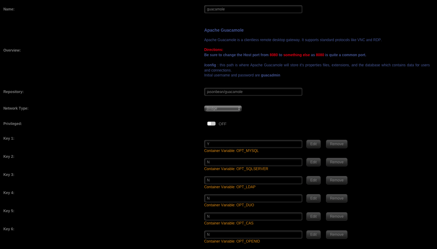

Some more details of 2 containers in particular one mapped, one not.
Guacamole here IS NOT mapped to the host, is part of the bridge network and SHOULD get a 172.18.x.x IP. You can see the details screen has no Port mapping.
5aac3e39cfb0b_ScreenShot2018-03-16at5_52_45PM.thumb.png.e3f551248d72892f53c0ffe607339ece.png5aac3e3f0c687_ScreenShot2018-03-16at5_53_04PM.thumb.png.094b5b63f1fee59aff39565d3be669fb.png
cAdvisor here IS MAPPED to a host port of 8080 as can be seen in the settings/config as well, but it does also still have it's own IP as expected
5aac3e8ac839b_ScreenShot2018-03-16at6_00_05PM.png.768c0497b076c9af997af6bd213e2db6.png5aac3e8fb5532_ScreenShot2018-03-16at6_00_16PM.thumb.png.df8ea92356b69b6274a5c98aab804bf6.png
Ok, I found the reason.
The display list uses the outout of the command I have given earlier when the type of network is set to "bridge". For any other type it assumes host or macvlan mode and looks for exposed ports.
In your case the other network is "bridge2" which should be treated as "bridge", but it isn't.
That happens when "user defined" networks are used (you have bridge2 and localnet and perhaps more?) :/
I made a update to address "user defined" networks.
Thanks for reporting.
Edited by bonienl

Ok, but the "type" would equal the driver no?
username@unraid:~$ docker network ls
NETWORK ID          NAME                DRIVER              SCOPE
e862a38c5fe1        bridge              bridge              local
075df9b08ac4        bridge2             bridge              local
0dfca2d1d148        host                host                local
a09a118a7922        localnet            macvlan             local
d5e104f60e1b        none                null                local
So why wouldn't it see bridge2 as a bridge?
And the backstory to explain WHY I'm using this customer bridge - is for DNS name resolution of containers. Using link and other mentions of containers in descriptors is said to be deprecated, so I don't want to use deprecated mechanisms to connect my containers. I run about 30 containers. 24 or so, are run though nginx to expose their services. Using the non-default bridge, has DNS naming of containers enabled. So I can resolve the name of guacamole, cadvisor, etc from the nginx container. Traffic then no longer needs to flow out the docker network then back in through the host networking. It removes extra hops in transmission, removes an issue with macvlan connectivity on the SAME port, and reduces attack footprint on the system. So I'm EXTREMELY hesitant to move back to having to use the default bridge network - unless someone knows a way to enable dns name resolution! (I've not found a way)
No need, I made a update to correct the display issue with user defined networks.
