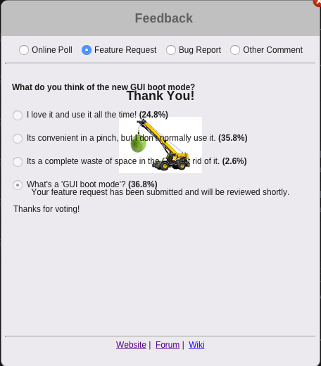

I submitted a feature request via the web gui (for multiple cache pools, surprise surprise) and this is what it showed after I submitted it. Nothing major, but just thought I'd share!
5aa91e6514414_ScreenShot2018-03-14at9_04_03AM.png.d3189ca9780feec44c9ecbe38964ff91.png
