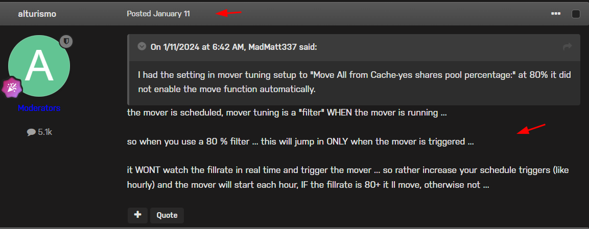

I noticed today for the first time that I had one of my cache drives fill up before my nightly move, and although I had the setting in mover tuning setup to "Move All from Cache-yes shares pool percentage:" at 80% it did not enable the move function automatically. Is there a current glitch with this? Maybe since the change of the cache setup since they no longer use the terms cache-yes as such?
Link to comment
the mover is scheduled, mover tuning is a "filter" WHEN the mover is running ...
so when you use a 80 % filter ... this will jump in ONLY when the mover is triggered ...
it WONT watch the fillrate in real time and trigger the mover ... so rather increase your schedule triggers (like hourly) and the mover will start each hour, IF the fillrate is 80+ it ll move, otherwise not ...

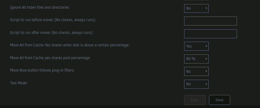

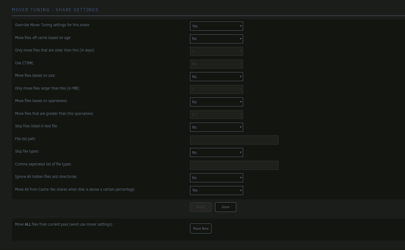

Somehow it seems to me, that moving when the cache is full isn't working.
  • I've got a share with the "Move All from Cache-Yes shares when disk is above a certain percentage" yes.
  • Two caches (Naming Cache and Datacache), where for this share the Datacache (~120GB) is used
  • I'm downloading ~100 files with ~2GB each, files are beeing pre generated (~1KB) and then after this filled with data. -> Mover isn't being activated when Datacache is 80% full.
I'm not sure if I set up something wrong or if this usecase isn't covered by mover tuning.
[EDIT] since it sounded similar, cache.cfg and datacache.cfg exist, I'm not sure if it is case sensitive, because the filename is lowercase, but the first letter of the Cache Name in the UI is uppercase.
Mover Tuning - Share settings:
Mover Tuning Settings:
Edited by Autchirion
the mover is running scheduled ... so the trigger is ONLY time based ...
WHEN its triggered it ll follow the rules
so, did you set the schedule and waited for it to run (supposed behaviour) ?
or did you expect the mover kicks in automatically while reaching the fill rate (wont happen) ?
Link to comment
2 minutes ago, Autchirion said:
yes, I expected this, damn it. 🙂
then may read a littl ebackwards or overall how it works.
sample (same page ... here)
so yes, you where not alone ... but may also read the manual again ;)
in my case, i just inreased the scheduler to run hourly ... as i control all by mover tuning.
