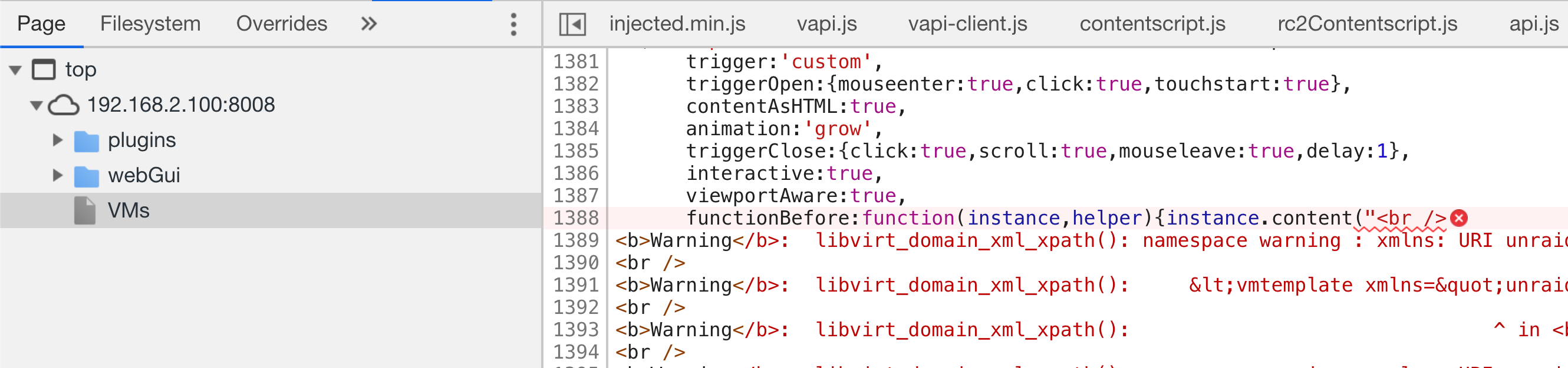

Upgrade seems to have gone OK, however there is something wrong with the VMS tab. My auto-start VMs start up just fine, no errors in the system log or libvirt log as far as I can tell. The VMs tab just shows the loading animation and never actually loads.
In the browser console log I do see this:
"Uncaught SyntaxError: Invalid or unexpected token"
I also see that the request for /sub/var is pending with a 101 status code.
Any ideas?
Do any of the VMs have any special characters in their names?  EG: apostrophies / quotes etc
Nope, I only have 1 VM called "windows10pro"
Screenshot of where the error shows for reference:
Edited by johnsanc
