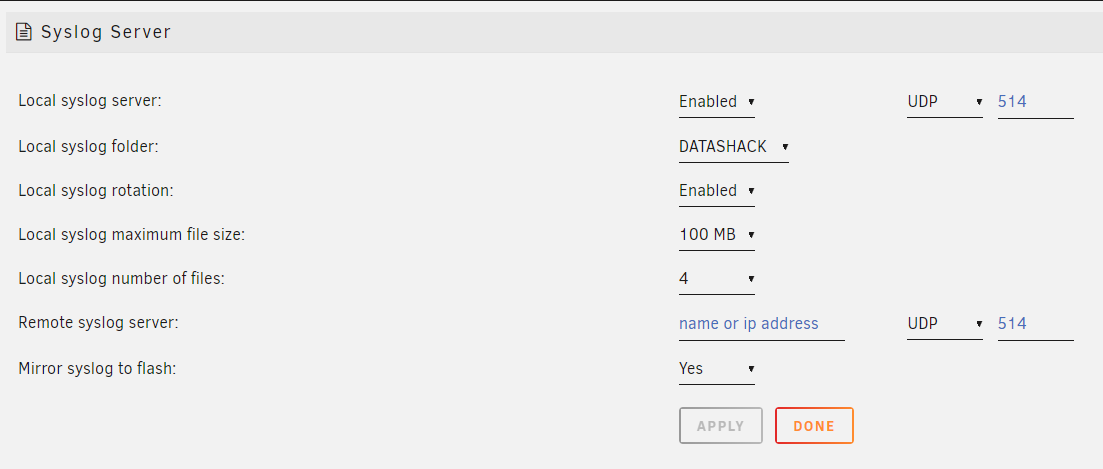

Upgraded from 6.6.7 to 6.7 no probs. A big thank you. I was having issues with my unRAID these past 2 months (under another post) and wanted to turn on Fixed Common Problems' Troubleshooting mode. After the upgrade, this new message appeared: LOOKING FOR TROUBLESHOOTING MODE? On unRaid 6.7+ it has been removed, and you should instead configure the built-in syslog server to save to the flash drive via Settings - Syslog Server.
I have set this up as shown. I can't see any logs appearing in the the 'local syslog folder'. I don't have a 'Remote syslog server'. Can you please confirm my settings? Your advice is, as usual, much appreciated. Regards. cL
