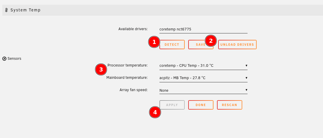

My NAS reports ITE IT8613E Super IO Sensors when I run sensors-detect.
I installed this plugin, then Dynamix temp plugin, I run detect, nothing.
I restarted, noted that now my Dashboard has a "FANS" area with my fans speeds, but the temperature info for CPU/MB are empty, and running Dynamic detector finds nothing still, even tho the fans part shows it8613
How is this supposed to be used??
Edited by ffleps
I assume you are referring to the IT87 plugin.
It is as easy as installing the plugin, go to the FAN plugin, click Detect, click Apply, select the sensors and that's it.
If anything is not working please post a screenshot or the output from `sensors` from a Unraid Terminal.
However it might be possible if some temperature sensors are not showing up that your chip is not fully compatible or not fully supported.
My Detect doesn't detect anything, even after installing the plugin and restarting, and also running sensors-detect.
This is what I see when I run sensors:
