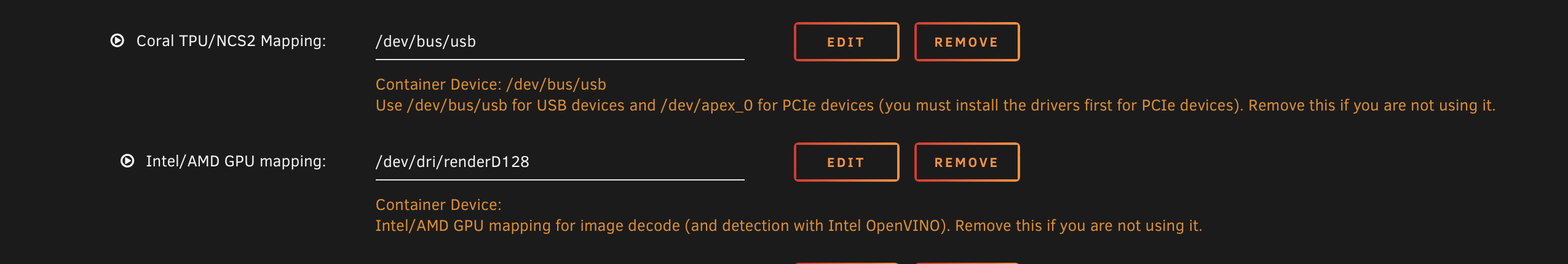

[SUPPORT] blakeblackshear - Frigate
You have to install the drivers for the PCIe version I believe. For the template, you can see if it was saved under /boot/config/plugins/dockerman/user-templates

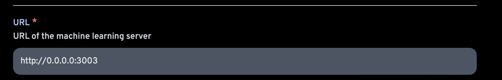

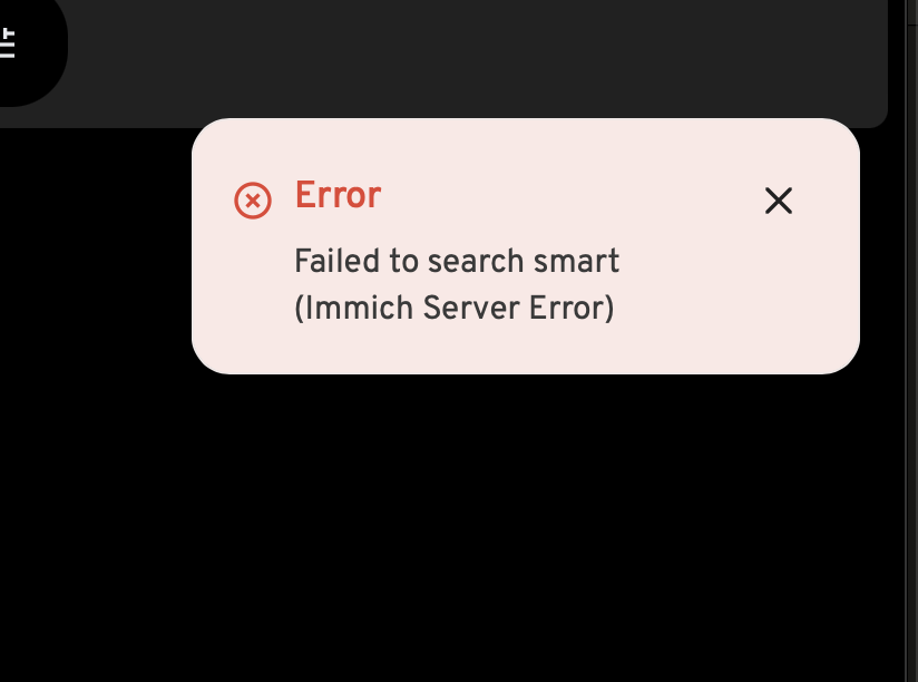

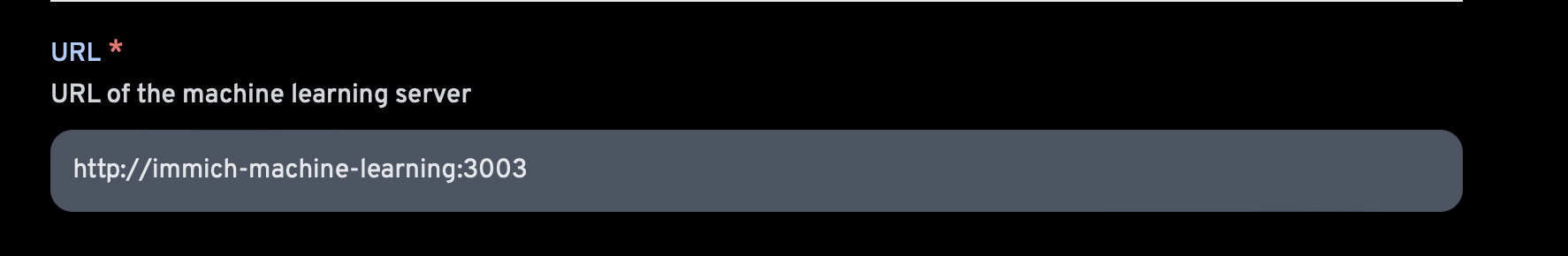

Immich docker self-hosted google photos setup
Quick update, setting to 0.0.0.0:3003 seems to have made it work for some reason: One more thing, even with openvino, my smart search isn't working. Is there way to turn off remote machine learning? I've set the IP to my machine, but it doesn't look like the ML server is running as part of the immich docker. I just want it to not even try to use the remote machine. [Nest] 731 - 07/12/2024, 12:50:19 PM ERROR [Api:Error: Machine learning request to "http://immich-machine-learning:3003" failed with Error: getaddrinfo ENOTFOUND immich-machine-learning at /app/immich/server/dist/repositories/machine-learning.repository.js:19:19 at process.processTicksAndRejections (node:internal/process/task_queues:95:5) at async MachineLearningRepository.predict (/app/immich/server/dist/repositories/machine-learning.repository.js:18:21) at async MachineLearningRepository.encodeText (/app/immich/server/dist/repositories/machine-learning.repository.js:47:26) at async SearchService.searchSmart (/app/immich/server/dist/services/search.service.js:97:27)~ob0ej2m8] Error: Machine learning request to "http://immich-machine-learning:3003" failed with Error: getaddrinfo ENOTFOUND immich-machine-learning
