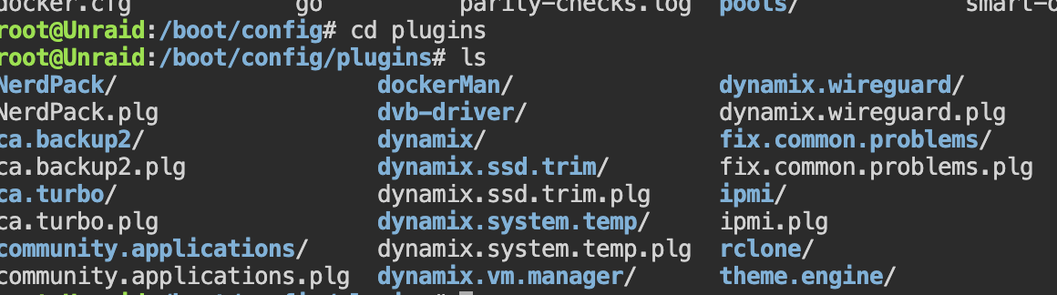

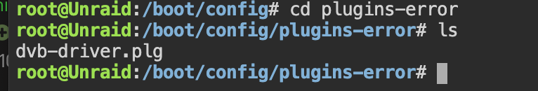

Edit: added installation screenshot There is no /boot/config/plugins/dvb-driver.plg Inside dvb-driver are the following files and folder: dvb-driver-2020.11.17.txz packages/ settings.cfg yes this could be. i use pihole. I disabled it and tried again with the same error. Please forget it. It was just an idea, maybe somethings wrong here...

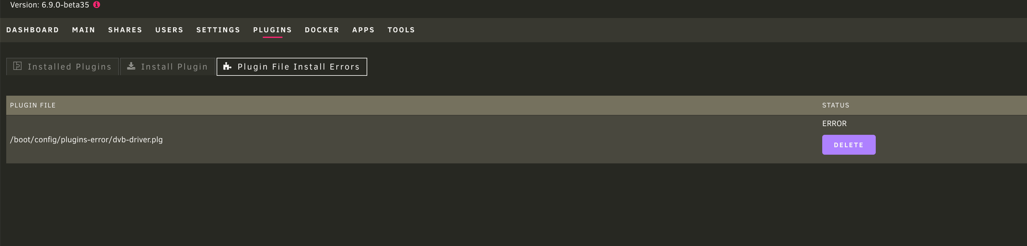

i guess i already did these steps. I did them again: I deleted: /boot/config/plugins/dvb-driver /boot/config/plugins-error/dvb-driver.plg Then reboot & installed the plugin. Before reboot: unraid-diagnostics-20201207-1321.zip After reboot: unraid-diagnostics-20201207-1325.zip The plugin is still under install error. I guess i deleted everything. Whats preventing from installation? Edit: Could it be a modules problem? /lib/modules/5.8.18-Unraid 🤯 unraid-diagnostics-20201207-1325.zip unraid-diagnostics-20201207-1321.zip

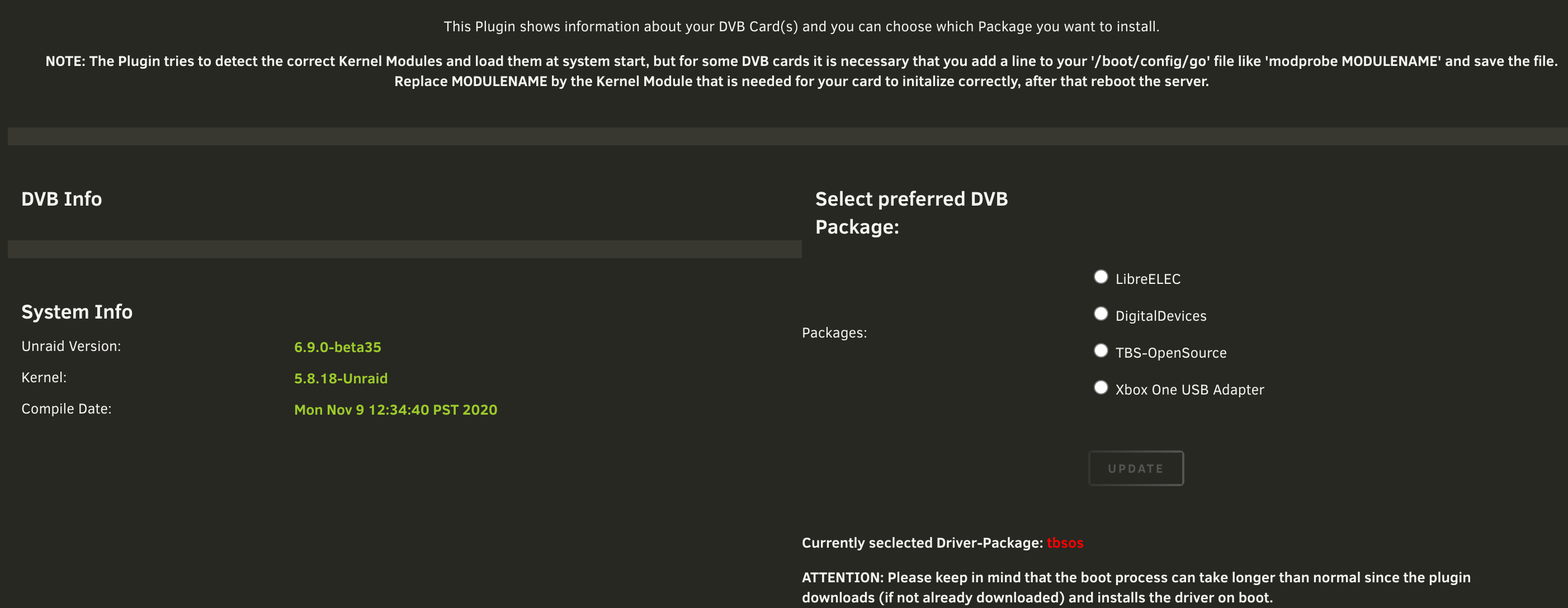

Good Morning, thanks for your help. - tower-diagnostics-20201207-0846.zip. This is a fresh usb stick with DVB Driver Plugin. /dev/dvb works and the plugin has no error. - unraid-diagnostics-20201207-0853.zip. This is normal, productive unraid with the plugin problem. The folder /boot/config/plugins/dvb-driver was still available. I deleted this folder and made a reboot and reinstall. Without success. Same issue. tower-diagnostics-20201207-0846.zip unraid-diagnostics-20201207-0853.zip

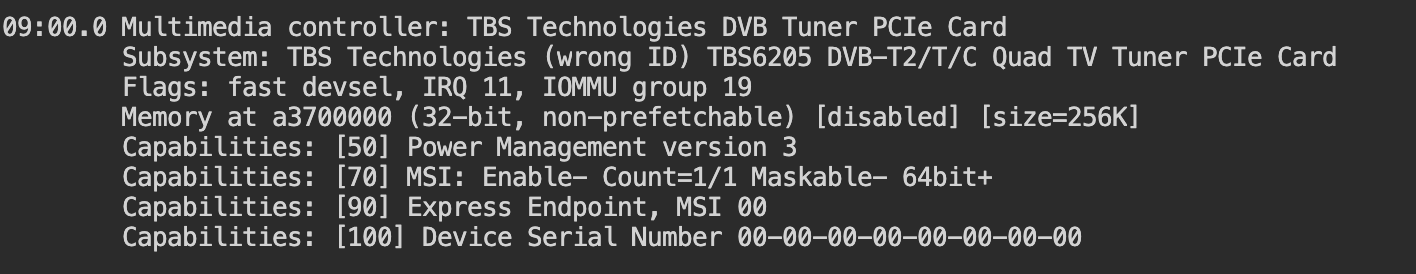

Hello, I have a TBS 6205 Card and the driver isn't working. The plugin installation failes after reboot and the installed plugin disappears. I selected the TBS or Libreelec driver. Same issue. I tested unraid with a clean, fresh usb stick and trial key and it worked. Something must be wrong with my configuration.... I hope you can help my, Thanks!!!
