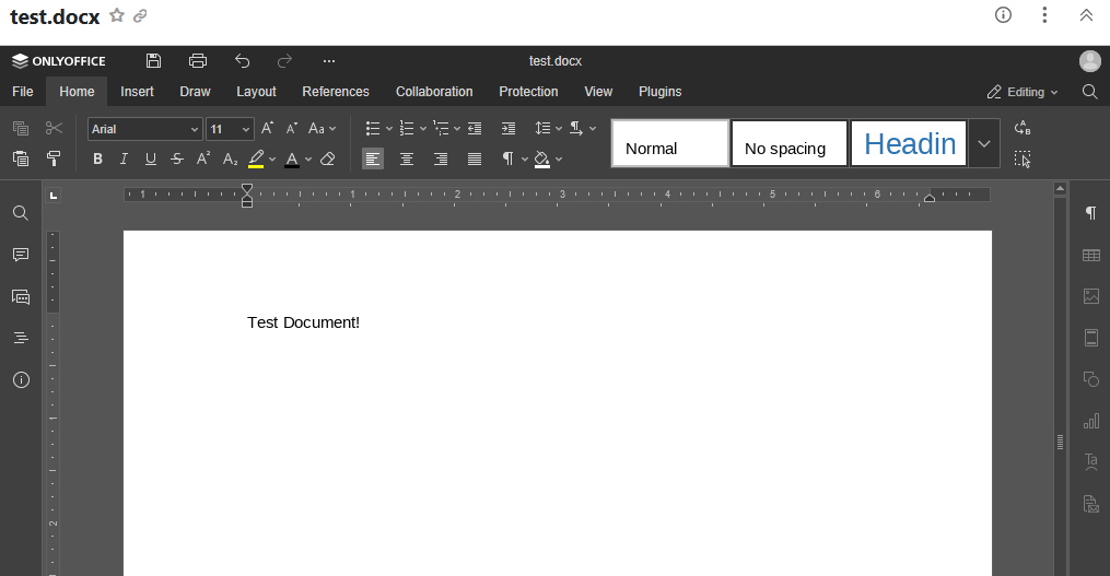

@tomkenobi @presence06 Step 1. Install OnlyOfficeDocumentServer docker. Step 2. Have a reverse proxy setup and add a proxy host/config for only office. Step 3. Edit seahub_settings.py and add the following and replace "onlyoffice.example.com" with your reverse proxy url. The JWT secret key has to match the key you created for the onlyoffice docker. ENABLE_ONLYOFFICE = True VERIFY_ONLYOFFICE_CERTIFICATE = False ONLYOFFICE_APIJS_URL = 'https://onlyoffice.example.com/web-apps/apps/api/documents/api.js' ONLYOFFICE_FILE_EXTENSION = ('doc', 'docx', 'ppt', 'pptx', 'xls', 'xlsx', 'odt', 'fodt', 'odp', 'fodp', 'ods', 'fods') ONLYOFFICE_EDIT_FILE_EXTENSION = ('docx', 'pptx', 'xlsx') ONLYOFFICE_FORCE_SAVE = True ONLYOFFICE_JWT_SECRET = 'your-onlyoffice-jwt-key-here' Step 4. Restart Seafile.
