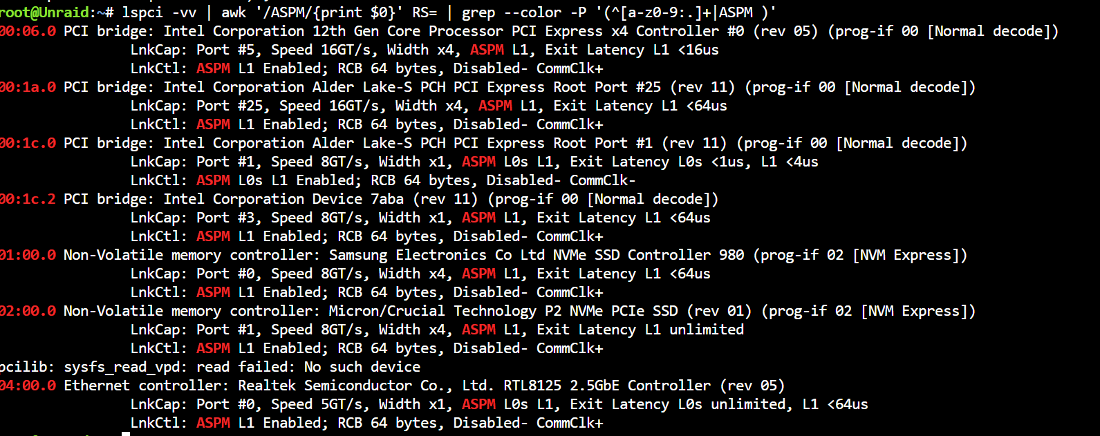

Habe mir nun die Sache angesehen bezüglich den amd_driver zu laden.
Der wird nun auch geladen jedoch sind meine ASPM States schlechter als vorher und mehr disabled. Kann das Sein?
Aktuell mit driver: amd-pstat
00:02.1 PCI bridge: Advanced Micro Devices, Inc. [AMD] Renoir/Cezanne PCIe GPP Bridge (prog-if 00 [Normal decode])
                LnkCap: Port #2, Speed 8GT/s, Width x4, ASPM L1, Exit Latency L1 <32us
                LnkCtl: ASPM Disabled; RCB 64 bytes, Disabled- CommClk+
00:02.2 PCI bridge: Advanced Micro Devices, Inc. [AMD] Renoir/Cezanne PCIe GPP Bridge (prog-if 00 [Normal decode])
                LnkCap: Port #1, Speed 8GT/s, Width x4, ASPM L1, Exit Latency L1 <64us
                LnkCtl: ASPM L1 Enabled; RCB 64 bytes, Disabled- CommClk+
00:08.1 PCI bridge: Advanced Micro Devices, Inc. [AMD] Renoir Internal PCIe GPP Bridge to Bus (prog-if 00 [Normal decode])
                LnkCap: Port #0, Speed 8GT/s, Width x16, ASPM L0s L1, Exit Latency L0s <64ns, L1 <1us
01:00.0 USB controller: Advanced Micro Devices, Inc. [AMD] 500 Series Chipset USB 3.1 XHCI Controller (prog-if 30 [XHCI])
                LnkCap: Port #0, Speed 8GT/s, Width x4, ASPM L0s L1, Exit Latency L0s <2us, L1 <32us
01:00.1 SATA controller: Advanced Micro Devices, Inc. [AMD] 500 Series Chipset SATA Controller (prog-if 01 [AHCI 1.0])
01:00.2 PCI bridge: Advanced Micro Devices, Inc. [AMD] 500 Series Chipset Switch Upstream Port (prog-if 00 [Normal decode])
                LnkCtl: ASPM Disabled; Disabled- CommClk+
02:00.0 PCI bridge: Advanced Micro Devices, Inc. [AMD] Device 43ea (prog-if 00 [Normal decode])
                LnkCap: Port #0, Speed 8GT/s, Width x4, ASPM L1, Exit Latency L1 <64us
                LnkCtl: ASPM Disabled; Disabled- CommClk-
02:04.0 PCI bridge: Advanced Micro Devices, Inc. [AMD] Device 43ea (prog-if 00 [Normal decode])
                LnkCap: Port #4, Speed 8GT/s, Width x4, ASPM L1, Exit Latency L1 <64us
                LnkCtl: ASPM L1 Enabled; Disabled- CommClk+
02:08.0 PCI bridge: Advanced Micro Devices, Inc. [AMD] Device 43ea (prog-if 00 [Normal decode])
                LnkCap: Port #8, Speed 8GT/s, Width x1, ASPM L1, Exit Latency L1 <64us
02:09.0 PCI bridge: Advanced Micro Devices, Inc. [AMD] Device 43ea (prog-if 00 [Normal decode])
                LnkCap: Port #9, Speed 8GT/s, Width x1, ASPM L1, Exit Latency L1 <64us
04:00.0 Non-Volatile memory controller: Samsung Electronics Co Ltd NVMe SSD Controller PM9A1/PM9A3/980PRO (prog-if 02 [NVM Express])
                LnkCap: Port #0, Speed 16GT/s, Width x4, ASPM L1, Exit Latency L1 <64us
pcilib: sysfs_read_vpd: read failed: No such device
05:00.0 SATA controller: Marvell Technology Group Ltd. 88SE9215 PCIe 2.0 x1 4-port SATA 6 Gb/s Controller (rev 11) (prog-if 01 [AHCI 1.0])
                LnkCap: Port #0, Speed 5GT/s, Width x1, ASPM L0s L1, Exit Latency L0s <512ns, L1 <64us
06:00.0 Ethernet controller: Realtek Semiconductor Co., Ltd. RTL8125 2.5GbE Controller (rev 05)
                LnkCap: Port #0, Speed 5GT/s, Width x1, ASPM L0s L1, Exit Latency L0s unlimited, L1 <64us
07:00.0 Non-Volatile memory controller: Samsung Electronics Co Ltd NVMe SSD Controller PM9A1/PM9A3/980PRO (prog-if 02 [NVM Express])
08:00.0 VGA compatible controller: Advanced Micro Devices, Inc. [AMD/ATI] Cezanne [Radeon Vega Series / Radeon Vega Mobile Series] (rev d9) (prog-if 00 [VGA controller])
08:00.1 Audio device: Advanced Micro Devices, Inc. [AMD/ATI] Renoir Radeon High Definition Audio Controller
08:00.2 Encryption controller: Advanced Micro Devices, Inc. [AMD] Family 17h (Models 10h-1fh) Platform Security Processor
08:00.3 USB controller: Advanced Micro Devices, Inc. [AMD] Renoir/Cezanne USB 3.1 (prog-if 30 [XHCI])
08:00.4 USB controller: Advanced Micro Devices, Inc. [AMD] Renoir/Cezanne USB 3.1 (prog-if 30 [XHCI])
Vorheriger Post:

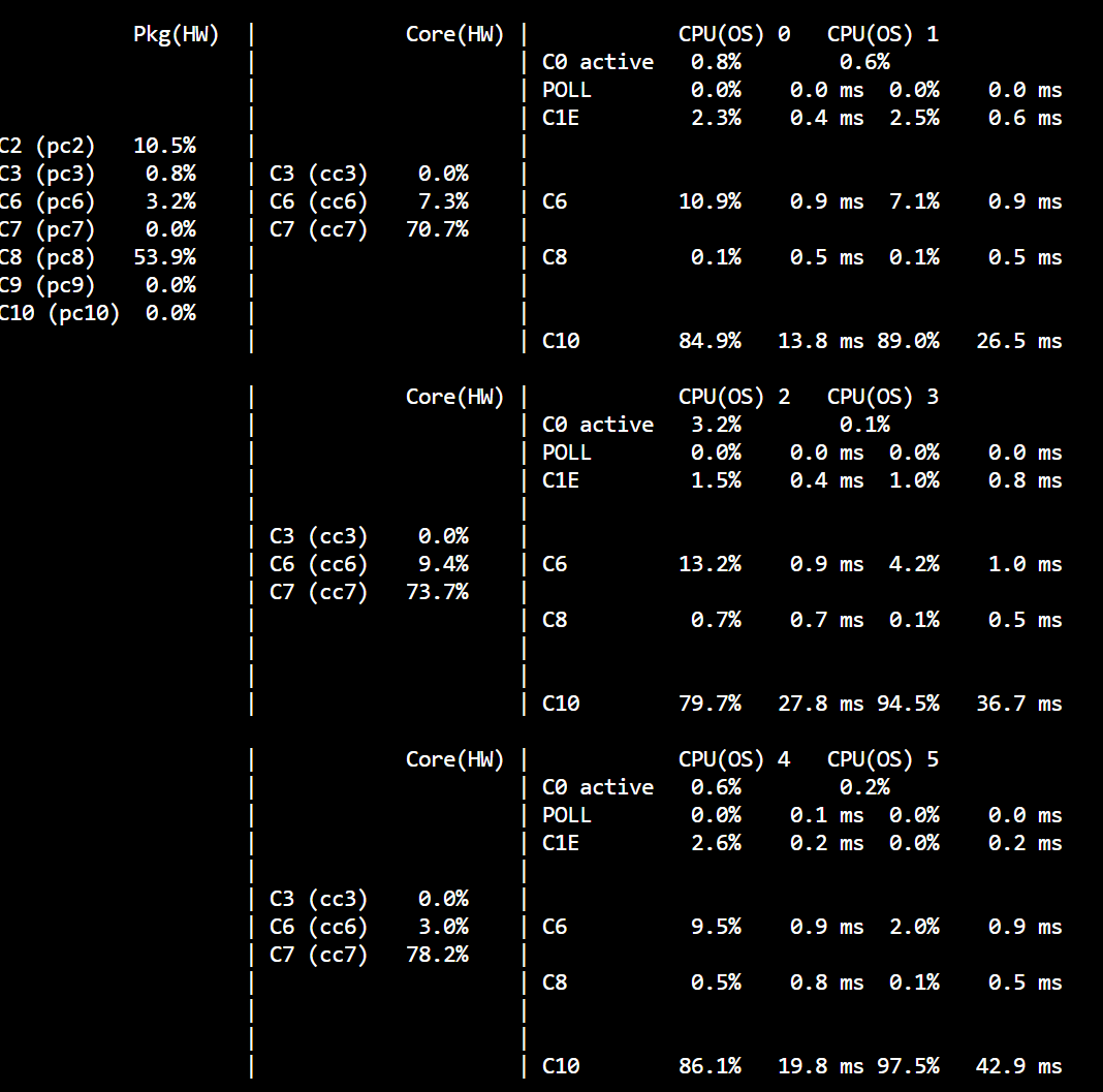

Servus miteinander,
bin seit geraumer Zeit stiller Mitleser und konnte schon einige Tipps umsetzen....
Ich betreibe aktuell einen Server aus folgenden Komponenten:
Mainboard: Gigabyte Z690 UD DDR4 ATX-Mainboard
CPU: 12th Gen Intel® Core™ i5-12400
RAM: 48 GB Ram (2x 16GB + 2x 8GB)
Netzteil: Be quiet Pure Power 11 350W
Array: 4x 8TB WD Red + 2x 2TB WD Red
Cache: Samsung 980 Nvme SSD 1TB
Unassigned Device: Crucial P2 CT1000P2SSD8 1TB
Flash: Intenso Slim Line 8GB
angeschlossen USB Geräte: 1x Sonoff Zigbee-Stick + 1x Homematic USB-Platine
Unraid Version: 6.12.0-rc6
Was habe ich bereits umgesetzt im BIOS:
Plattform Power Management ENabled
PEG ASPM Enabled
PCH ASPM Enabled
DMI ASPM Enabled
C-Sates Enabled
C-State Limit auf C10
CPU EIST Function Enabled
Reac TO Halt Enabled
Audio Controller disabled
LEDs disabled
Serial Port disabled

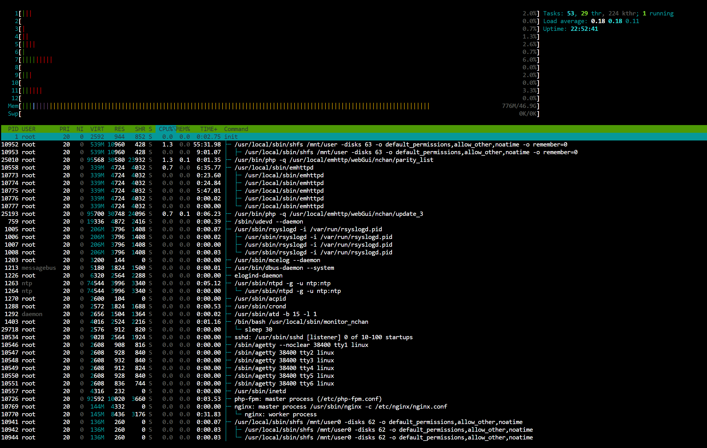

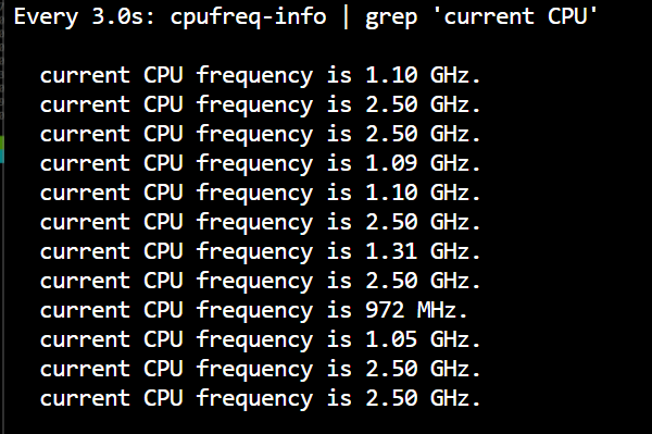

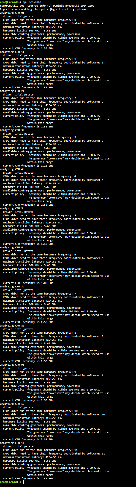

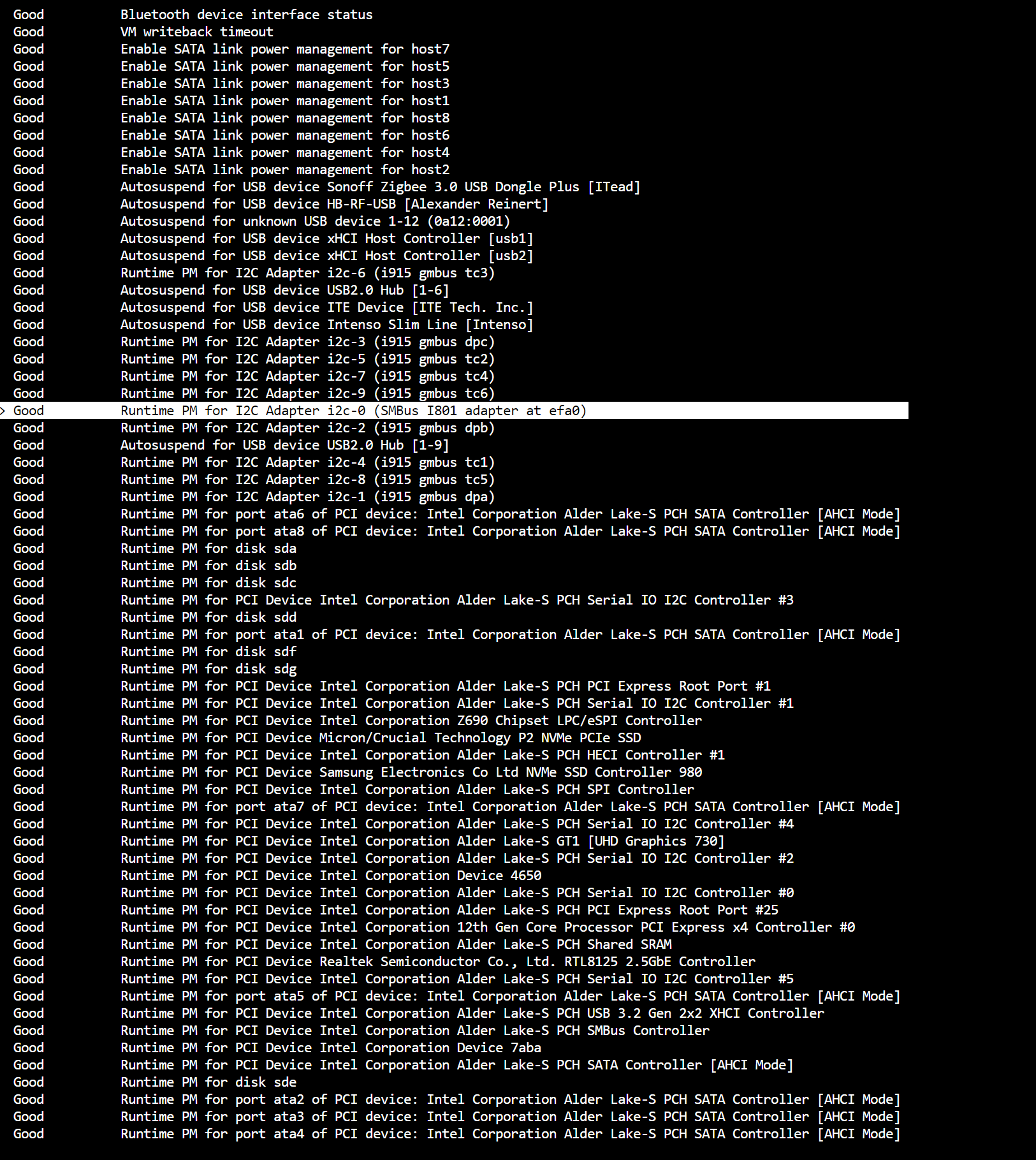

Screenshots:
watch -n3 "cpufreq-info | grep 'current CPU'"
htop
cpufreq-info
lspci -vv | awk '/ASPM/{print $0}' RS= | grep --color -P '(^[a-z0-9:.]+|ASPM )'
powertop

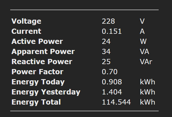

Tasmota Steckdose:
Der Verbrauch schwankt immer zwischen 20-25 W bei gestartetem Array (Festplatten sind runtergefahren). Docker und VMs deaktiviert.
Wenn ich mir mir im Thread so die Verbräuche anschauen dann finde ich den arg hoch.
Sobald ich diverse Docker und VMs starte komme ich auf einen Verbrauch von ca. 35-40 Watt.
C8 State wird erreicht - warum aber nicht bis C10?
Habt ihr noch evtl. Tipps wie ich es weiter reduziert bekomme?
Sobald ich Docker und VMs starte bleibt er bei C2 stehen...
Edited by Yonbas
Hi ich komm bekomme bei dem Befehl folgende Rückmeldung
Die Tunables sind aber von BAD auf Good gewechselt.
Komm aber nicht über C2 hinaus, so wie es scheint.
Bios hab ich bis die C-Stages bis C10 freigegeben / eingestellt.
kann ignoriert werden
