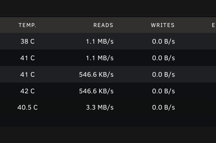

I get frequent ready access on all of my array disks what prevent the disks to spin down :-(
I've used File Activities and Open Files to investigate, but no access to array have been listed.
Strange is, that even if I see reads in kb always with the same rate, toggling to the read amount still shows 0.
Does anybody have an idea, how to identify what is causing this?
rechenknecht-diagnostics-20230320-1929.zip
Try booting in safe mode to rule out any plugin issues.
