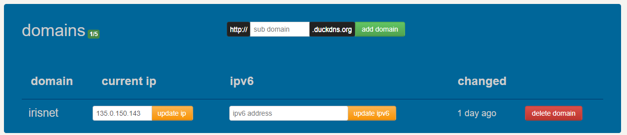

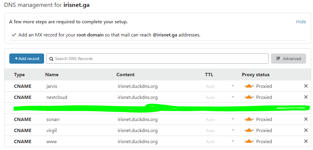

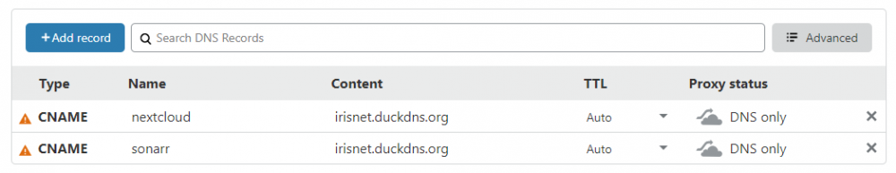

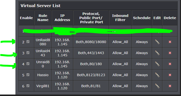

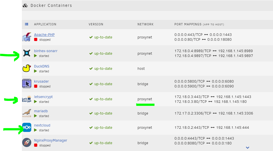

Hi Everyone, I have tried to fix this myself for a few days and I have failed. So looking for some guidance. If this is not the right forum, please let me know and I will go to the UnRaid forum and ask there.
1. So I use UnRaid 6.7.2 and I installed the Letsencrypt docker app. I also installed nextcloud and sonarr.
2. I bought a domain irisnet.ga and I have put two CNAME in there. sonarr.irisnet.ga and nextcloud.irisnet.ga
3. I used dns certificate method in the Letsencrypt to generate the certificate and it generates for the two subdomains. http method doesn't work as the challenge fails. My port 80 might be blocked. Not sure about this one.
4. I followed spaceinvaders youtube videos to setup the reverse proxy for both of the nextcloud and sonarr. However, seems like in cloudflare is not able to reach my server when I type in https://nextcloud.irisnet.ga for example. I get a 522 error.
Router Setup
Cloudflare Setup
Docker Setup
Letsencrypt Output

Hey, I don't use duckdns because I have a fixed IP, but I have got Nextcloud running.  I had this issue at the beginning too.
Also, the LuaJIT / restycore error at the end of your letsencrypt log is apparently perfectly normal (I think it's just a docker issue and I have it too), so don't worry about that.
What I suggest you do is turn off the 'cloudflare proxy' setting for any non-working cname.  I'm not actually sure how duckdns works, but to start with I'd suggest you also turn of any cloudflare proxy setting to do with duckdns set up as well.  You can gradually turn them on later to test which ones work.  I found some apps are OK, others are not.
I found I got a 'too many redirects' error with this turned on - and if you're using duckdns it's probably going to be even more redirects.  Also, I found I had to wait quite some time (up to a day maybe) after turning this off for it to take effect.
The proxy feature hides the IP address of the real host by providing a cloudflare one, then redirecting it.
I've read that enabling strict HTTPS can help this issue, (as normally it only occurs when using https, which everyone either does or should now).  I suspect this will get you working, then if you ever manage to move that forward more so that you can get the proxy enabled as well, please let me know cause I haven't managed to yet!
Also, don't worry about turning off the proxy setting too much - this is the way most people run their DNS - it's a great feature but not absolutely necessary.  You'd be better spent ensuring you have a real firewall installed like OPNsense or similar.
Let me know if you need any more help and good luck!!

Thank you very much for your reply. I am going to try your recommendation. The made the following change to keep things clean.
Cloudflare:
DuckDNS:
I am not sure about the enabling strict https setting but I will research. I think you are right about the proxy part. Because the DuckDNS on the hassio works as it goes to duckdns only and not through cloudflare.
I will keep monitoring and report back tonight. Thank you for the direction here.

Ok setting the cloudflare to dns more returns the right ip if I ping sonarr.irisnet.ga for example. I am pretty sure something is not converting at the router. Since I have my port 443 redirected to the UnRaid server port 1443, is there anyway I could test if a service is available on port 443 directly from the internet? i.e. If I turn off Letsencrypt, then change the port for Sonarr to 443? I am just want to confirm that I can access a service directly on the port. Right now when Letsencrypt is running, I can see the port open using and online port checker.

With this I found I had to be carefeul - just because it's returning the right address on one machine, doesn't mean it's returning the right address in all cases, and if it's not, it won't work.  Cloudflare is pretty good with speedy DNS updates, but I found I had to wait for this particular change.  Are you pinging from the server or the client?
Also, I assume you're testing via some external internet connection such as tethering through your phone?  If so, checking that IP address pings correctly is important.  At this point I'd suggest looking at the active logs of both the letsencrypt docker and the particular app you're going to e.g. nextcloud wihtin the appdata directory or equivalent.  I found I could see issues in there fairly easily.  Also the logs in the GUI of the docker container on the docker page in unraid.

Thanks for the reply. No I am testing from within my network. I will test it via the phone tonight.
My network setup is pretty standard, 5 computers behind the router. 3 plugged into the router and 2 laptops (there are also phones). 1 server (UnRaid), 1 pc (Windows 10), 1 raspberry pi (Hassio), 2 laptops (Windows 10). I have a laptop that I can use to tether with the phone. Before I do this, I have disconnected hassio so it doesn't ping out when I test. I am also going to redo the nextcloud configs to make it match the spaceinvader setup. I will post the setting here for review.

For within your network, it's likely best to create a static DNS record, with the same domain name you're using and point that at your INTERNAL nextcloud / unraid address.
So:
  1. Unraid needs to have the correct IP for the domain
  2. Cloudflare needs to have the correct IP for the domain
  3. The proxy setting in cloudflare should be off
  4. You need to give it time for the new cloudflare setting to propagate to the DNS servers on the internet (which will include the DNS server at whatever phone provider you are using AND the DNS server that your home router is using)
  5. Internal devices either need the internal DNS updated or some router trickery which you may or may not have, which is why I suggest adding this manually for now
If you can't figure out how to do this in the router, for testing purposes you can test by just pastin the internal unraid / letsencrypt IP and DNS record into your clients hosts file.  Be sure you clear the DNS cache on the local client each time you change this as it will always remember the last setting.
Hope that helps.
