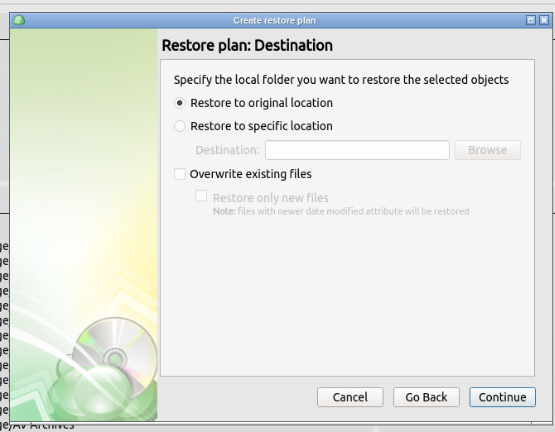

4 hours ago, Phastor said:
I would love if it has a restore option to ignore files that already exist. Duplicati only offers the option to overwrite or create duplicate. Does Cloudberry do this?
I've only tested individual file restoration after deletion. But it appears from the menu it will only replace missing files unless you specify overwrite existing on restore.
59ad28fb80df6_Screenshotfrom2017-09-0406-18-21.png.4895eb249a49214cb48a11892ccdee7c.png
The two things I have noticed (in local backups) that may be important to considering cloudberry:1. encryption/compression- keeps the file name intact vs obfuscating it.  2. The versioning cloudberry does is whole file versions and not referencing. So it doesn't keep just the changes, but the whole file again. This means more space. But it also means that if the original file is corrupted, you don't lose it, just that version.
