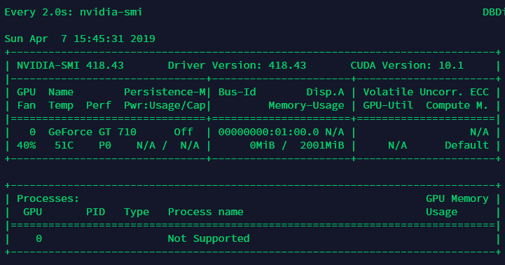

well, i have also this:
and Plex ist stuttering well. HP NHL40, unRaid nvidia Version  6.7.0-rc7.
You should edit your screenshot to get rid of the plex claim token.
Share this post
Link to post
The nvidia 710 doesn't seem to have NVENC so it's not going to work / plus not supported by nvidia-smi.

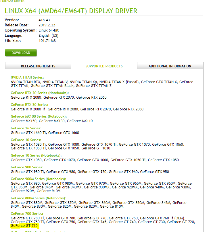

image.thumb.png.d55142ec1edf47a6f3b4e33304df37fa.pngwhen i click on the link in unraid, check your card is supported...
Share this post
Link to post

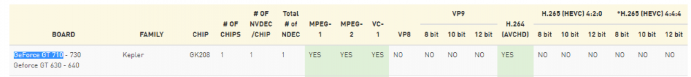

Doesn't mean it has the NVENC chip requirements to transcode

gt 710 seem to support NVENC for h.264 (AVCHD) YUV 4:2:0 and for NVDEC - AVCHD.
Edited by dibux
Share this post
Link to post
Hmmm, well nvidia-smi is separate to that so I suppose the original issue is stuttering, probably need some more info on what you're transcoding to/from and network setup.

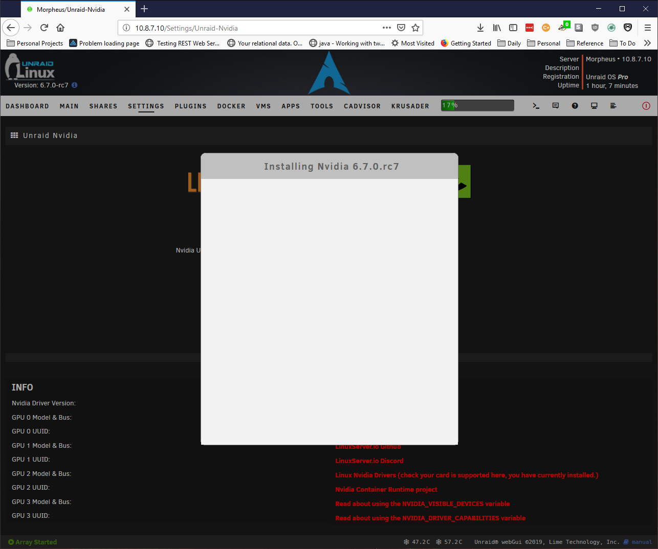

image.thumb.png.08c85855448077f182d16960884833cc.pngimageproxy.php?img=&key=00b562fcac28e727
Could it be something to do with this.... When I try and update the unraid nvidia install I just get a white screen.  Based on screen shots earlier in the thread I should be getting some kind of output and I should be getting back to a done button.  However, this just hangs.  I have been letting it sit for about 10 minutes.
Note: I tried with various browsers to see if it was running but nothing is showing up in chrome or firefox.  And after reboot, it isn't behaving like anything is being installed.  I tried the Stock Unraid 1.6.7.0-rc7 install as well and got the same result...blank white box.
Additionally, I tried uninstalling the nvidia unraid plugin and reinstalled it and tried again with the same result.
Edited by kymnyth

1 hour ago, kymnyth said:
I lost my nvidia gpu passthrough and therefore my hardware acceleration after updating to unraid 6.7.0-rc7
This plugin actually installs a custom build of Unraid. Updating to a new version of Unraid means you are installing a non-custom build that doesn't have nvidia support.
Share this post
Link to post
Yes, thanks for that information.  I installed the update and now I am trying to install the custom build with nvidia support  however the installer is hanging as is shown in the screen shots above.  Should I rollback to 6.7.0-rc6 and then try to install the update custom nvidia unraid build? Thanks.
Edited by kymnyth
Share this post
Link to post
The sort of issues you describe are normally a result of a DNS issue or incorrect MTU setting on your router.
Sent from my Mi A1 using Tapatalk
Share this post
Link to post
My MTU value is set to 1500 and DNS is acquired from my ISP.  Is this reasonable?
Share this post
Link to post
I'm not sure what the issue was.  To be on the safe side I rebooted my router and all is well now.  Thanks for the help trurl.
