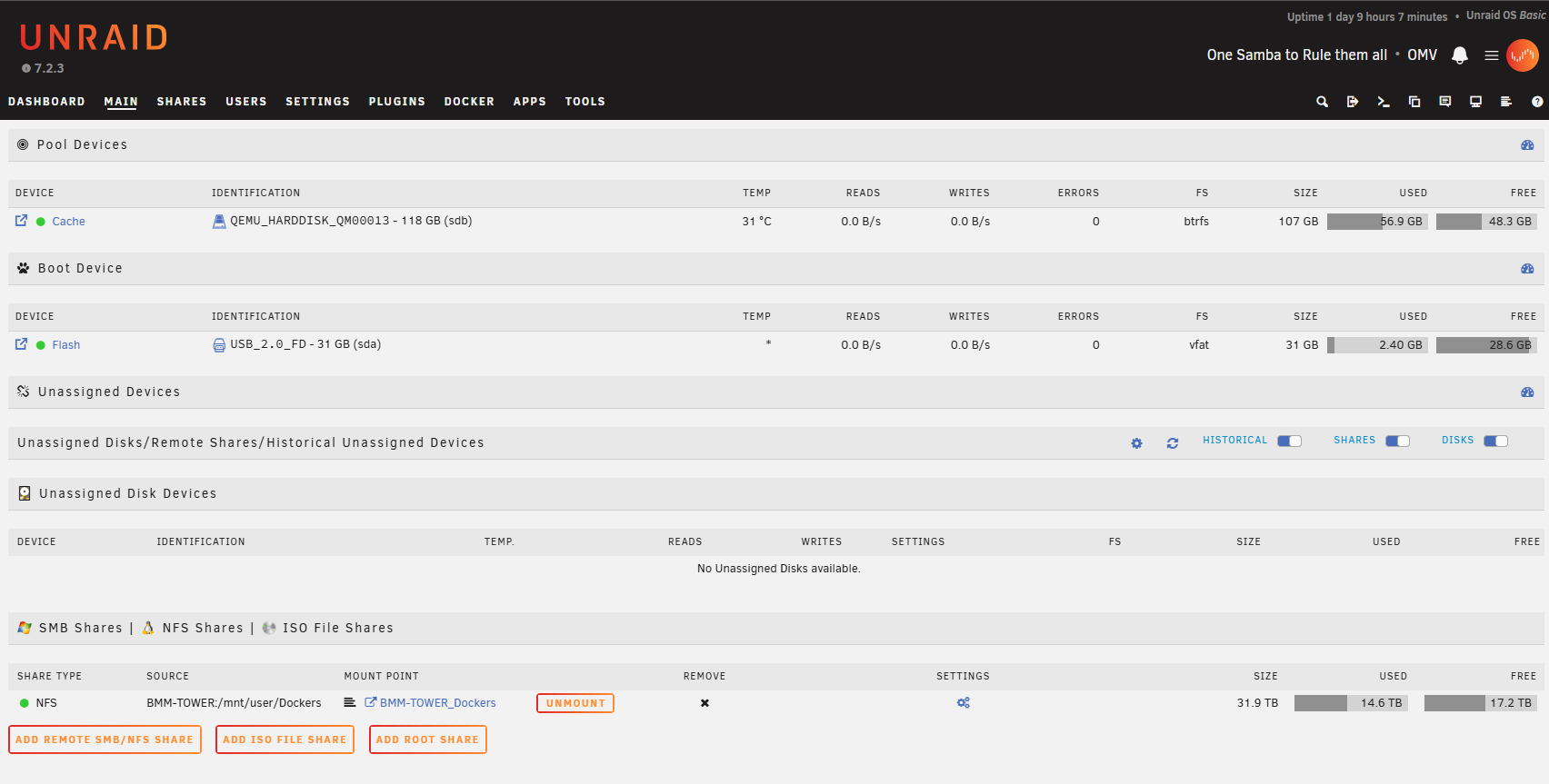

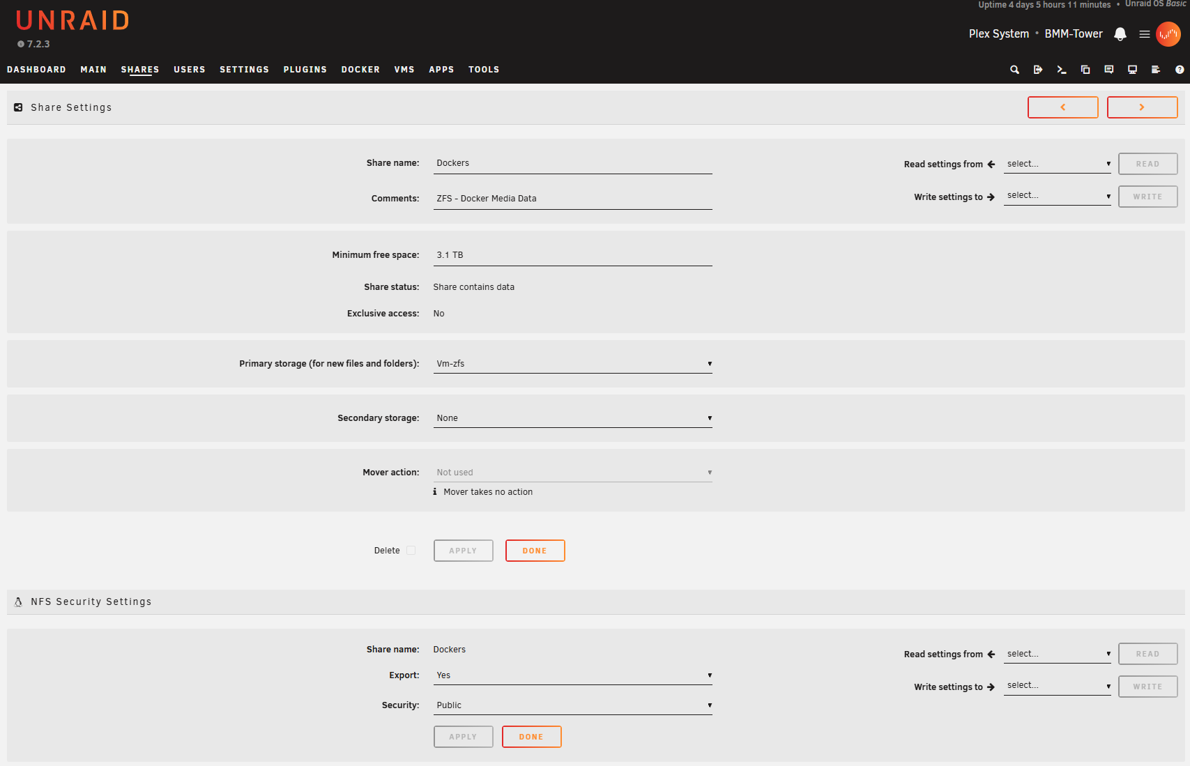

Connecting two Unraid servers
Correct via Unassigned disk. you would setup a share via NFS. and then connect to nfs via UD plugin to have a /mnt/remotes/Hostname_Sharename I have a media server plex instance and other as a separate unraid bare metal instance. the plex unraid system shares its docker folder: In my other unraid system Via UD in my unraid VM test instance... and now my OMV unraid instance can interact with teh docker folder... This said I recommend using FCP (Fix Common Problems) plugin) as you will need to set access edits if interacting with a remote share via another unraid docker. FCP will war go over and help you correct proper remote access and interaction with docker and remote connections.

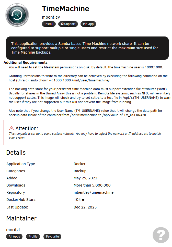

Time Machine backup disk image cannot be created on zfs pool
they are not required. They can assit zfs with time machine shares. Example ZFS passed into unraid for samba. root@pve:/data# zfs list NAME USED AVAIL REFER MOUNTPOINT VMs 103G 797G 96K /VMs VMs/pve 103G 797G 77.9G /VMs/pve data 2.07T 12.4T 67.8M /data data/Dockers 106G 12.4T 26.0G /data/Dockers data/PBS 19.6G 12.4T 19.6G /data/PBS data/PVE 168K 12.4T 104K /data/PVE data/TimeMachine 60.0G 12.4T 30.1G /data/TimeMachine data/Users 761G 12.4T 761G /data/Users data/samba 1.15T 12.4T 1.13T /data/samba root@pve:/data# zfs get xattr,dnodesize,recordsize,atime,case,acltype,aclinherit data/TimeMachine NAME PROPERTY VALUE SOURCE data/TimeMachine xattr on inherited from data data/TimeMachine dnodesize legacy default data/TimeMachine recordsize 128K default data/TimeMachine atime off inherited from data data/TimeMachine casesensitivity sensitive - data/TimeMachine acltype posix inherited from data data/TimeMachine aclinherit restricted default root@pve:/data# Where I could runn the above and imporve my zfs and apple time machine connections... I mentioned zfs extra options as that is whats recommend via samba linux team with zfs. There are a few guides via Google that go over it and it was worth a mention. Required no, helps yes. When users with default samba default unraid config have isseus its worth a try / test. other random google data on it as well: https://discussions.apple.com/thread/256112267?sortBy=rank https://github.com/jollyjinx/ZFS-TimeMachine Where most of that data came from: https://prafiles.in/using-zfs-for-timemachine/
Sorry for the late replies... I was digging and waiting on some more info from the linux samba team... glad you found a solution. Some base stock samba info vfs objects = catia fruit streams_xattr fruit:metadata = stream fruit:resource = stream fruit:locking = none fruit:time machine = yes ea support = yes store dos attributes = yes This is textbook-correct bare min for stock samba: macOS ≥ Big Sur SMB-based Time Machine streams_xattr instead of netatalk... But To answer some of your questions... Samba 4.21.x + macOS Tahoe SMB client regressionmacOS Tahoe (26.x) tightened SMB2/3 create semantics for Time Machine: During sparsebundle creation, macOS now: Performs multiple parallel SMB CREATE requests Uses compound requests with durable handles Heavily stresses: NTCreateAndX extended attributes streams + locking state rename atomicity Unraid’s Samba path fails before file creation completes: This is a metadata handshake failure, not a storage failure. Unraid’s Samba is not “stock Samba”*This is critical. What I have found. Unraid: Injects wrapper logic Auto-generates smb.conf fragments Applies opinionated defaults Mixes: POSIX ACL translation user/group coercion share-level overrides Even when you use SMB Extras, Unraid still: Controls startup order Owns winbind behavior Manages mdns / avahi Applies internal permission normalization *Docker bypasses all of this. *This is a reason why I run my own smb config... ZFS makes the bug deterministicZfs is strict, and there are so,e other zfs settings that need to be set / watched... macOS expects AFP-like semantics emulated over SMB. When Samba’s fruit module almost matches expectations but fails one atomic metadata edge case → macOS aborts immediately. Some ZFS checks: zfs list asumed pool / datset is tank/TimeMachine Check current ZFS settings: zfs get xattr,dnodesize,recordsize,atime,case,acltype,aclinherit tank/TimeMachine Set required / recommended properties zfs set xattr=sa tank/TimeMachine *Only applies to new files. Existing files keep old layout. Dnode sizing (metadata-heavy workloads): zfs set dnodesize=auto tank/TimeMachine Case sensitivity (must be set at creation time) *(this is set at dataset creation...) check: zfs get case tank/TimeMachine how to set (zfs master or teminal): zfs create -o case=sensitive tank/TimeMachine ACL behavior (recommended for SMB/macOS): zfs set acltype=posixacl tank/TimeMachine zfs set aclinherit=passthrough tank/TimeMachine Check: zfs get acltype,aclinherit tank/TimeMachine RE verify: zfs get xattr,dnodesize,case,acltype,aclinherit,atime tank/TimeMachine expected ideal output: xattr sa dnodesize auto case sensitive acltype posixacl aclinherit passthrough atime off Why force user = root is NOT the issueThis gets blamed a lot. Incorrectly. You already proved: Multiple Macs Multiple NICs Multiple filesystems Same failure point If this were permissions: You’d see partial sparsebundle creation You’d see permission denied You’d see retries Instead you get instant abort. That’s protocol-level, not POSIX. @JorgeB Why Unraid specifically is at fault (not Samba in general) Same macOS + same Samba version works on: TrueNAS SCALE Linux + system Samba Dockerized Samba Fails on: Unraid native SMB This isolates the bug to: Not Samba upstream. Not ZFS. Not macOS alone. Unraids has a good implementation, just doesn't fit all use cases... there is no samba config option that can be implemented to easily address users issues on apple time machine. *I've even see this where a old time machine configuration break due to smb share config changes and it not be samba its go to the dam Apple delta time machine and reconnect! Similar to zfs snapshots. apple time machine are snapshots on apple hfs. It's entirely metadata to storage. Apple aborts if any degradation is detected to preserve the snapshot data. even when Apple makes a client connection to unraid and how unraids samba/avahi and settings handles CIFS is affected here. I did a deep dive with a another person on the forum with apple and rsync. The underlying issues is in how apple clients connects. The docker just has a known working state which can be implemented on bare unraid. But yes, a Docker version of this is fine for a good soltuon for others. So to Recap Based on behavior, logs, and known Samba issues: This aligns with: Failure timing Docker success ZFS sensitivity Tahoe-only regressions

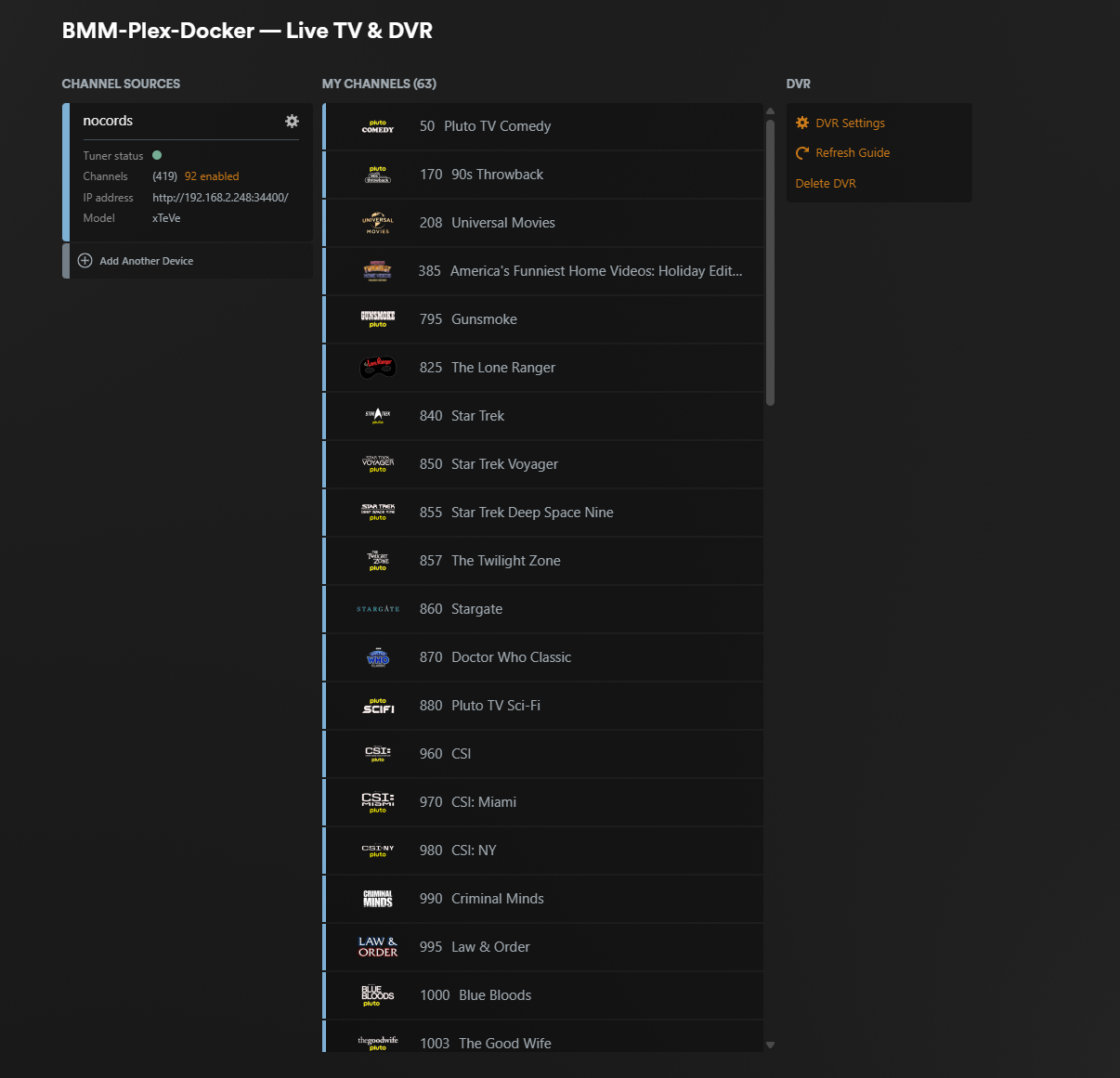

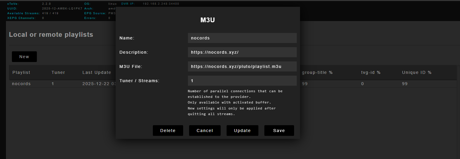

Guida Plex: installare xTeve per Live TV channel
you can generate this with xteve: http://<your IP of XTEVE>:34400/xmltv/xteve.xml *Programmed inside xteve with filters... plex needs the xml file, I usually use no cords for USA English. USA - English Pluto https://nocords.xyz/ when plex asks for a guide use the xml: https://nocords.xyz/pluto/epg.xml example nocords: xteve playlist: plex add tuner: ################################################################################### Its why I shared the Legal Free IPTV: https://github.com/Free-TV/IPTV the guides and playlist. INFO Playlist info of content: https://github.com/Free-TV/IPTV/blob/master/lists/italy.md Xteve the file to grab: https://raw.githubusercontent.com/Free-TV/IPTV/refs/heads/master/playlists/playlist_italy.m3u8 For Plex:. Example for all the egp xml GUIDE DATA: https://github.com/Free-TV/IPTV/blob/master/epglist.txt XTEVE Italy xml https://epgshare01.online/epgshare01/epg_ripper_IT1.xml.gz

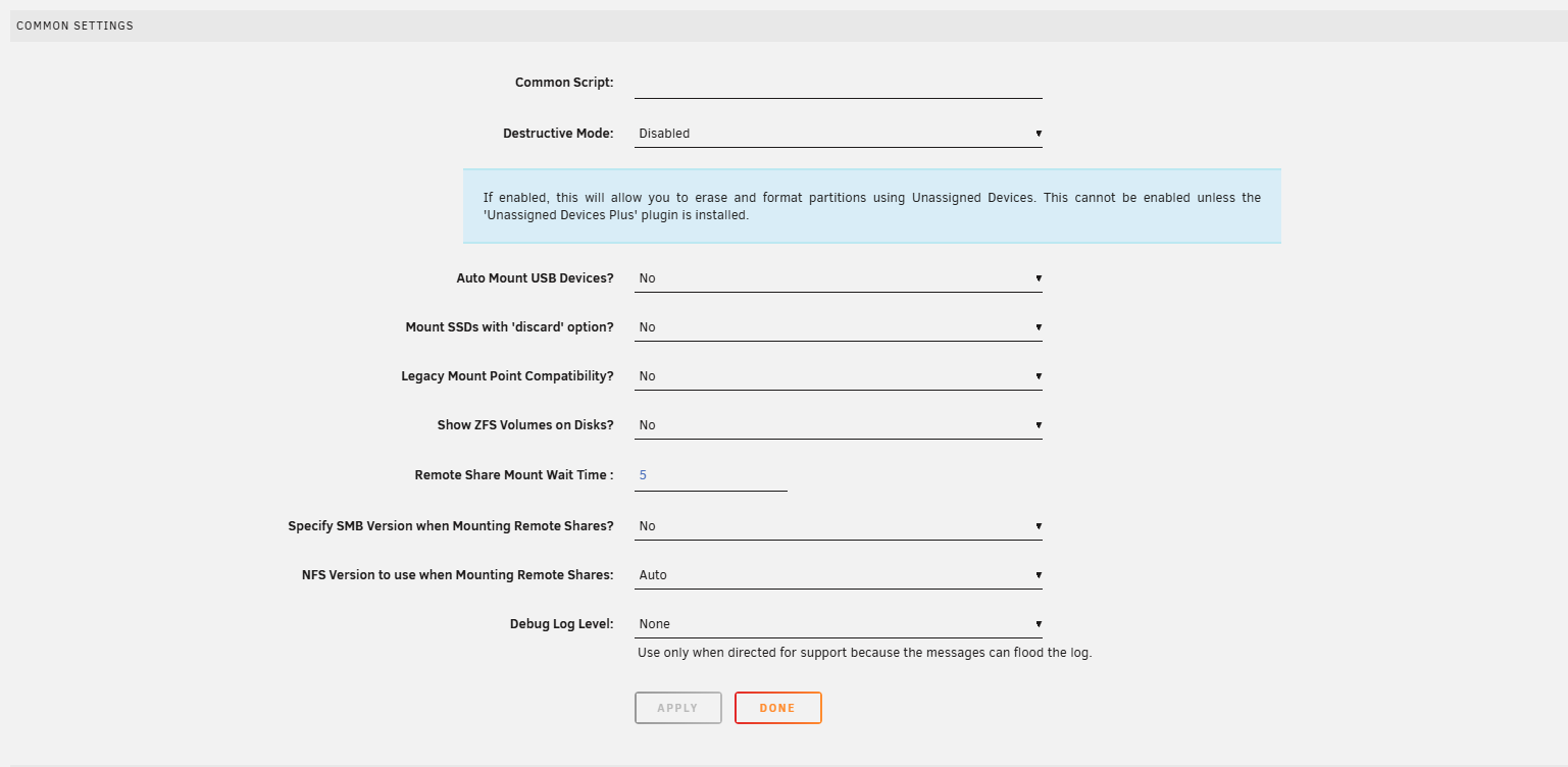

Marking Disk For Savety Removal and Empty it
Has explained my original reply. As I also know the terminal commands and don't care that I'm using terminal and only bumped this because I thought it'd be nice to actually have a button that would do this.. I essentially just need to run three commands ... This would entail me run-in umount commands, clear commands, partd commands, make.fs commands... etc etc..
Preclrar doent do the format correctly for other disks. I have tried preclrar that and aom some I don't want the parity wrote of zero being added .. Again I want a single disk part clean which is fast. This has to do with clearing down flags got and setup used disk for reinitializing on other systems...
No UD gives me mount... I still have to run commands to clear a disk via terminal... I want a button with a warning that clears the disk. Similar to running windows diskpart clean UD give me a udev like rule for a script to run per the US device.. I just want a nicer button that runs the terminal commands to clean up disks for reuse (not on unraid)
I would like to see this as a option in the unassigned disk for disk recovery and clearing for use else where. scenario I have a lazrus system. I plug in a Disk and use unasiged to mount and move the data I want off. I would like a way to clear the disk after wards... This would entail me run-in umount commands, clear commands, partd commands, make.fs commands... etc etc... when the unassigned disk could do this for me with a click of the button...
