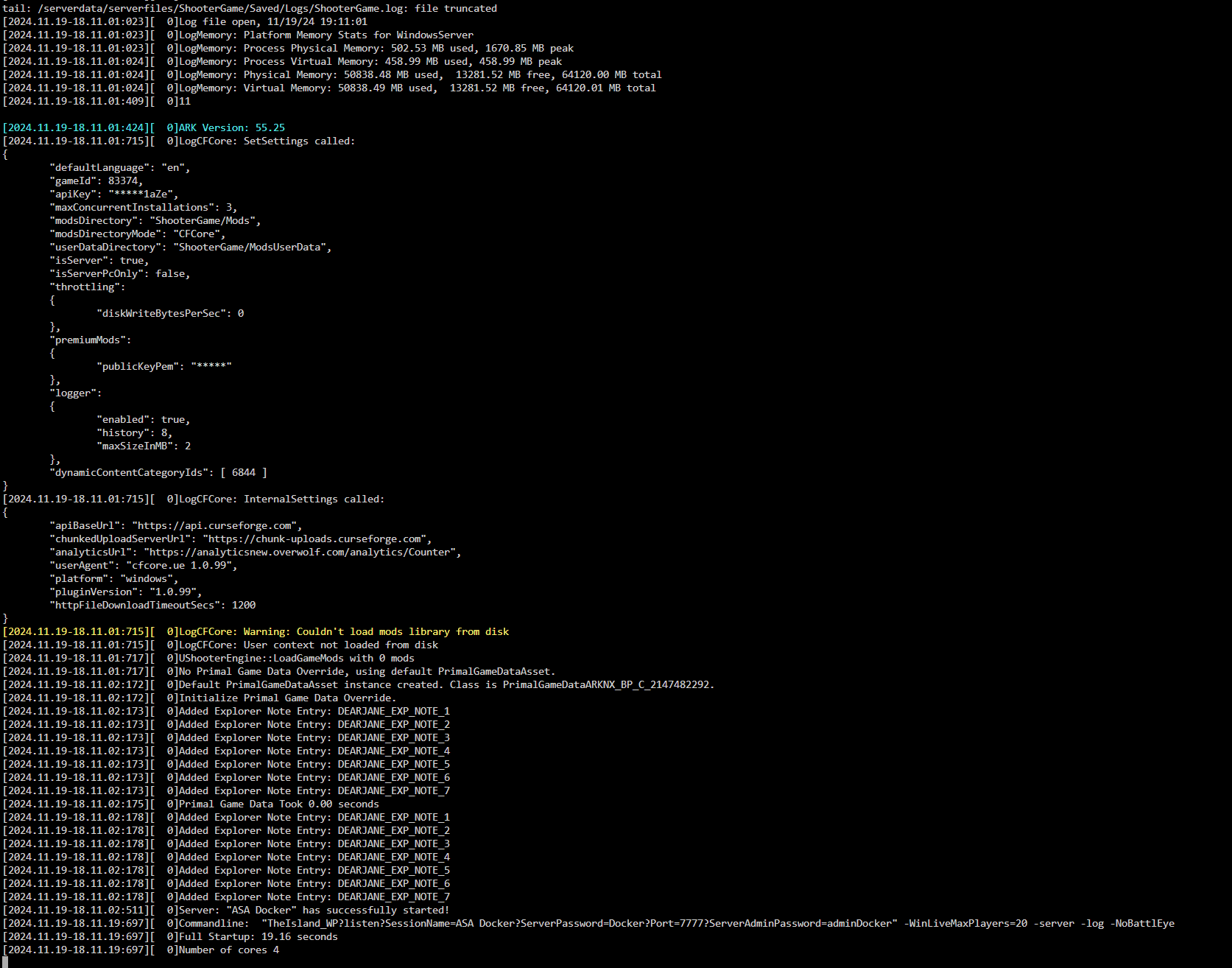

  11. okay, this is rather peculiar. Since you asked for the log and i stupidly deleted the files already, i had to reinstall the asa server and it wont work anymore. Seems like they updated the dedicated server right after and its broken atm because the dedicated server version wont even start on my pc. 🤣 So yeah, that took longer than i wanted to because i had to copy the whole game onto the server. (they actually updated the dedicated server while im prepping this text, so they fixed their broken update) I did install it as the website says, unzip it all in the win64 directory. But i didnt change the log to tail. Heres the log of the Ark-Api thingy 11/19/24 19:23 [API][info] ----------------------------------------------- 11/19/24 19:23 [API][info] ARK:SA Api V1.17 11/19/24 19:23 [API][info] Brought to you by ArkServerApi 11/19/24 19:23 [API][info] https://github.com/orgs/ArkServerApi 11/19/24 19:23 [API][info] Website: https://ark-server-api.com 11/19/24 19:23 [API][info] Loading... 11/19/24 19:23 [API][info] Cache files downloaded and processed successfully 11/19/24 19:23 [API][info] Cache is still valid loading existing cache 11/19/24 19:23 [API][info] Reading cached offsets 11/19/24 19:23 [API][info] Reading cached bitfields 11/19/24 19:23 [API][info] Initialized hooks 11/19/24 19:23 [API][info] API was successfully loaded 11/19/24 19:23 [API][info] ----------------------------------------------- 11/19/24 19:23 [API][info] UGameEngine::Init was called 11/19/24 19:23 [API][info] Loading plugins.. 11/19/24 19:23 [API][info] Loaded plugin Ark:SA Permissions V1.02 (Manage permissions groups) 11/19/24 19:23 [API][info] Loaded all plugins 11/19/24 19:23 [API][info] AShooterGameMode::InitGame was called 11/19/24 19:23 [API][info] SERVER ID: 204977789
  12. you can do it yourself with a bit of reading into docker. Well, technically you dont even need to since you "only" need to modify the start script within the container, but that would be a pain on recreation. But all you would need to do is change the "ArkAscendedServer.exe" to "AsaApiLoader.exe" in the start-watchdog.sh and start-server.sh and if it works well with wine, youre golden. But ultimately you wanna build your own container with the modified scripts so you dont need to alter them everytime. https://github.com/ich777/docker-steamcmd-server/tree/asa i gave it a quick shot and it seems to work, but i didnt test
