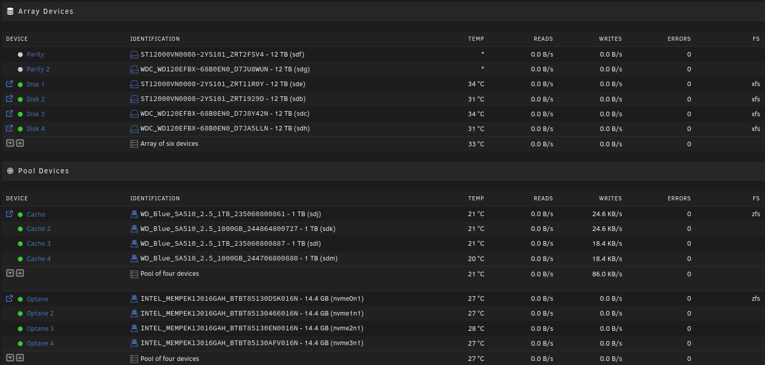

Rebuilding SSD array into SSD pool?
This is going to be a process. My suggestion is to consolidate all data onto as few of your disks as possible. You need to at least have two emtpy disks to make this work I believe. With the empty disks, make a pool and add them. Set them as zfs filesystem in RAIDZ1 Yours will say "1 vdev of 2 devices" at first. With that complete. Copy the data from the remaining two array ssds onto the newly created pool. When that is done, you can add the 3rd disk to the pool, once the expansion process is finished you can add the 4th and final ssd to the pool and you will end up with a result like the screenshot where it says "1 vdev of 4 devices" if it goes according to plan.
