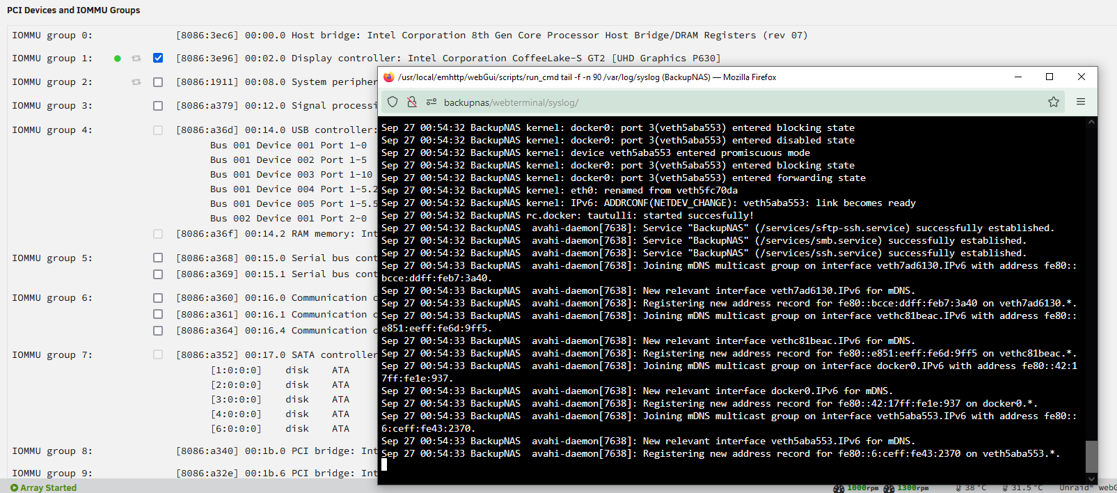

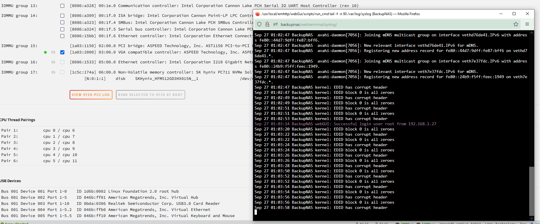

6.11 update > EDID block 0 is all zeroes
iGPU bound to VFIO = no EDID has corrupt header/EDID block 0 is all zeroes errors in syslog. ASpeed bound to VFIO = EDID has corrupt header/EDID block 0 is all zeroes errors in syslog. The iGPU in the case of my servers appears to be the culprit.

Will likely need to roll back both servesr to 6.10.3 due to the EDID has corrupt header /EDID block 0 is all zeroes errors filling the syslog. Plugged in monitor does not help. Cannot blacklist iGPU and AST (IPMI) drivers as they are actively used. Others have reported this makes no difference anyway. medianas-diagnostics-20220926-1028.zip
I have a VGA monitor connected to my server. It does not stop the errors which hit the log every 2 seconds Sep 26 09:59:28 MediaNAS kernel: EDID has corrupt header Sep 26 09:59:28 MediaNAS kernel: EDID block 0 is all zeroes I have an AST (IPMI) on the server and iGPU in the E-2288G processor. I can't blacklist either as I use iGPU for transcoding and AST for KVM access to server via IPMI. Hopefully this gets fixed soon. The problem was not present in 6.10.3 which was running previously on the server. Same issue on my backup server which also has an iGPU and ASpeed chip for IPMI. No monitor is plugged into that server as it is in a closet in the basement. I guess I could try a dummy plug there but an attached monitor on main server does not prevent the errors.
