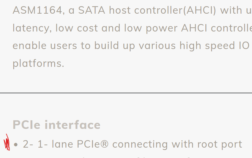

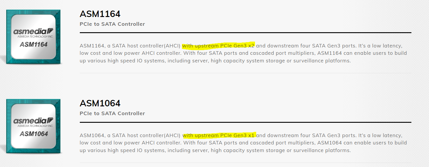

Does anyone know which ASM supports ASPM? Having hard time finding concrete information except for ASM1166 (positive reports that it does). I only need a controller with 4 SATA, least amount of power draw.
EDIT: on ASMedia site, they say all 1064/1164/1166 Support L0s/L1/L2.... This I guess answers my original questions. What I can't find is the difference between 1064 and 1164.
Edited by OrdinaryButt
1064 is x1, 1164 is x2
Well, in the opening post you do say that you have seen 1164 with x1, and ASM says 1-, 2- (see screenshot) what ever it means.
I am looking for actual data that shows - is 1164 faster than 1064 or any other differences. Their web pages shows minimal details as each is listed as 25mhz Crystal
https://www.asmedia.com.tw/product/17fYQ85SPeqG8MT8/58dYQ8bxZ4UR9wG5
https://www.asmedia.com.tw/product/A58yQC9Sp5qg6TrF/58dYQ8bxZ4UR9wG5
Yes, but will depend on the implementation, 1164 can support x2, 1064 not.
