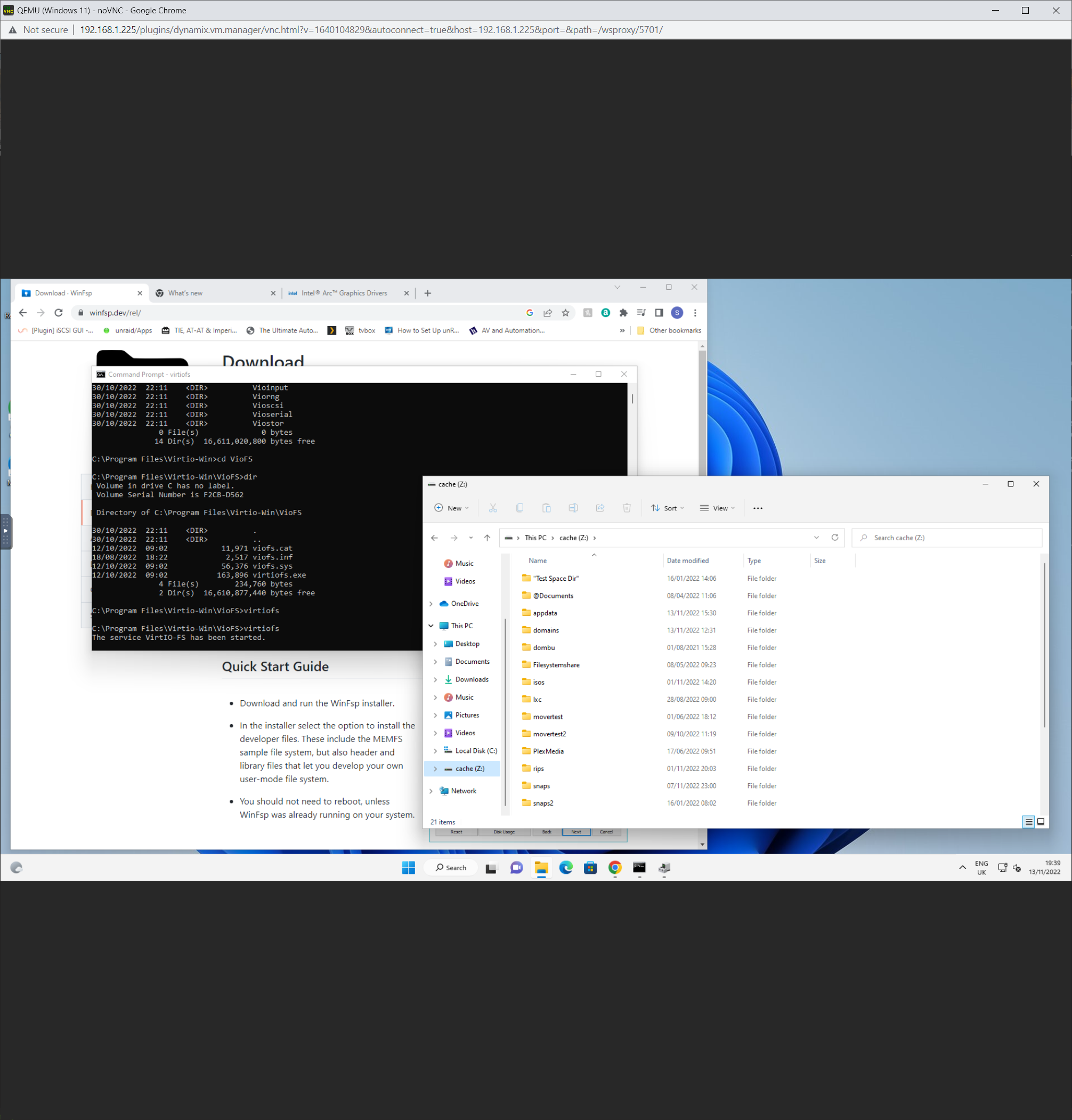

    Can we please get some official documentation on how to mount Unraid directly into Windows and Linux VMs with Virtiofs?  Documentation is all over the place and I'm having to piece together info from

Yes I think that may be outdated. as I didnt find it either. You should just need to start the service and z: drive will be mapped. I just run the virtiofs.exe for testing without a service.
I have installed WinFsp and the virtio win drivers from the ISO but when I run virtiofw.exe I don't see new drives or anything. Should it appear automatically?
Do you what could be the problem?
  <memoryBacking>
    <nosharepages/>    ---------> SHould I delete this line from the XML?
    <source type='memfd'/>
    <access mode='shared'/>
  </memoryBacking>
Edited by L0rdRaiden
  <memoryBacking>
   <no sharepages/>    ---------> SHould I delete this line from the XML?
  </memoryBacking>
Yes,
Have you created a mapping in the vm template?
Should just show as z: drive

On 10/7/2022 at 7:31 AM, SimonF said:
For windows you need to install additional parts on  the guest. https://virtio-fs.gitlab.io/howto-windows.html
For a linux guest you just mount the share   sudo mount -t virtiofs unraidshare /mnt/unraiddata/
Ich habe versucht die Anleitung von https://virtio-fs.gitlab.io/howto-windows.html zu folgen, jedoch wird mir der "Mass Storage Controller" im Geräte-Manager nicht angezeigt. Ist es korrekt, dass ich den Installer für https://winfsp.dev/rel/ , ganz einfacht mit der Standardkonfiguration folge?
Wo finde ich ausserdem diese "virtiofs PCI device driver" ?
15 minutes ago, Metti said:
I tried to follow the instructions from https://virtio-fs.gitlab.io/howto-windows.html , but I don't see the "Mass Storage Controller" in Device Manager. Is it correct that I just follow the installer for https://winfsp.dev/rel/ with the default configuration?
Where can I also find this "virtiofs PCI device driver"?
On virtio cd
Did you set memory backing? note there are reports of vm lockups with mem backing enabled
Edited by SimonF
1 hour ago, SimonF said:
On virtio cd
Yes, i pasted that code, that i read before from you.
 <memoryBacking>
  </memoryBacking>
i also renamed the SMB Share, so the Driveletter Z:, is free.
The main problem seems, that i don't get the "Mass Storage Controller", in devicemanager.
Edited by Metti
formatting
 <memoryBacking>
  </memoryBacking>
I dont think I had to install any drivers. Just WInFSP and setup virtiofs to run I test by running from cmd viofs is on the CD also.
