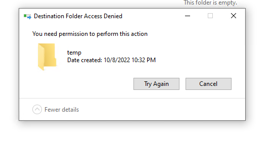

Certainly the new integration of the VirtioFS is exciting. I upgraded to 6.11.1 with no problems. I got VirtioFS working on a windows 10  vm . I get an unexpected result - I can read all the data I want from the share, I can delete anything I want, I can create folders.....but I can't create files. I tried this on a BTRFS and XFS filesystem. The VM user is one of the approved users for those shares (although that is likely irrelevant because this would bypass all user permissions). Where would I look to start diagnosing this?
I will look into permissions for Windows connections, Can we use this thread to post Viritiofs and Windows issues.
The poster of the thread has already found that with Windows you can only map one mapping. Fix is already in place for multiple but not released.
Looks like Windows is not as mature as Linux.
Edited by SimonF
