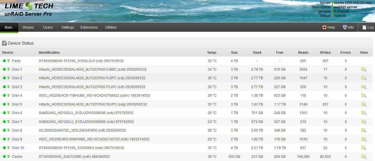

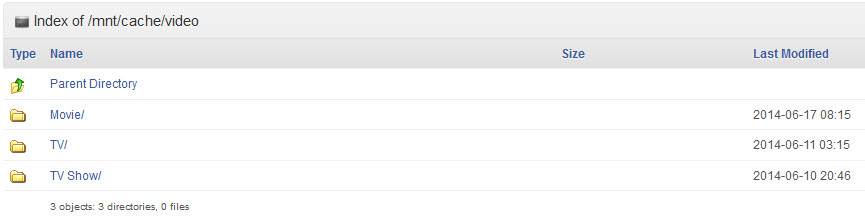

With all that said, mover is still not working on my system.  I'm getting the same warnings that there is not enough space to move files, which is simply incorrect.  What can I provide to help resolve this issue, other than the attached, updated, syslog?
So are you saying there are files in a folder that should be moved that are not? If you specify a share to be cache only, as you did with your downloads, it will leave the files on the cache drive. Messages in the syslog about those files aren't relevant, as the function is proper, it didn't move them.
There are two different issues at play here, and it is unclear to me which one you are addressing. Are there files in a share set to use the cache in the traditional sense that are not being moved? Or are you complaining about the syslog enumerating the files in a cache only share?
I would suggest that screenshots of the main page (so we can see current overall disk status) and the settings for the shares that seem to be having problems.

Yes, the problem is with files that should be moved (NOT in the download directory), that are still not being moved.  You can see the long list of errors at the end of the most recent syslog file I attached a few posts back.
Also attached are the screenshots of the main page, and also of the cache/video directory, showing when the 3 directories were last modified.  All files in these 3 directories should be moved by mover, as they are not in cache only shares.
My guess is a split level setting and/or min free space setting.
No, but your thoughts made me check the share settings, and I discovered that somehow, the video share had gotten changed to be cache only.  I have no idea how, or when this happened, as I've had this drive setup for years.
Anyway, it turns out to be (stupid) user error, so sorry for clogging the release thread with my non-bug issue :(
Mover is running now, and working fine again.  I will retreat to my cave, and try to wash the shame off me as best I can.
Thanks for the help.
