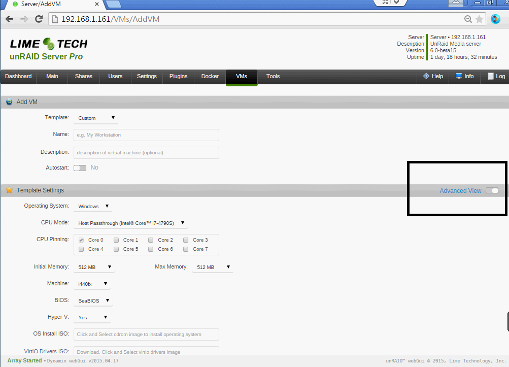

I created a new windows vm using the gui and could not get studio pass through to work. In windows there were no audio devices find and HD audio bus driver had issues (yellow triangle). I tried reinstalling drivers and changing video cards with the same result. I manually changed the xml to the old way of adding the audio device in the qemu command section.
Anyone else have this issue? I tried it with an hd5450, hd6450, and gt210. Passing through a USB sound card worked fine though.
Please open a defect report. Are you saying the old method with qemu arguments worked for you?
yes. I will open one tonight after work. Thanks.

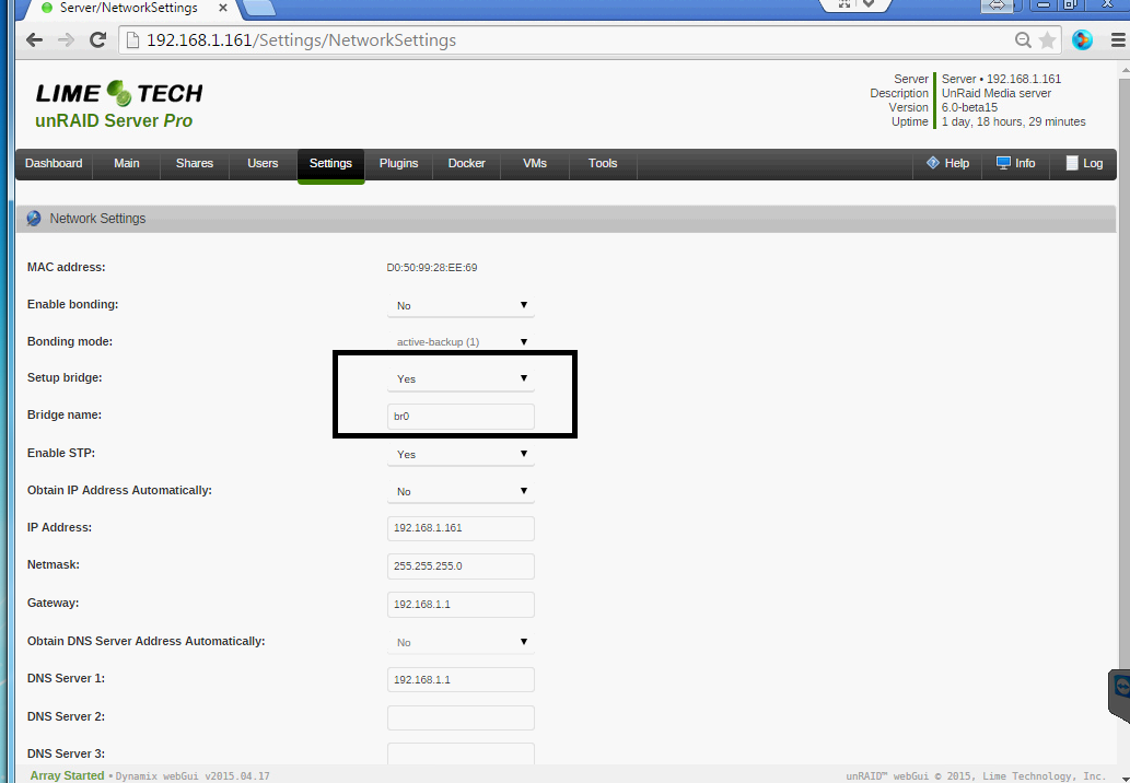

Can anyone give me an example of what needs doing to setup an alternate bridge which allows my VMs to be seen by my local network?
I can't seem to find 'Advanced Mode' referenced.
Also ... how does this hang together, can i just use any old bridge name, say 'MyBr' and declare it to xml?
first under the settings tab then network and turn on bridge mode and you should see bridge name I put in br0
then go under settings again then vmmanager you have to stop it and then fill in the Alternate Network Bridge to match mine is br0
start it again, any new VM will now have that filled in and you can see local network.
any existing machines you can edit the vm and just change the bridge to br0, mine was originally vitbr0
Screens attached, advanced mode is not too obvious unless you really look, the network bridge is under settings, network settings.
Also, basically, yes.
