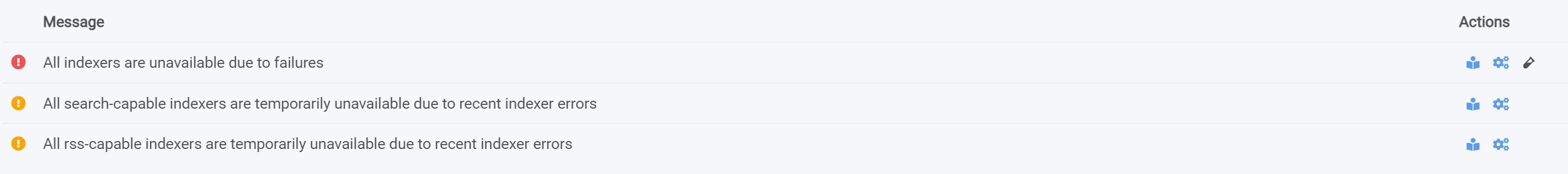

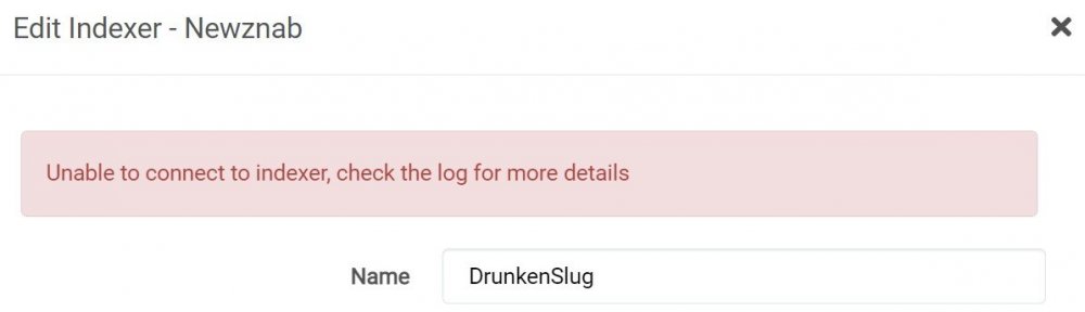

It seems that every day at least once my indexers go down (for both Sonarr and Radarr) and I can't seem to figure out how to get them back up.  I am able to log into the website with no issue but when I test it, I get an error.  Any suggestions?

I am still seeing this issue. where you able to find a solution?
This is a lot like my issue. check you sonarr log and see what errors there are. i will share any fix i find if your issue is like mine.

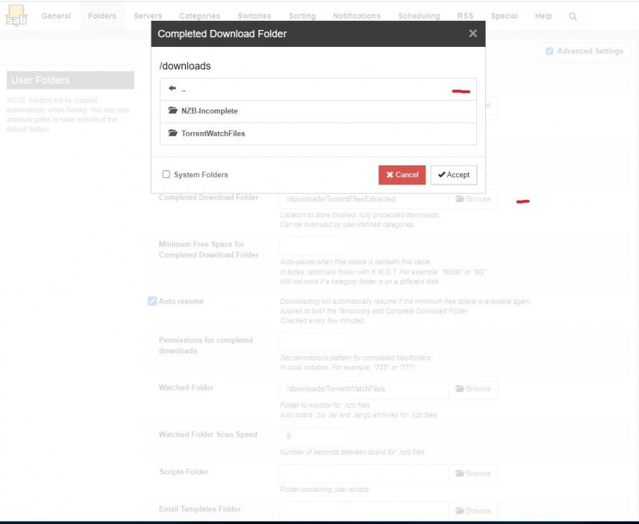

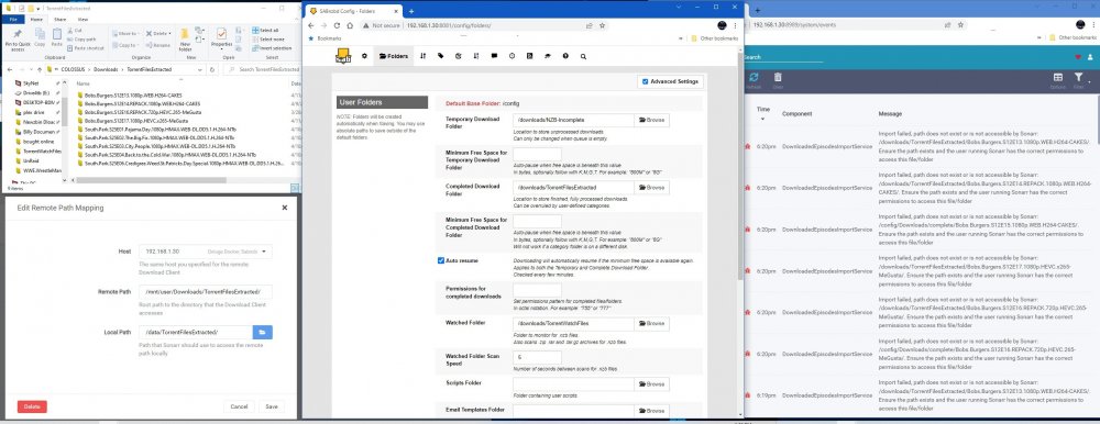

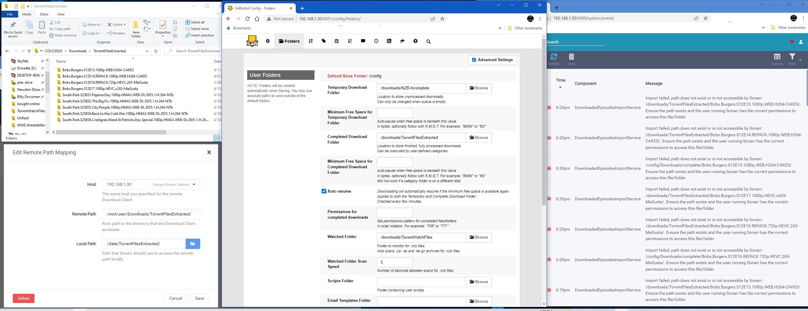

hello, i have been searching and trying to resolve this issue with sonarr, i have setup Sonarr and SABnzbd and there download paths but after the video is downloaded sonarr gives me this error:

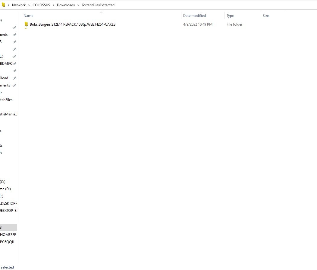

Import failed, path does not exist or is not accessible by Sonarr: /downloads/TorrentFilesExtracted/Bobs.Burgers.S12E14.REPACK.1080p.WEB.H264-CAKES/. Ensure the path exists and the user running Sonarr has the correct permissions to access this file/folder
here are some of my setup info:
Sonarr (docker settings) using network: bridge
Host Path 2:
/mnt/user/Downloads/TorrentFilesExtracted/
Container Path: /data
Host Path 3:
/mnt/disk1/Tv Shows/Shows/
Container Path: /media
key 1: 000 ,Key 2: PUID 99 ,Key 3: PGID 100,
AppData Config Path:
/mnt/user/appdata/binhex-sonarr
Container Path: /config
Sonarr (App settings) Everything connects and triggers downloads to the /downloads/TorrentFilesExtracted(pic2)
the files are there but nothing else is done or moved to my plex folder  /mnt/disk1/Tv Shows/Shows/

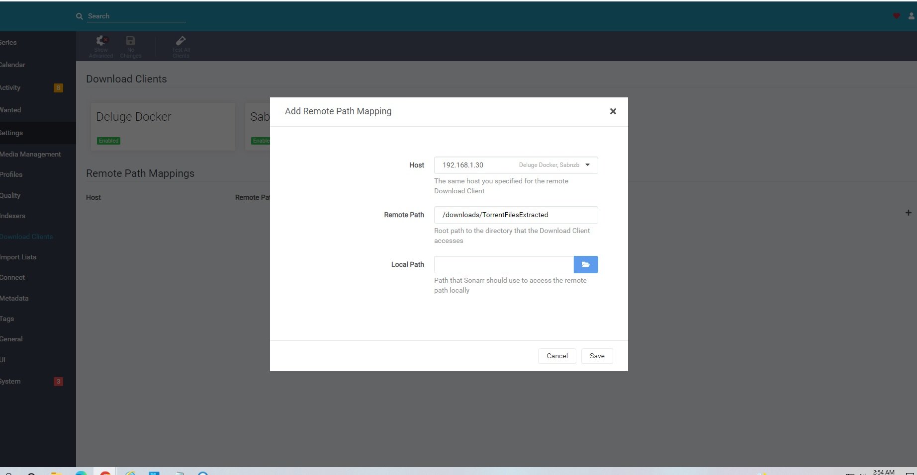

i went to Sonarr/ settings/download clients/
i tried to configure the remote path mappings: (pic1) but the local path (Path that Sonarr should use to access the remote path locally) will not allow me to find the local path for downloads/TorrentFilesExtracted/  folder?
(pics attached)
Looking at this info can someone find my problem, i am new to unraid and so im following guides to get this done
Thanks

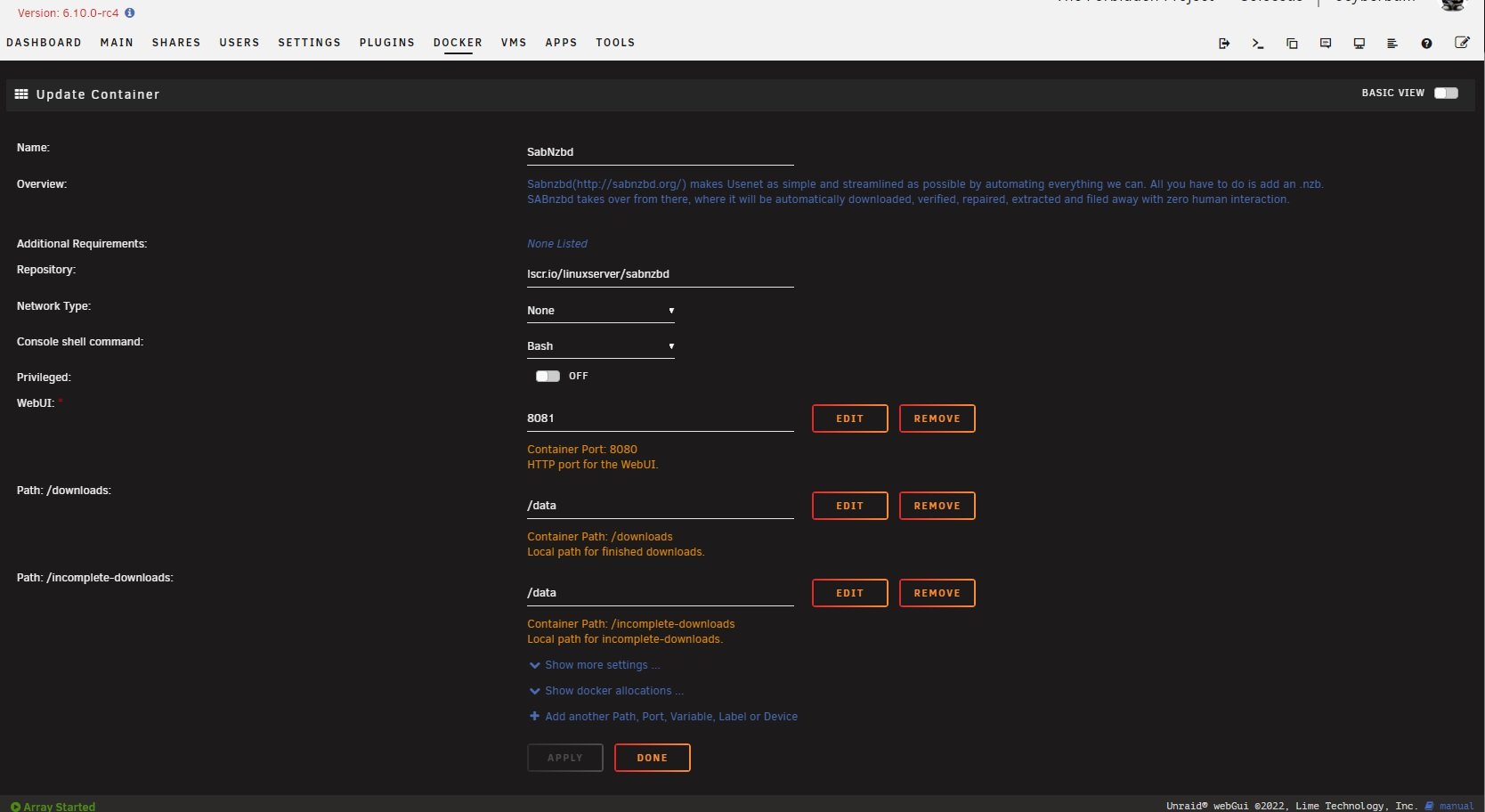

SABnzbd (Docker settings) using network: none and extra parameters --net=container:GluetunVPN  for NordVPN
Path: /downloads:
Container Path: /downloads
Local path for finished downloads
Path: /incomplete-downloads:
Container Path: /incomplete-downloads
Local path for incomplete-downloads
Appdata:
/mnt/user/appdata/sabnzbd
Local path for sabnzbd config files
PUID 99 ,PGID 100, unmask: 022

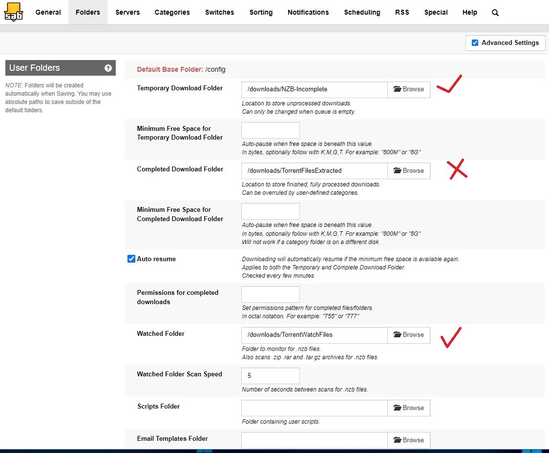

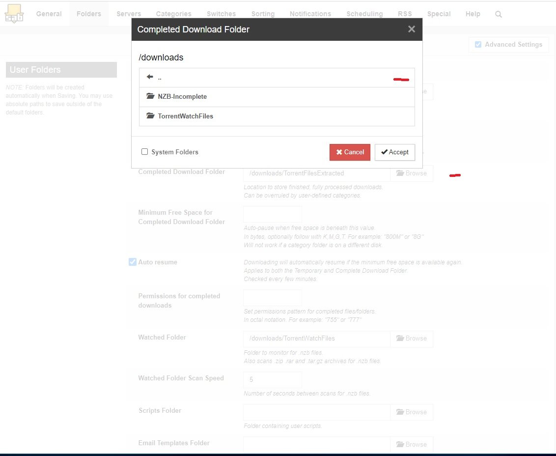

SAB 3.5.3 [bca9f3b] App Settings: 192.168.1.30:8081
SAB/Folders
Default Base Folder: /config
Temporary Download Folder    /downloads/NZB-Incomplete
Completed Download Folder   /downloads/TorrentFilesExtracted
The container paths for for downloads in Sab and Sonarr must match. Make both /data and then change the download location in the Sab settings for completed downloads to /data.
Never any reason to use remote path mappings, ever.  As @wgstarks stated, add in the exact same /data mappings to both containers (with identical host paths)  (or use /downloads instead the same way)

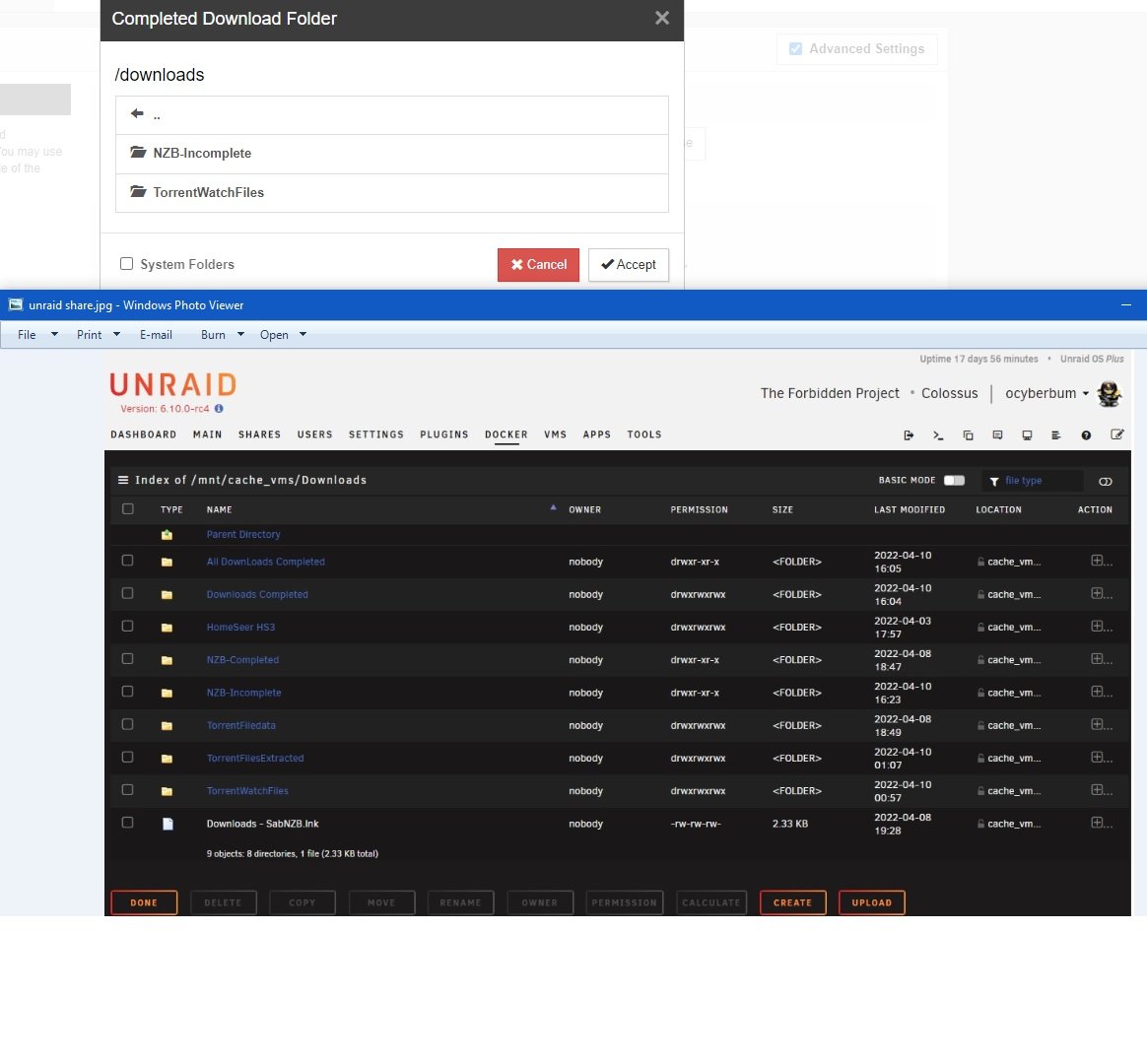

ok i changed the container paths in SAB to /data and tried /downloads, The problem i have is when i go to SAB to change the folders paths it only shows two of the folders on my share , the NZB-incomplete, and TorrentWatchFiles, all the other folders are missing in the share like the one i wanted to use called /downloads/TorrentFilesExtracted  i changed folders permissions, renamed them and added folders to the share directory, also inside a working folder like NZB-Incomplete but they do not show up or show updated changes in SAB, so im still stumped on what i have done wrong and certain folders are missing
The host path and container path for sab and sonarr must match exactly. For yours you would set /mnt/user/Downloads as the host path for BOTH and /data for the container path for BOTH. If you set the other locations as sub folders in /data it will simplify the setup I think and you'll only need one user share. You can substitute /downloads in place of /data but you must also do that for both.
Edited by wgstarks
spellcheck typos
Example: If you set incomplete downloads to /data/incomplete in sab settings it will create the folder /mnt/user/Downloads/incomplete in your user share. Same for any other folders you want to use. IE watch, completed_downloads etc.

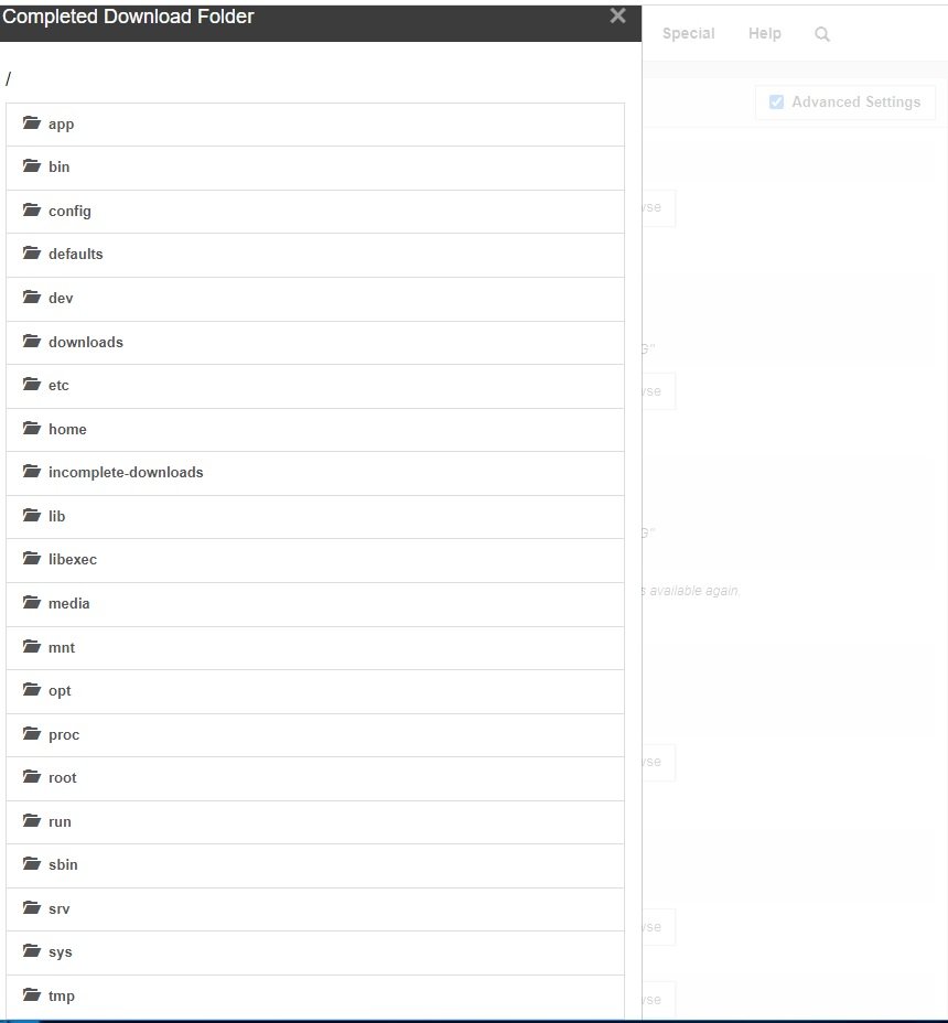

i believe i made the changes you said wgstarks, i am not sure what i still missed...... i have never had this much issue with folders but i attached my changes and the sonar error i get1273418630_unraidallerrors4-11.thumb.jpg.8904b53bee9063e916097eec9b998eb2.jpg
Delete any remote path mappings you have configured. They're not needed.
After that post your docker run command for Sab and Sonarr dockers and we'll start from there. Also, it's optional to create the user share for your torrents (but you can if you want). The dockers will create any subfolders that you have created in they're settings. no changes to permissions should be required and could possibly bork the docker.
Edited by wgstarks
i cleared the one in sonarr but the 3 folders in NZB will not let me clear them gives "error unc path not allowed", at this point i can reinstall it all if this would simplify it

27 minutes ago, ocyberbum said:
-v '/mnt/user/Downloads/':'/data':'rw'
Change this Sonarr container path from /data to /downloads so that it matches the Sab docker. Also see the note below about the Sab path.
29 minutes ago, ocyberbum said:
-v '/mnt/user/Downloads/':'/downloads':'rw' -v '/mnt/user/Downloads/':'/incomplete-downloads':'rw
This is probably optional but I would add another directory to these two paths in Sab just to keep things organized. If you want everything in the same folder then you can leave it as is.
/mnt/user/Downloads/completed-downloads/ (and set the host path in Sonarr (above) to match) and /mnt/user/Downloads/incomplete-downloads/
ok, i think i finally have it worked out?? .  thanks to everyone's feedback and wgstarks  for not giving up!! but i ended up installing another version and started over to find out that the issues were the links created in sonarr paths and series import paths ,
when i first imported shows and  setup docker paths, my paths were incorrect, After wgstarks help me correct those paths in sonarr and NZB, i also needed to change those paths assigned to all the series in my plex folder by sonarr during setup, after that i had to modify how sonarr was importing and creating folders and files ,  the way i had my folder structure in my plex shows didn't match sonarrs media management under settings ,.. so there were seasons in different named folders and paths when downloading , and old paths i had changed
For my solution i fixed all the paths in sonarr and nzb to match a folder called downloads and the sub folders completed/ incompleted etc on my disk, then I created a 2nd tv shows folder for plex and manually added a new series to make sure the paths and naming were the way i wanted it. I will now add a few from my main plex tv folder to make sure the series is processed without errors!! before i add all of them in my main plex tv folder, If your new to this and having issues like i was this might be another way to sort it out
thanks again ! and now on to Prowlarr and movies!!
