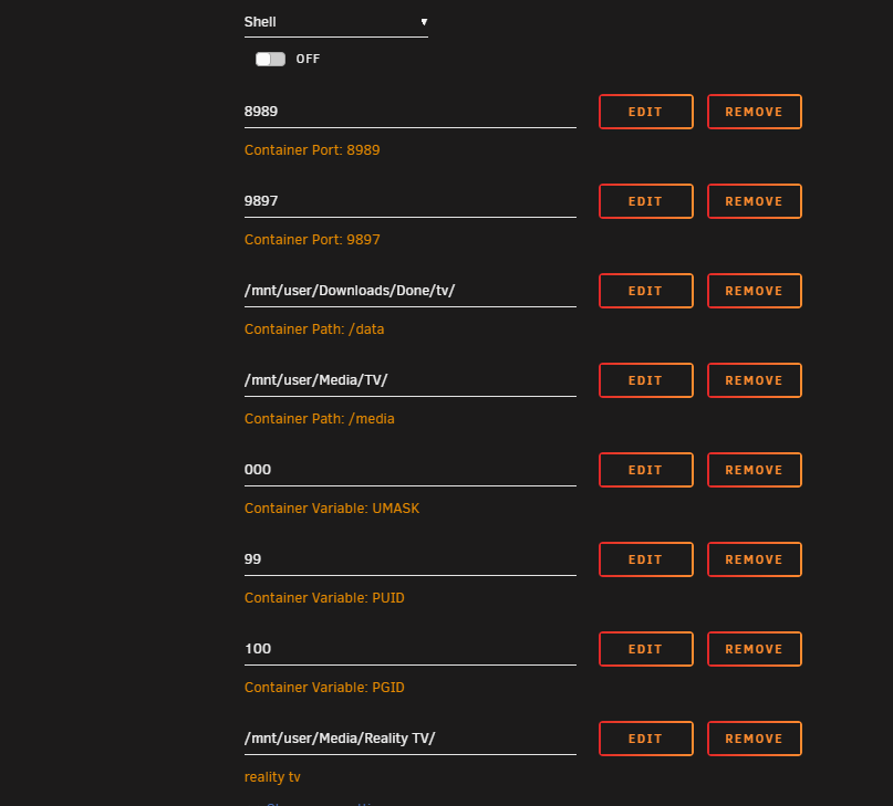

Having an issue for a while, but just have some time to ask for help.  Log is showing a ton of these:
1-6-15 09:12:13.9|Error|DownloadedEpisodesImportService|Import failed, path does not exist or is not accessible by Sonarr: /data/Done/tv/                 *Ensure the path exists and the user running Sonarr has the correct permissions to access this file/folder.
What have I missed?
16 minutes ago, ZosoPage1963 said:
What have I missed?
What is the mapping for /data on your torrent or usenet application?
think that was it.. thank you... I had it as /mnt/user/Downloads/ so I added /Done at the end.
But you have /mnt/user/Downloads/Done/tv/ in your screenshot. The whole path must match on both sides.
TV is a subfolder, Done includes Sonarr, Radarr, and Lidarr... Radarr is Done/Movies, Lidarr is /Done/Music.. does that make sense?  I use SAB
Edited by ZosoPage1963
it may make sense but until /data paths are identical for all containers then you will run into issues, my advise would be change /data mapping to be '/mnt/user/Downloads/Done' set this for all containers that use /data and your problem will be resolved.
Got it...making that happen and I am sure you all are right... didn't mean to doubt.  Thanks a ton!
configured all containers correctly and confirmed no other issues... thanks again.
fixed

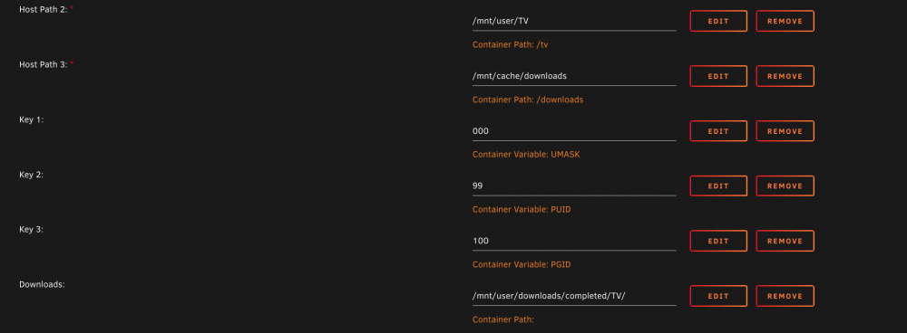

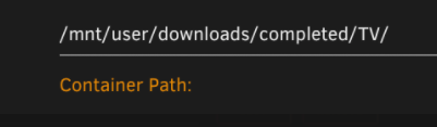

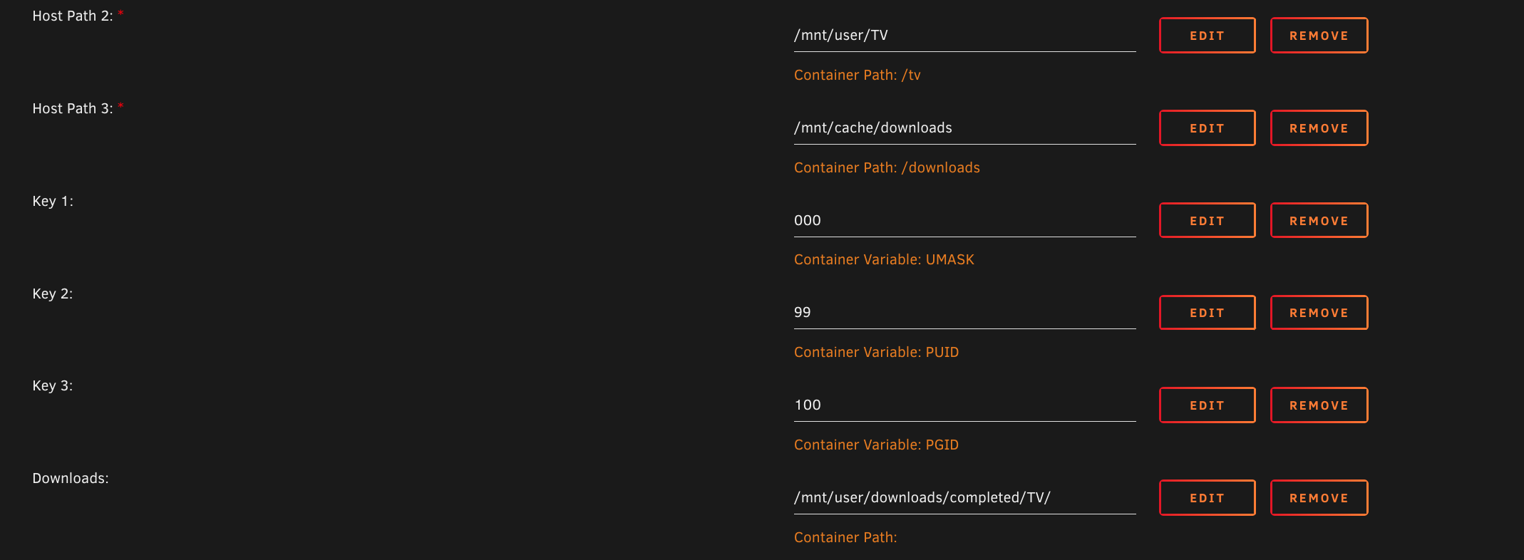

After years of using a different program in unRAID, I am trying to switch to Sonarr.
I have mapped my paths so they are the same from the other program
But I keep getting this error in Sonarr which I don't understand.
Error] DownloadedEpisodesImportService: Import failed, path does not exist or is not accessible by Sonarr: /data/TV/xxx/. Ensure the path exists and the user running Sonarr has the correct permissions to access this file/folder
both halves of the mapping?

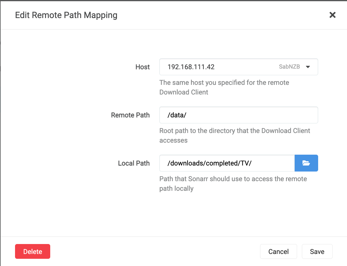

I am attaching screen shots of the Sonarr docker mappings as well as a screen shot of the remote path mappings for download clients in Sonarr.
I'm not sure where I am going wrong and why this error is showing up
remove that.
If you have your container paths matched between the download client and sonarr, you don't need remote paths set up in sonarr.
