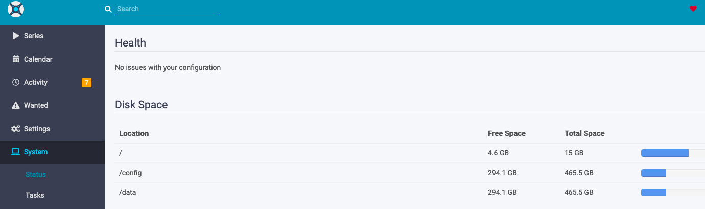

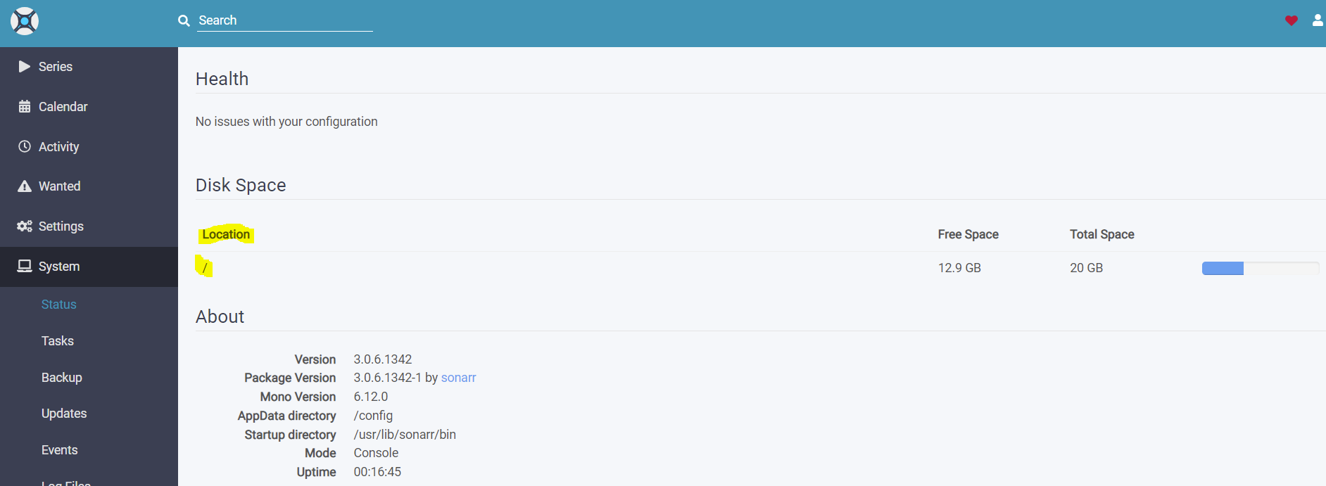

On 1/23/2022 at 1:53 PM, GameOutlaw said:
Any idea why this is showing up as "/" for the location in Sonarr Disk Space. Also the mapped mount share is 25TB free, not 12.9GB.
The root of the docker container (/) is your docker.img (Unraid->Settings->Docker->Docker vDisk location).
The mapped storage should also show up as separate entries, see screenshot from my Sonarr below. Not sure why your's aren't, I can't find any settings related to this in Sonarr itself.
1187349420_ScreenShot2022-01-26at10_07_32am.thumb.png.c67145a25c14dea58b544014c25e2f4f.png

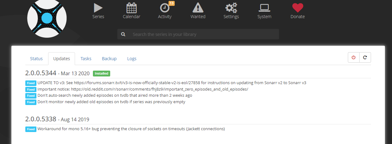

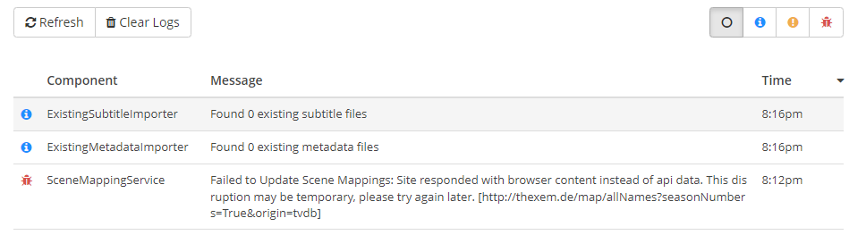

I was in Sonarr and I noticed that an update was available and so I installed it. However, now it is having errors when trying to read the TVDB, any ideas on how to fix this?
SceneMappingServiceFailed to Update Scene Mappings: Site responded with browser content instead of api data. This disruption may be temporary, please try again later. [http://thexem.de/map/allNames?seasonNumbers=True&origin=tvdb]7:05pm
SceneMappingServiceUpdating Scene mappings7:05pm
XemServiceFailed to update Xem series list.: Site responded with browser content instead of api data. This disruption may be temporary, please try again later. [http://thexem.de/map/havemap?origin=tvdb]
How did you install the update?
From within SONARR. In used to be set to the 2019 version with the option to install the mar 13 2020 version, which stupidly I accepted.
It’s best to wait for the updated docker image. Go to the docker tab on your server and delete the binhex-Sonarr docker along with the image. On the apps tab go to previous apps>docker and reinstall the binhex-Sonarr docker. This should install the latest version or the one you had tagged if you’re using a specific version.

or simpler still, left click edit sonarr icon, change something, change it back to what it was, scroll to the bottom and click apply, this will delete the now duff container and re-create it and you should be back to a good state.

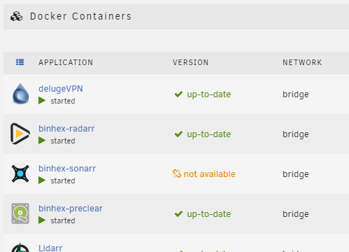

Getting this warning message -
This image is now based on Alpine. Custom scripts using apt-get will need to be updated to use apk
Safe to ignore?

Wondering if this is related?
nope, completely different, not sure whats causing your issue there but the image is available on Docker Hub, try checking internet connectivity on unraid host and/or rebooting.
Strange. I just rebooted server and same message.

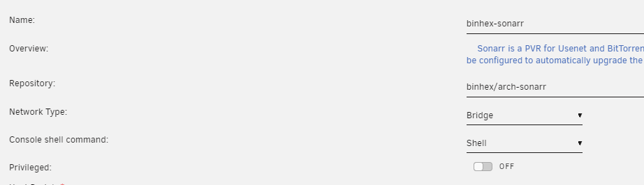

EDIT: I deleted the container and added it back and problem solved.
Edited by betaman
On 3/14/2022 at 2:33 PM, binhex said:
none of my images use Alpine, so i assume you are in the wrong support thread, that is most likely a LSIO/Hotio image you are running.
Apologies, even though I'm using binhex-sonarr I seem to have changed the repository to
linuxserver/sonarr:develop
at some point.
Is there a safe method of changing back?
Thanks.
EDIT: Backed up and then just changed the repo back to binhex-sonar.
Edited by Hitcher
