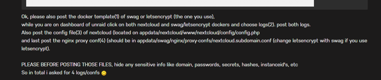

AGAIN, i'm asking also for LOGS which i explained where to get them 3-4 posts above. The reason i ask also for Reverse proxy config/logs is, if you have 'overwritehost' => nc.domain.com, with will redirect you to your reverse proxy.
Please if you need help, provide the asked info. otherwise is like asking us to GUESS what it MIGHT be going on.
Also post the docker temp/logs of your database

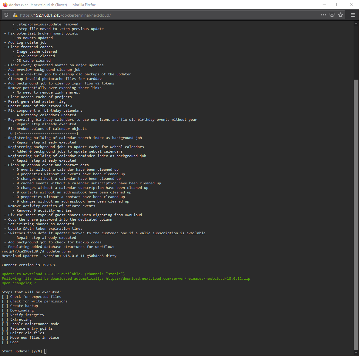

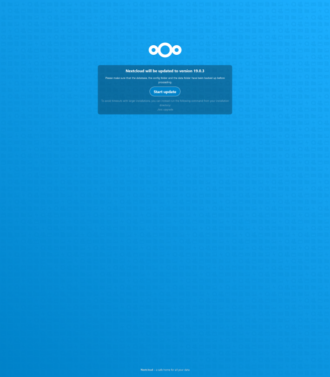

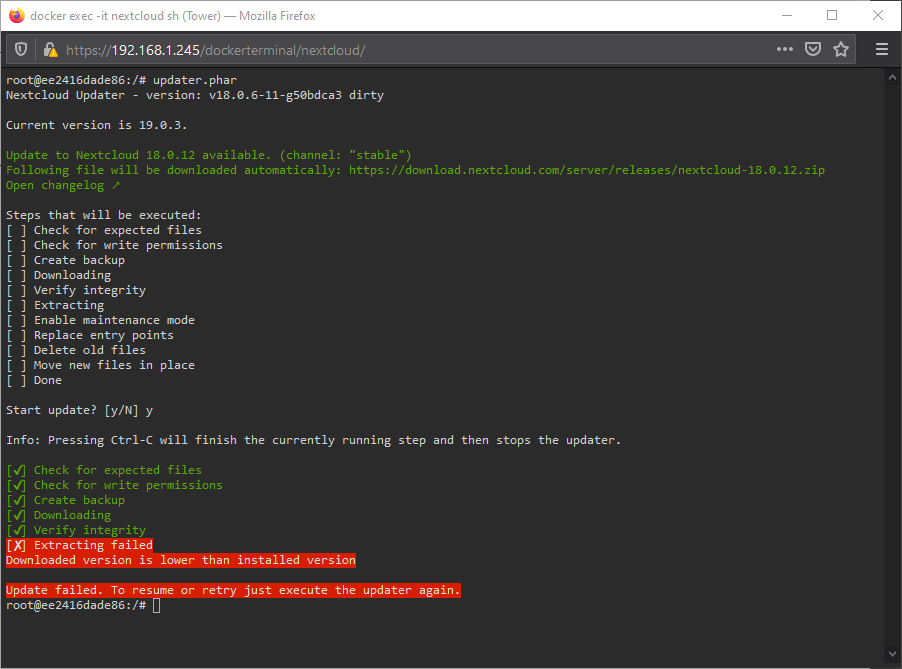

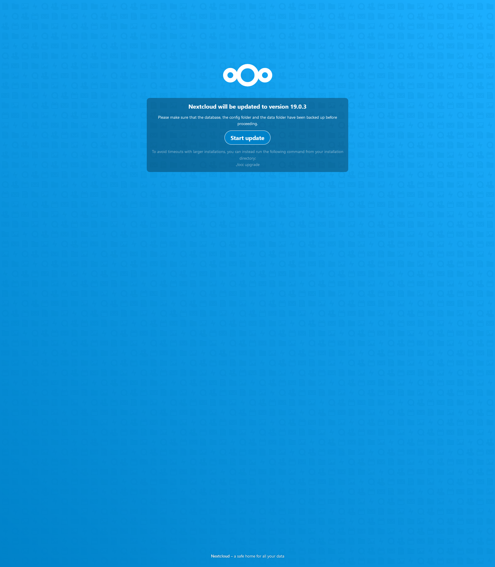

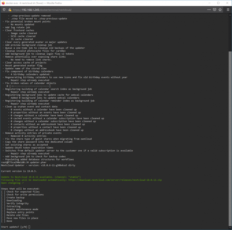

Attempting to update from 19.0.3 to 19.0.6 (what the GUI says is available).  Have tried GUI method a few times over the last month and it always fails.
Tried the manual method today and it continues to fail.  Below is the error it gives.
I'm also unable to now login to the GUI.  Slightly concerned but am sure someone here can point the way.  Attached is a screenshot of the GUI.  Clicking "start update" give the same error listed below copied from the command line.
Also added a screenshot after running the repair & updater commands from a few pages back.  It shows I'm on 19.0.3 but trying to update to 18.0.12.  So now I'm really confused.
ETA: I added a new screenshot while trying to update via command line.  Any help on this would be great.
Thanks
Linux 4.19.107-Unraid.
Last login: Sat Jan  2 14:04:38 -0600 2021 on /dev/pts/2.
root@Tower:~# docker exec -it nextcloud occ upgrade
Nextcloud or one of the apps require upgrade - only a limited number of commands are available
You may use your browser or the occ upgrade command to do the upgrade
Set log level to debug
Updating database schema
Updated database
Checking for update of app accessibility in appstore
Checked for update of app "accessibility" in appstore
Checking for update of app activity in appstore
Checked for update of app "activity" in appstore
Checking for update of app bruteforcesettings in appstore
Checked for update of app "bruteforcesettings" in appstore
Checking for update of app calendar in appstore
Checked for update of app "calendar" in appstore
Checking for update of app cloud_federation_api in appstore
Checked for update of app "cloud_federation_api" in appstore
Checking for update of app comments in appstore
Checked for update of app "comments" in appstore
Checking for update of app contactsinteraction in appstore
Checked for update of app "contactsinteraction" in appstore
Checking for update of app dav in appstore
Checked for update of app "dav" in appstore
Checking for update of app federatedfilesharing in appstore
Checked for update of app "federatedfilesharing" in appstore
Checking for update of app federation in appstore
Checked for update of app "federation" in appstore
Checking for update of app files in appstore
Checked for update of app "files" in appstore
Checking for update of app files_pdfviewer in appstore
Checked for update of app "files_pdfviewer" in appstore
Checking for update of app files_rightclick in appstore
Checked for update of app "files_rightclick" in appstore
Checking for update of app files_sharing in appstore
Checked for update of app "files_sharing" in appstore
Checking for update of app files_trashbin in appstore
Checked for update of app "files_trashbin" in appstore
Checking for update of app files_versions in appstore
Checked for update of app "files_versions" in appstore
Checking for update of app files_videoplayer in appstore
Checked for update of app "files_videoplayer" in appstore
Checking for update of app firstrunwizard in appstore
Checked for update of app "firstrunwizard" in appstore
Checking for update of app logreader in appstore
Checked for update of app "logreader" in appstore
Checking for update of app lookup_server_connector in appstore
Checked for update of app "lookup_server_connector" in appstore
Checking for update of app nextcloud_announcements in appstore
Checked for update of app "nextcloud_announcements" in appstore
Checking for update of app notifications in appstore
Checked for update of app "notifications" in appstore
Checking for update of app oauth2 in appstore
Checked for update of app "oauth2" in appstore
Checking for update of app password_policy in appstore
Checked for update of app "password_policy" in appstore
Checking for update of app photos in appstore
Checked for update of app "photos" in appstore
Checking for update of app privacy in appstore
Checked for update of app "privacy" in appstore
Checking for update of app provisioning_api in appstore
Checked for update of app "provisioning_api" in appstore
Checking for update of app recommendations in appstore
Checked for update of app "recommendations" in appstore
Checking for update of app serverinfo in appstore
Checked for update of app "serverinfo" in appstore
Checking for update of app settings in appstore
Checked for update of app "settings" in appstore
Checking for update of app sharebymail in appstore
Checked for update of app "sharebymail" in appstore
Checking for update of app support in appstore
Checked for update of app "support" in appstore
Checking for update of app survey_client in appstore
Checked for update of app "survey_client" in appstore
Checking for update of app systemtags in appstore
Checked for update of app "systemtags" in appstore
Checking for update of app text in appstore
Checked for update of app "text" in appstore
Checking for update of app theming in appstore
Checked for update of app "theming" in appstore
Checking for update of app twofactor_backupcodes in appstore
Checked for update of app "twofactor_backupcodes" in appstore
Checking for update of app twofactor_totp in appstore
Checked for update of app "twofactor_totp" in appstore
Checking for update of app twofactor_u2f in appstore
Checked for update of app "twofactor_u2f" in appstore
Checking for update of app updatenotification in appstore
Checked for update of app "updatenotification" in appstore
Checking for update of app viewer in appstore
Checked for update of app "viewer" in appstore
Checking for update of app workflowengine in appstore
Checked for update of app "workflowengine" in appstore
An unhandled exception has been thrown:
Error: Class 'Doctrine\DBAL\Types\Types' not found in /config/www/nextcloud/apps/user_status/lib/Migration/Version0001Date20200602134824.php:52
Stack trace:
#0 /config/www/nextcloud/lib/private/DB/MigrationService.php(478): OCA\UserStatus\Migration\Version0001Date20200602134824->changeSchema(Object(OC\Migration\SimpleOutput), Object(Closure), Array)
#1 /config/www/nextcloud/lib/private/DB/MigrationService.php(414): OC\DB\MigrationService->executeStep('0001Date2020060...', false)
#2 /config/www/nextcloud/lib/private/Installer.php(587): OC\DB\MigrationService->migrate()
#3 /config/www/nextcloud/lib/private/Installer.php(541): OC\Installer::installShippedApp('user_status')
#4 /config/www/nextcloud/lib/private/Updater.php(266): OC\Installer::installShippedApps(true)
#5 /config/www/nextcloud/lib/private/Updater.php(130): OC\Updater->doUpgrade('19.0.3.1', '18.0.1.3')
#6 /config/www/nextcloud/core/Command/Upgrade.php(255): OC\Updater->upgrade()
#7 /config/www/nextcloud/3rdparty/symfony/console/Command/Command.php(255): OC\Core\Command\Upgrade->execute(Object(Symfony\Component\Console\Input\ArgvInput), Object(Symfony\Component\Console\Output\ConsoleOutput))
#8 /config/www/nextcloud/3rdparty/symfony/console/Application.php(1012): Symfony\Component\Console\Command\Command->run(Object(Symfony\Component\Console\Input\ArgvInput), Object(Symfony\Component\Console\Output\ConsoleOutput))
#9 /config/www/nextcloud/3rdparty/symfony/console/Application.php(272): Symfony\Component\Console\Application->doRunCommand(Object(OC\Core\Command\Upgrade), Object(Symfony\Component\Console\Input\ArgvInput), Object(Symfony\Component\Console\Output\ConsoleOutput))
#10 /config/www/nextcloud/3rdparty/symfony/console/Application.php(148): Symfony\Component\Console\Application->doRun(Object(Symfony\Component\Console\Input\ArgvInput), Object(Symfony\Component\Console\Output\ConsoleOutput))
#11 /config/www/nextcloud/lib/private/Console/Application.php(215): Symfony\Component\Console\Application->run(Object(Symfony\Component\Console\Input\ArgvInput), Object(Symfony\Component\Console\Output\ConsoleOutput))
#12 /config/www/nextcloud/console.php(100): OC\Console\Application->run()
#13 /config/www/nextcloud/occ(11): require_once('/config/www/nex...')
#14 {main}root@Tower:~#
Edited by ur6969
2 hours ago, Ashashaneil said:
Anyone have any ideas on how I can upgrade from v18 to the latest version?
When you do the updates you have to go through them sequentially. So if you are on 18.02, updates will probably want you to go to 18.09 first. It will then offer 19.06 which was the last version of v19 and then it will proceed to 20.04.
I found you have to do some database fixes along the way to get the green check tick.

15 minutes ago, BrunoVic said:
I don't have 'overwritehost' => nc.domain.com. I could have told you this. So trust me when I say that I was able to access it through both the IP:PORT and the domain name. SECOND I told you 4, 5, 6 or I don't know HOW many post before for God knows HOW MANY times that I don't know HOW TO FIND THE LOGS to provide to you. Maybe if you told me where the freaking logs were I would give them to you! I mean I started off my first post saying I don't know how to get the logs nor do I know where they are. Why is this detail that I continually repeat missed consistently?
you may should consider the art you ask for help, starting with help NOW ... we are here mostly for fun and a helping each other as users ...
about your logs
- click on the docker symbol, click LOG ... a window appear with the current running docker logs
- about nextcloud nginx logs, take a look at your appdata folder, log, nginx ...
these are startpoints where to look, as nextcloud usually is running behind a reverse proxy, thats why there was the question about the reverse proxy logs, but you should find them yourself, and thats about it from me to help with this kinda attitude.
I can't know if you can answer a config specific question if you cant even find logs which they are easily accessible from the GUI.
The location for the things i asked is on the bottom of this post. 5 days ago.
Please read the answers and remember people here are doing it for FREE. If you want in the feature help in the forums, first don't use that attitude and second, do some research.  I'm pretty sure with a simple google search you can find where the logs are.
Anyway, if you manage to find the logs. Post them and we'll try to see what the problem is.
Edited by skois
Added screenshot of the mentioned post, to find it faster

I upgraded from 19 to 20 via browser and now its stuck on "Update in process".
I only see this on the logs a bunch of times.
Could not open input file: /config/www/nextcloud/cron.php
