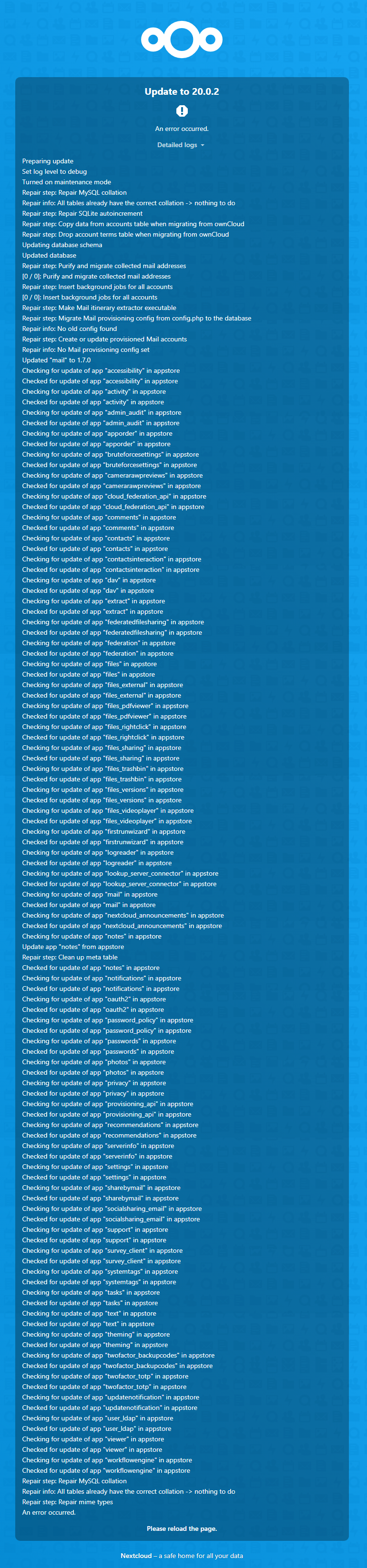

i have an error in the Update. I have startet it from updater.phar.
Here are the Errors
PHP Warning:  rmdir(/config/www/nextcloud/apps/comments/composer/composer): Directory not empty in phar:///config/www/nextcloud/updater/updater.phar/lib/Updater.php on line 772
PHP Warning:  rmdir(/config/www/nextcloud/apps/comments/composer): Directory not empty in phar:///config/www/nextcloud/updater/updater.phar/lib/Updater.php on line 772
PHP Warning:  rmdir(/config/www/nextcloud/apps/comments/l10n): Directory not empty in phar:///config/www/nextcloud/updater/updater.phar/lib/Updater.php on line 772
PHP Warning:  rmdir(/config/www/nextcloud/apps/comments/img): Directory not empty in phar:///config/www/nextcloud/updater/updater.phar/lib/Updater.php on line 772
PHP Warning:  rmdir(/config/www/nextcloud/apps/comments/lib/Listener): Directory not empty in phar:///config/www/nextcloud/updater/updater.phar/lib/Updater.php on line 772
PHP Warning:  rmdir(/config/www/nextcloud/apps/comments/lib/Collaboration): Directory not empty in phar:///config/www/nextcloud/updater/updater.phar/lib/Updater.php on line 772
PHP Warning:  rmdir(/config/www/nextcloud/apps/comments/lib/Activity): Directory not empty in phar:///config/www/nextcloud/updater/updater.phar/lib/Updater.php on line 772
PHP Warning:  rmdir(/config/www/nextcloud/apps/comments/lib/AppInfo): Directory not empty in phar:///config/www/nextcloud/updater/updater.phar/lib/Updater.php on line 772
PHP Warning:  rmdir(/config/www/nextcloud/apps/comments/lib/Controller): Directory not empty in phar:///config/www/nextcloud/updater/updater.phar/lib/Updater.php on line 772
PHP Warning:  rmdir(/config/www/nextcloud/apps/comments/lib/Notification): Directory not empty in phar:///config/www/nextcloud/updater/updater.phar/lib/Updater.php on line 772
PHP Warning:  rmdir(/config/www/nextcloud/apps/comments/lib/Search): Directory not empty in phar:///config/www/nextcloud/updater/updater.phar/lib/Updater.php on line 772
PHP Warning:  rmdir(/config/www/nextcloud/apps/comments/lib): Directory not empty in phar:///config/www/nextcloud/updater/updater.phar/lib/Updater.php on line 772
PHP Warning:  rmdir(/config/www/nextcloud/apps/comments/appinfo): Directory not empty in phar:///config/www/nextcloud/updater/updater.phar/lib/Updater.php on line 772
PHP Warning:  rmdir(/config/www/nextcloud/updater/../apps/comments): Directory not empty in phar:///config/www/nextcloud/updater/updater.phar/lib/Updater.php on line 775
Here the Output from the maintenance:repair

But the website says: "Update in process." What can i do?
i solved the problem. I followed the manuel update instructions.
Thanks for the manuel!

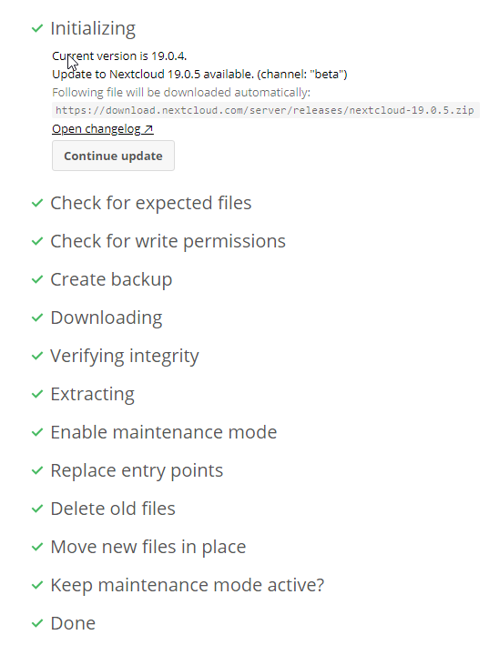

Need help got stuck trying to update to 20.0.2 and I had to restore from backup.
I unpacked the Maria DB and the appdata for Nextcloud and got it up and running again!

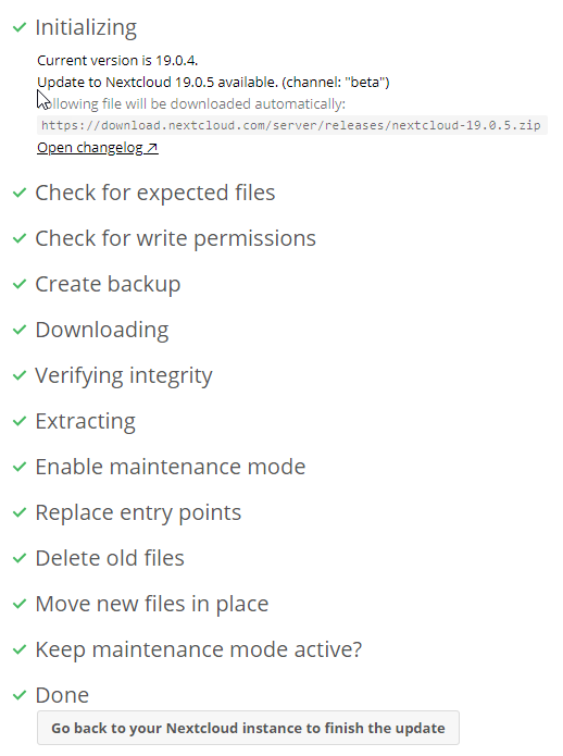

BUT Nextcloud wants to upgrade to:
And every time I try to do this I get this:
And when I push continue update....
I get the "Go back..." and then I am back to Home page of Nextcloud?
I also tried:
Same thing no difference?
Appreciate any input you might have to rectify this problem?

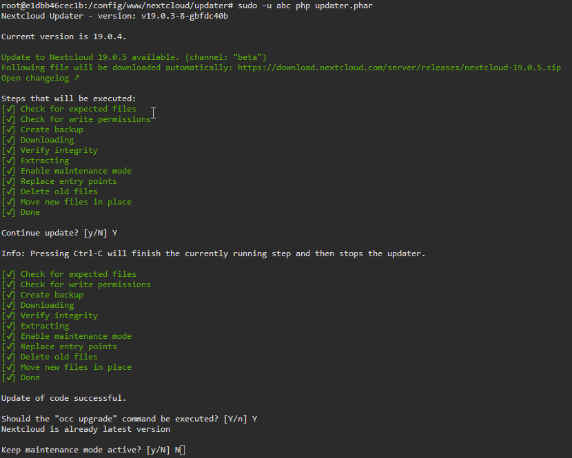

Update: Running the repair:
sudo -u abc php /config/www/nextcloud/occ maintenance:repair
sudo -u abc php updater.phar
Fixed the upgrade... Not sure I want to try upgrading a 2 time for 20.0.2
ARGH failed again.....
Any input on what to try

Edited by casperse
Solved by running:
cd /config/www/nextcloud/updater/
sudo -u abc php /config/www/nextcloud/occ upgrade
sudo -u abc php /config/www/nextcloud/occ db:add-missing-primary-keys
