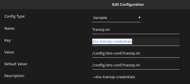

KoNeko Posted May 14, 2021 Share Posted May 14, 2021 (edited) Swap stopped renewing my Letsencrypt cert since this week. i didnt change anything in the docker or any config file of this docker. i do it via DNS which always worked the credentials are in the ini file at that location. Failed to renew certificate .nl with error: Missing properties in credentials configuration file /config/dns-conf/transip.ini: * Property "certbot_dns_transip:dns_transip_key_file" not found (should be RSA key file(convert with openssl rsa -in transip.key -out decrypted_key)). * Property "certbot_dns_transip:dns_transip_username" not found (should be Transip username). - - - - - - - - - - - - - - - - - - - - - - - - - - - - - - - - - - - - - - - - All renewals failed. The following certificates could not be renewed: EDIT: maybe its new or it got removed somehow but after i added and restarted the container its all fixed. Edited May 14, 2021 by KoNeko Fixed the problem Quote Link to comment
