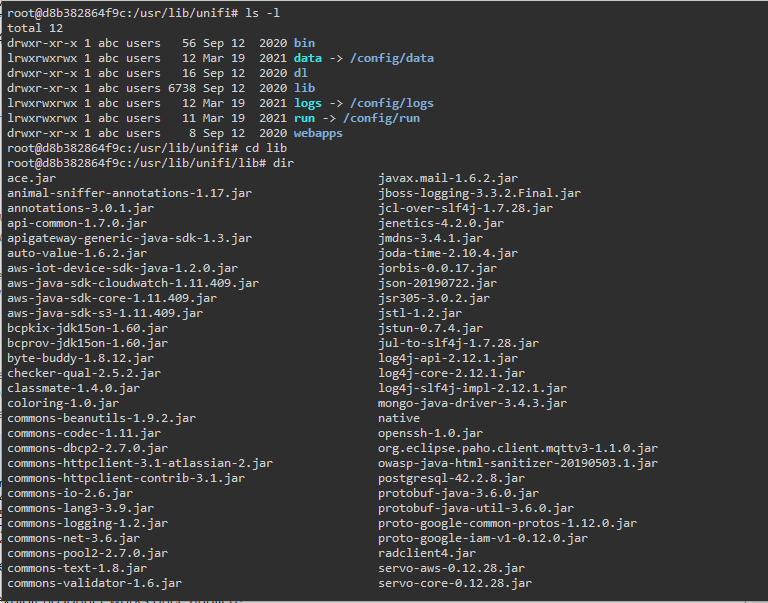

13 minutes ago, wayner said:
Did you manually apply the log4j patch?
Not yet but I assume it is possible by going into the unifi-controller container console and then to the /lib directory.
There you can see the log4j files and replace them as per the instructions you previously posted.  However, any container update may remove this "patch" requiring you to do this all over again.
Edited by Hoopster
But the problem that I am having is that you are supposed to shut down the docker before doing this.  But when I shut down the docker I can't ssh into the docker using the command  "docker exec -it unifi-controller sh".  So how do you overcome this issue?  Sorry if this is a dumb question.
Link to comment

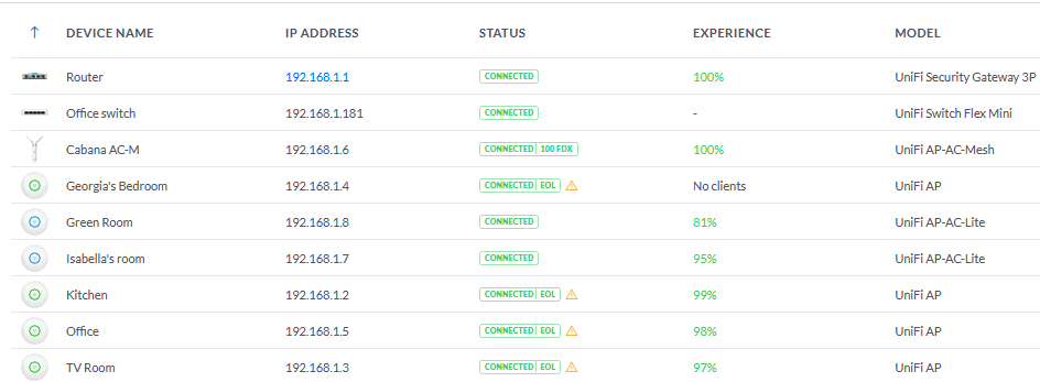

2 hours ago, wayner said:
I am on my way to 6.5.55.  Just upgraded from 5.12.72 to 5.14.23.  Everything looks good.  My old UAPs now have an EOL indication beside them (see below) - this was not present in 5.12.  I will let it run for a bit and then upgrade to 6.55.
Just remember to do the final updates to the UAP's before you go too far down the upgrade road (if you have not done so already)

I have now upgraded my system from 5.14 to 6.55 which completes my upgrade path of 5.12>5.14>6.55.  It took a few minutes for my system to come online as it appeared that it had to re-adopt my devices, or do some other setting up the first time they ran in 6.55.
I still have EOLed UAPs in my system and they appear to be fully functional and configurable in 6.55, which is not supposed to be the case with Controller versions released after March 1, 2021.  This was what other had also noticed and pointed out in this thread.
  • Thanks 1
