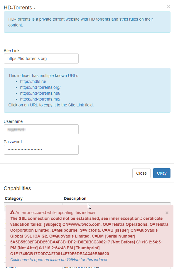

HI All,
I have an issue with Jackett, I just did a cache disk swap and restored my appdata and most docker containers are working as before, however Jackett I cannot add my indexer (hd-torrents.org)
I use Sonarr, Jackett, Transmission in my setup.
When I add HDT and enter my username password then click OK I get an SSL failure as seen in the attached capture.
I can see the certificate has expired butI find it confusing that this certificate error occurs, and where this failure is caused as it only seems to affect Jackett. I felt it might be my browser or something local to the PC I was using so tried other laptops and its the same error.
So, I'm pretty confused and am hoping someone can help me. I think I need to somehow renew the certificates on my Unraid server.
 Thank you in advance.
This is the log - https://pastebin.com/HpFjmmw5
HI All,
It might be Telstra blocking that website. I know Australia has cracked down on torrent sites. Have you tried connecting to hd-torrents via your browser?
Only solution is either to find another torrent site, or switch internet providers, or set up a vpn.
Thanks for this. Well yes I do connect to it via my browser pretty much daily, and especially now my automation is broken. It seems odd how it coincided directly to my backup/restore of app data. Currently I'm using a Chrome addon on my main PC to send torrents from HD-Torrents site to Transmission on Unraid.
Same command as shown in screenshot below from my PC on the same network is successful. SO I think its Unraid server issue?
Only other thing I can think of is the certificate in Jacketts app data is old or balked. See if you can flush the old one.
Yeah Im just trying to replapce the ca-cert.crt bundle in /usr/share/curl . That seems to be the path set when using the command to verify the SSL connection to the site, and the cert is clearly expired.
IN other words, Im winging it!
Thank you for your replies too.

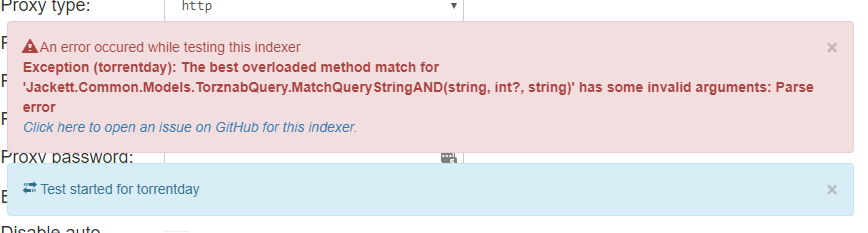

Help...
Problem with Jackett Version 0.14.299.0. (Linuxserver.io version:- v0.14.299-ls59 Build-date:- 2020-03-27T05:07:26-04:00)
An error occured while testing this indexer
Exception (torrentday): The best overloaded method match for 'Jackett.Common.Models.TorznabQuery.MatchQueryStringAND(string, int?, string)' has some invalid arguments: Parse error
9 hours ago, pepsidrinker916 said:
Help...
theres a problem with the current version of jackett, i used linuxserver/jackett:v0.14.275-ls58 and its working again
@twisteddemonHow do you change the version of the docker?  Im having the same issue.
Edited by Bigpawpaww
Is there an update to the docker coming.  There was an updatet to Jackett yesterday due to some issues impacting AvistaZ, PrivateHD and CinemaZ indexers.
See here https://github.com/Jackett/Jackett/issues/8727
AvistaZ, PrivateHD and CinemaZ are fixed in Jackett v0.16.526
You have to configure the indexers in Jackett again because the PID is now required. Read the notes in the configuration!!!
Edit: looks like I may have been asking the same question as above.
Edited by DigitalDivide
The issue has been resolved.  Updated the docker and got it working once I added the PID.  They did make a change to Jackett where you have to go into the config and now add in the PID from AvistaZ, PrivateHD and CinemaZ
